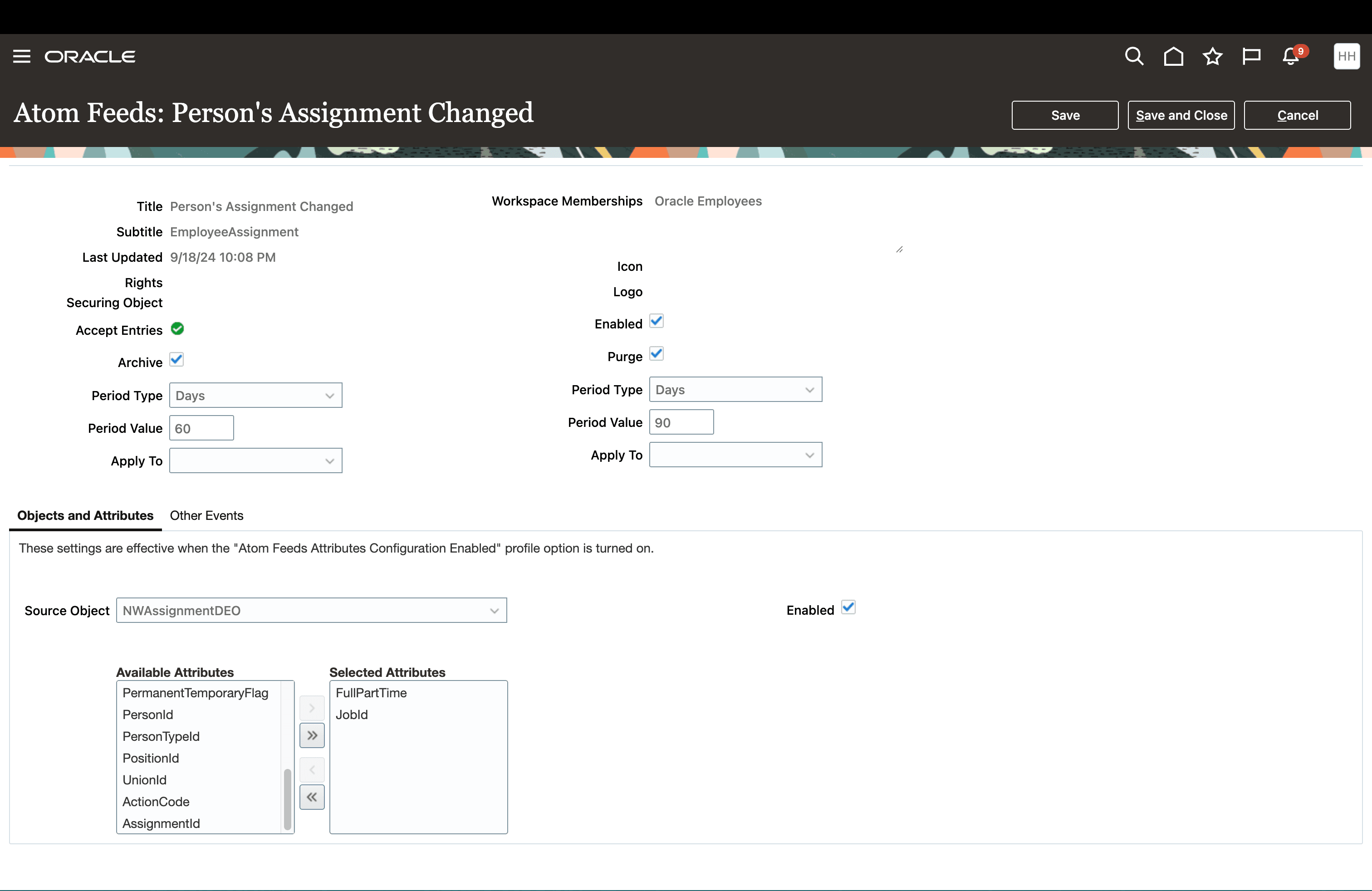

  1. Go to the Manage HCM Atom Feeds task in the Setup and Maintenance work area.
  2. Open the Person's Assignment Changed feed configuration.
  3. In the Objects and Attributes section, search for and select the NWAssignmentDEO source object.
  4. Select the Enabled check box.
  5. Choose which attributes should trigger events and be present in the Changed Attributes section of an Atom feed entry.
  6. Click Save and Close to save your changes.
empassignment feed configuration screen
