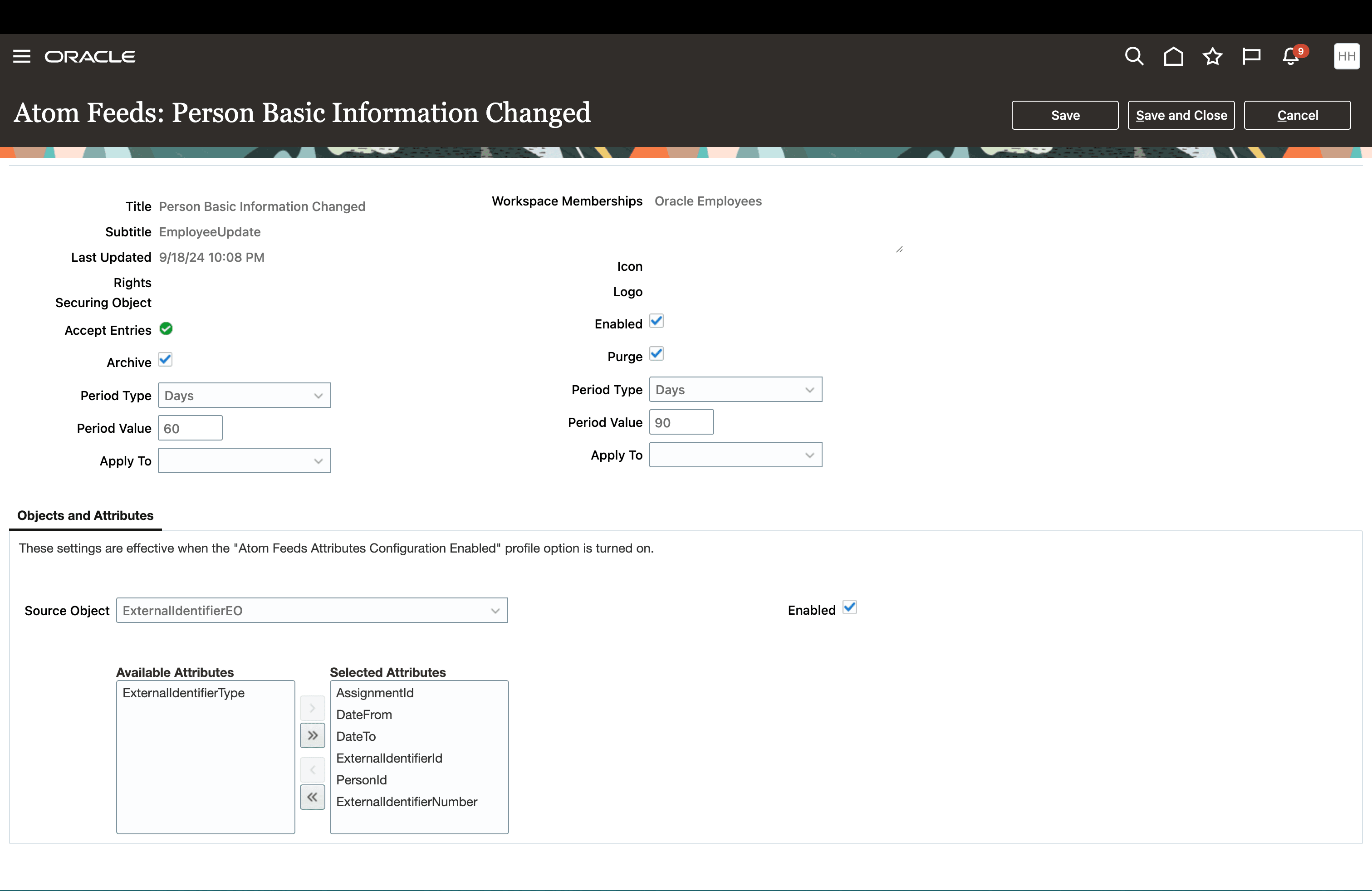

  1. Go to the Manage HCM Atom Feeds task in the Setup and Maintenance work area.
  2. Open the Person Basic Information Changed feed configuration.
  3. In the Objects and Attributes section, search for and select the ExternalIdentifierEO source object.
  4. Select the Enabled checkbox.
  5. Choose which attributes should trigger events and be present in the Changed Attributes section of an Atom feed entry.
  6. Click Save and Close to save your changes.
empupdate feed configuration screen
