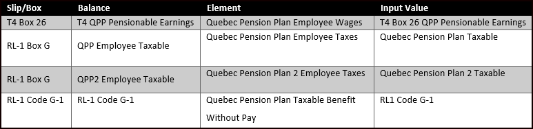

Balance Adjustments
If manual adjustments are required to the T4 Box 26 balance (T4 QPP Pensionable Earnings) or the RL-1 Box G or Code G-1 balances (QPP Employee Taxable and QPP2 Employee Taxable), use the following based on your requirements.
Balance Adjustment Details
Note the following tips and considerations for balance adjustments:
  • You must adjust each balance separately. Related balances are not automatically adjusted.
  • The T4 Box 26 balance (T4 QPP Pensionable Earnings) equals the sum of the following balances:
    • QPP Employee Taxable
    • QPP2 Employee Taxable
    • Taxable Benefits in Kind
  • If taxable benefits in kind have not been processed, and if the T4 QPP Pensionable Earnings balance does not equal the sum of the QPP Employee Taxable and QPP2 Employee Taxable balances, you must adjust the Box 26 balance (T4 QPP Pensionable Earnings).
  • If either the QPP Employee Taxable or QPP2 Employee Taxable balances are adjusted, you must also adjust the T4 QPP Pensionable Earnings balance with a similar value.
