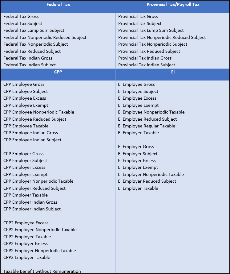

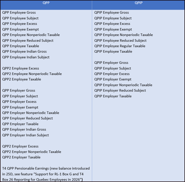

Balances Impacted by Negative Earnings
The following balances are impacted by this feature:
 Balances Impacted
Balances Impacted
Balances Impacted
Balances Impacted
