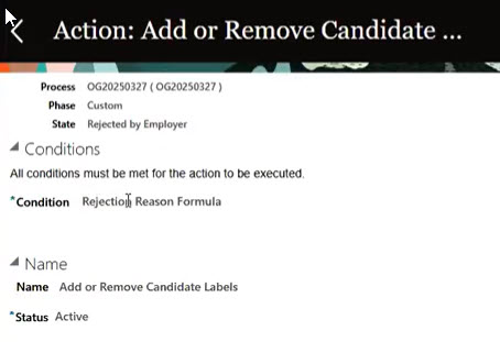

After the fast formula is created, you can add an action to the Rejected by Employer or Withdrawn by Candidate state of a candidate selection process, and use the fast formula you created as a condition. The REASON_CODE context is only available for fast formulas used on automated actions for the Rejected by Employer and Withdrawn by Candidate states. It returns the code of the reason selected when rejecting or withdrawing the job application.
Using Fast Formula as Condition
Fast Formula Used as Condition
