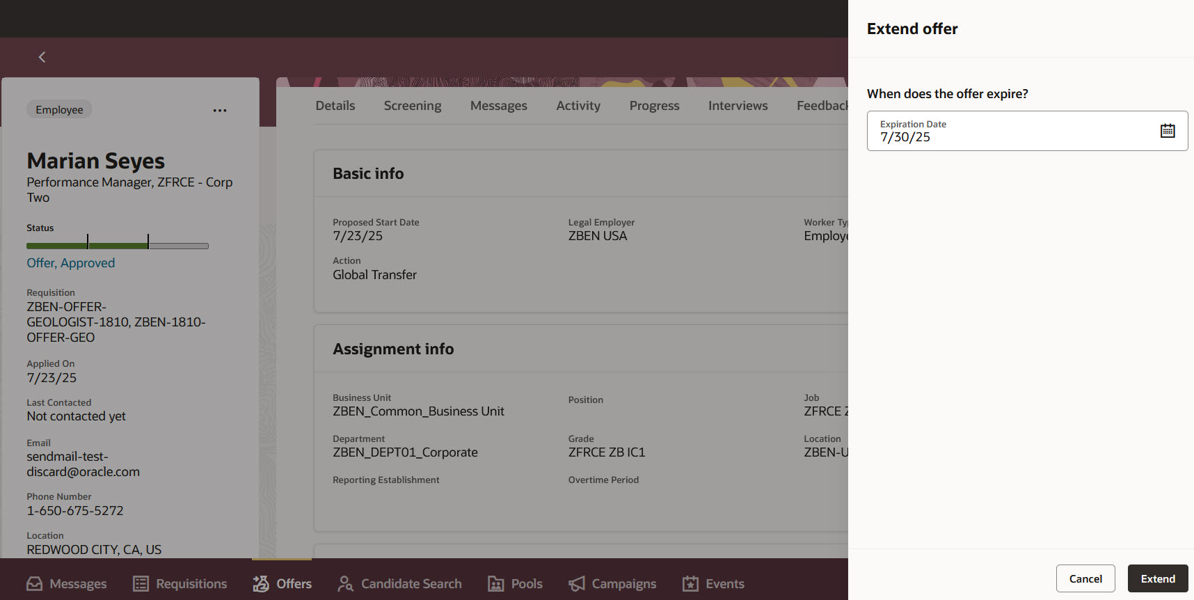

The following changes were made to the expiration date functionality while extending job offers in Redwood.
  • The expiration date is optional. You can leave the field blank.
  • A new profile option is available: ORA_IRC_OFFER_EXPIRATION_DAYS. By default, the profile option value is set to 7, which means that the expiration date will be populated with “system date + 7 days”. You can change the value based on your business process. You can also leave it blank if you don’t want to default any date in the expiration date field.
  • You can change the format of the expiration date and you can the date format based on user preferences.
Extend Offer and Expiration Date
This feature provides flexibility in keeping or changing the default value of the expiration date while extending job offers. You also have the ability to leave the expiration date field empty if it’s not required on the job offer letter or job offer notifications.
