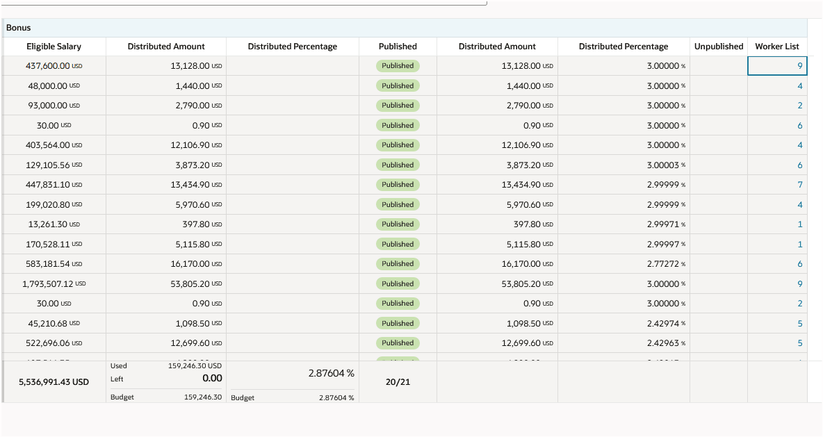

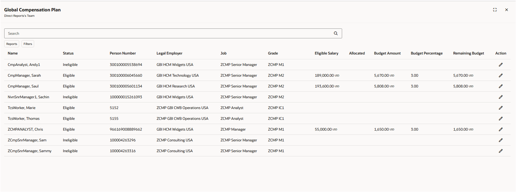

Enrich the manager experience with the updated Redwood experience for worker-level budgets in the budget sheet. In the new budget sheet, if worker-level budgets have been configured, managers can review the budget amounts calculated for each person. To access the worker list, navigate to the Worker List column and select a manager's value of reports.

Once a manager's reports value is selected, the list of reports and their values can be seen.
Worker Budget Amount Values
If allowed in plan setup, they may update the values.
