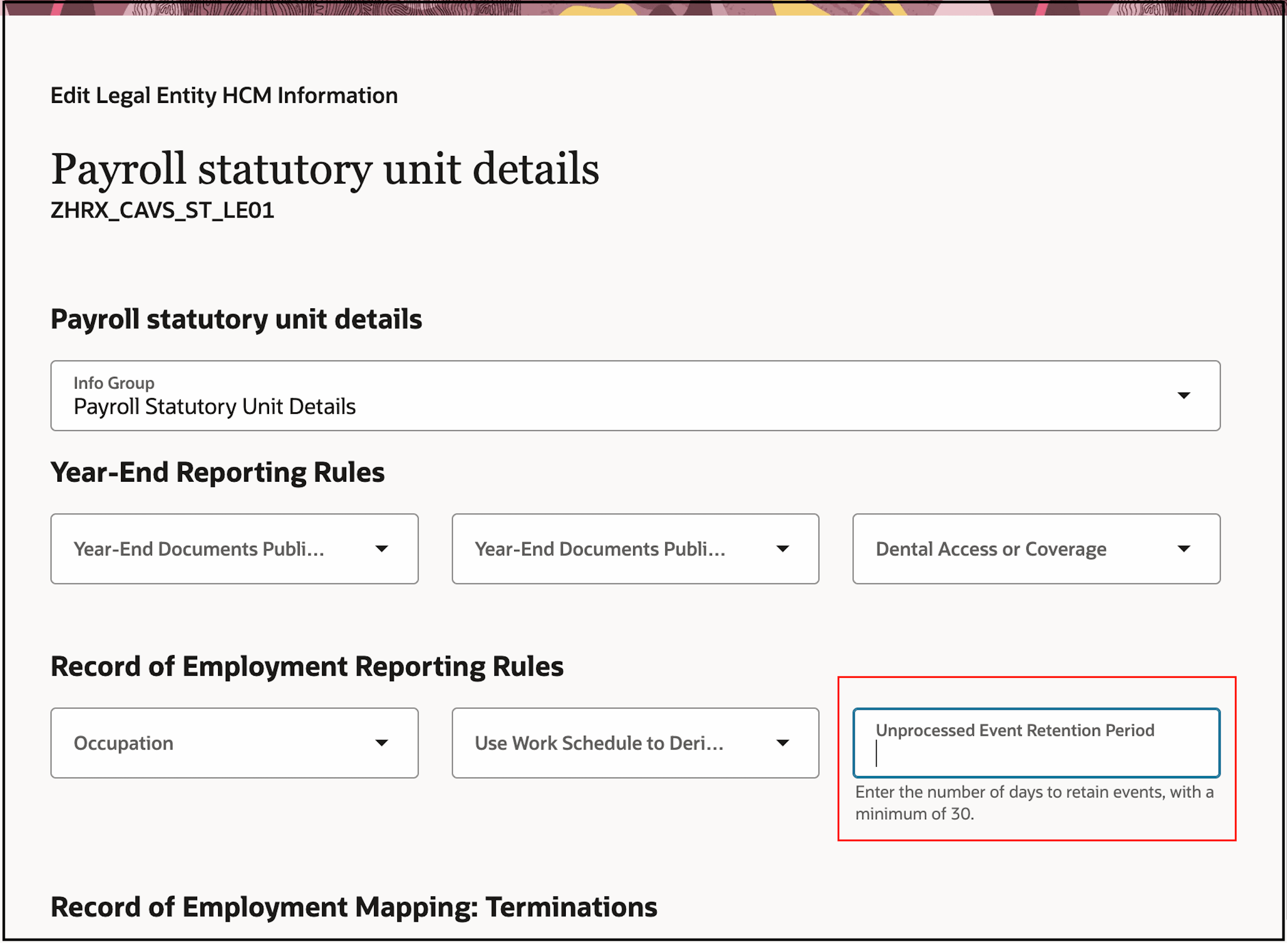

With this update, we have introduced a new field on Legal Entity HCM Information -> Payroll statutory unit details page called “Unprocessed Event Retention Period”. This field specifies the number of days to retain unprocessed ROE notification events, which include events in "Deferred" and "Awaiting Processing" statuses.

This image illustrates the Legal Entity HCM Information -> Payroll statutory unit details page showing the new “Unprocessed Event Retention Period” field.
Record of Employment Reporting Rules: Unprocessed Event Retention Period field
This update enables the configuration of a retention period for unprocessed ROE notification events, allowing events older than the specified period to be purged from the system. This is particularly beneficial for large organizations that may have accumulated a high volume of unprocessed events over time.
