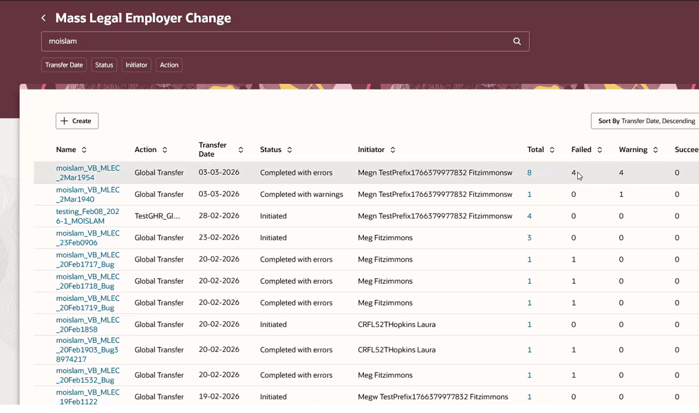

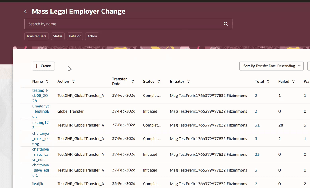

Mass Legal Employer Change dashboard showing existing processes and the Create action

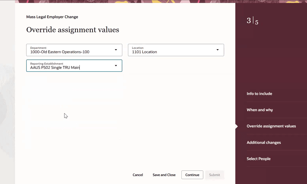

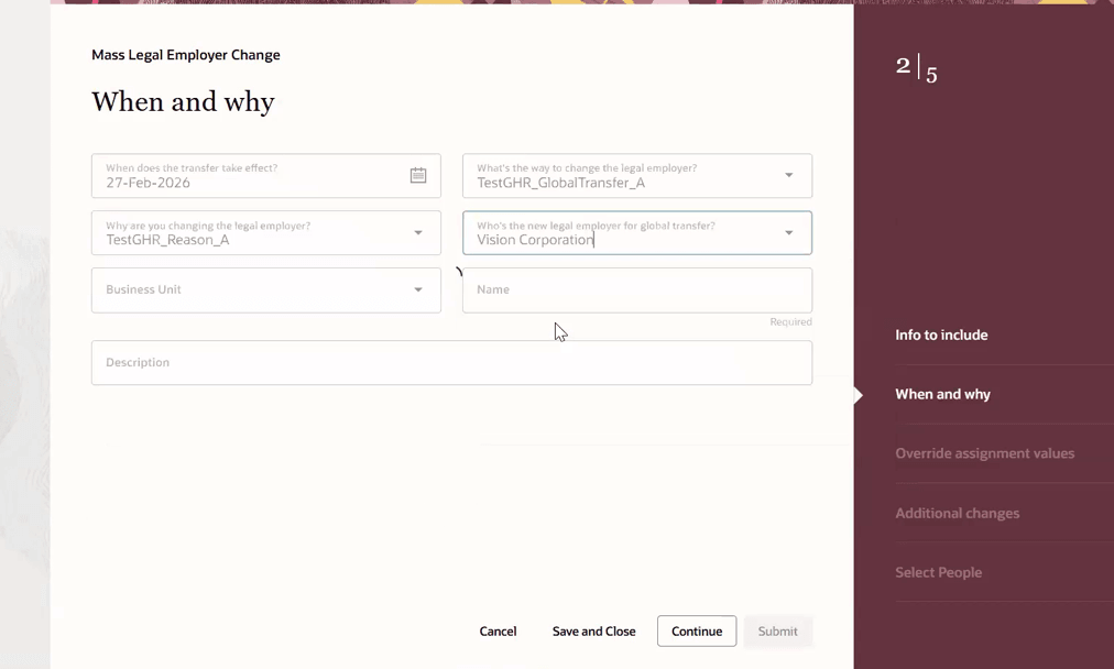

When and why step for entering transfer date, legal employer change type, new legal employer, reason, and process details
Override assignment values step for entering assignment values such as department, location, and reporting establishment

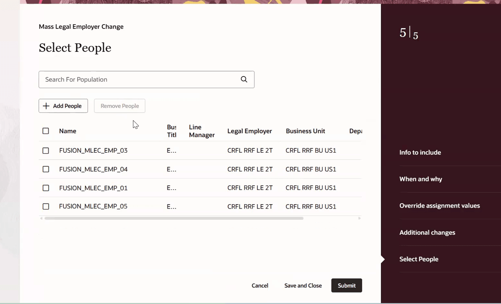

Select People step used to add workers to the Mass Legal Employer Change process
Dashboard showing completed processes with errors that can be reviewed or rerun

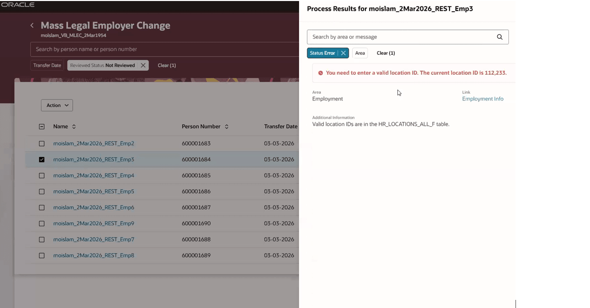

Worker error details available for a process completed with errors

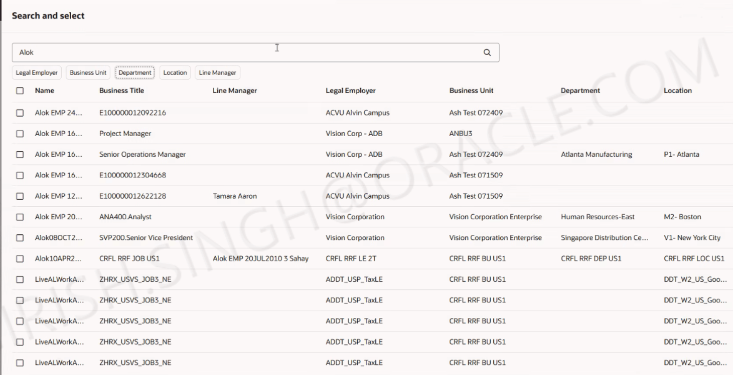

In Redwood Mass Legal Employer Change, users can search for a target population using Name, Email, Business Title, or Person Number. After the initial search results are returned, users can further refine the population by applying filters such as Legal Employer, Business Unit, Department, Location, and Line Manager.
We also plan to enhance this search experience in upcoming releases by adding more filter options and improving the overall search capability.
Search filters to search for people
