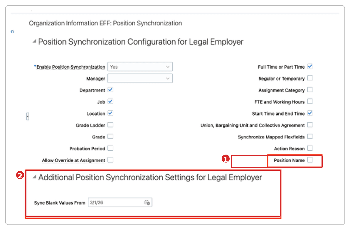

Position Synchronization Configuration for Legal Employer showing the available synchronization attributes

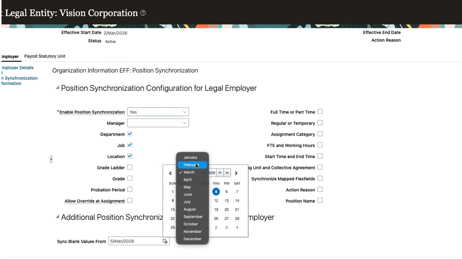

aaSync Blank Values From setting used to define when blank position values can begin synchronizing

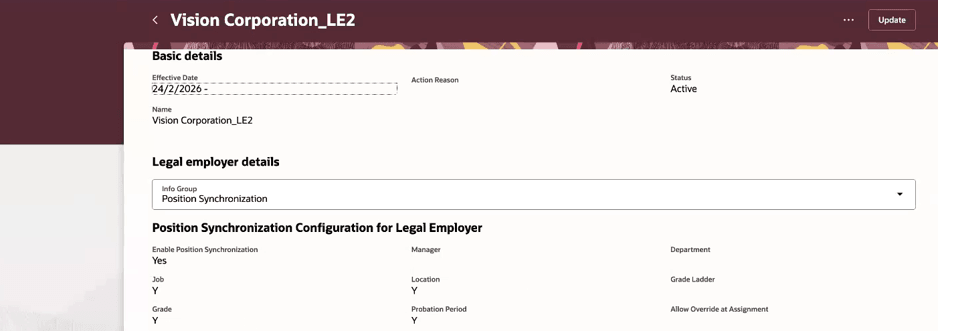

Legal employer details with Position Synchronization selected and configured attributes visible

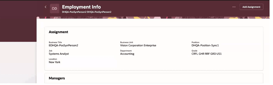

Employment Info page showing assignment details after position synchronization.

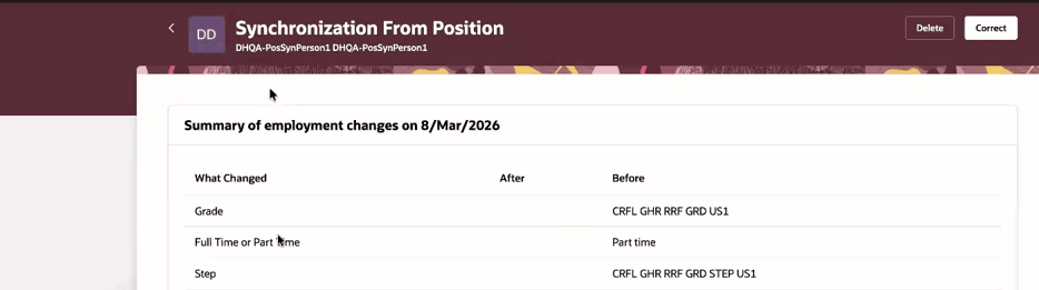

Summary of employment changes generated by position synchronization
