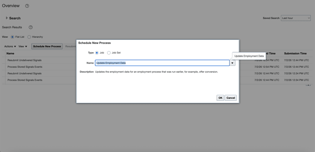

The scheduled process uses standard Enterprise Scheduler Service (ESS) capabilities, allowing you to run it on demand or according to a recurring schedule.

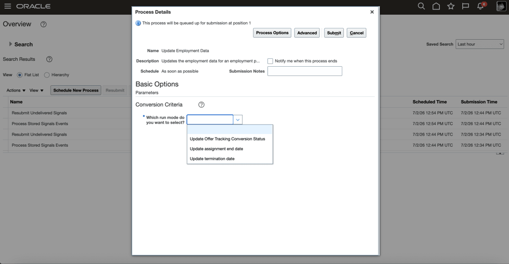

Use the Update Employment Data scheduled process and select either the Update Termination Date or Update Assignment End Date process based on your requirement.

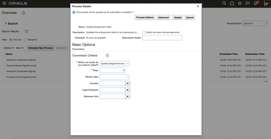

  • Business Unit (applicable for Update Assignment End Date only)
Business Unit of the worker.

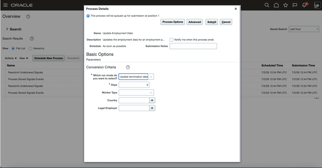

Update employment data
Update employment data ESS process
Update employment data for end assignment
Update employment data for terminating work relationship
