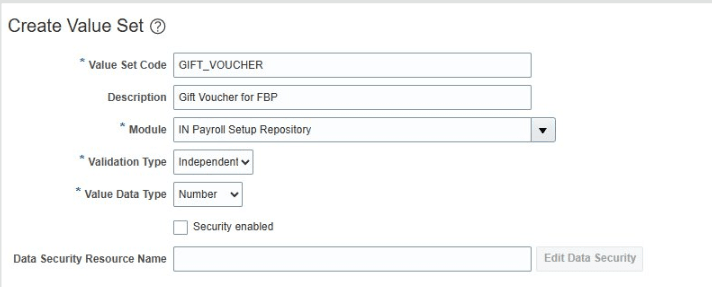

Lookup Values for Component Choice
Using the Manage Values Task in Setup and Maintenance, create individual value sets that accept only numeric values for the components.
Create Value Set
Create Value Set

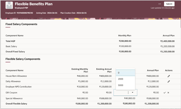

When the employee views their Flexible Benefit Plan in ESS, they can select the component value from the LOV.
Flexible Benefits Plan ESS View - Component Choise
Flexible Benefits Plan ESS View - Component Choice

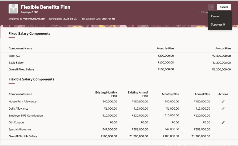

Hide 0 Value Components:
You can now hide the 0 value components from the FBP Plan in the self-service view using the Suppress option.
Suppress Zero Value Components in ESS View

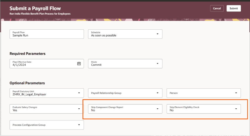

Suppress Warning Message for Element Eligibility Check and Component Value Change:
You can now suppress the display of warning messages generated for element eligibility check and component value change in the FBP Process flow. Configure the parameters in the Payroll Flow Patterns and also check if they are disabled when you run the flow Run India Flexible Benefit Process for Employees.
Suppress Warning Messages in Flow Report
