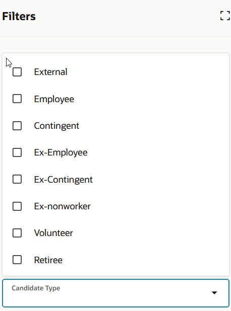

Filters with Additional Person Types

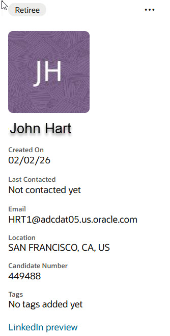

Retiree Person Type Considered a External Candidate

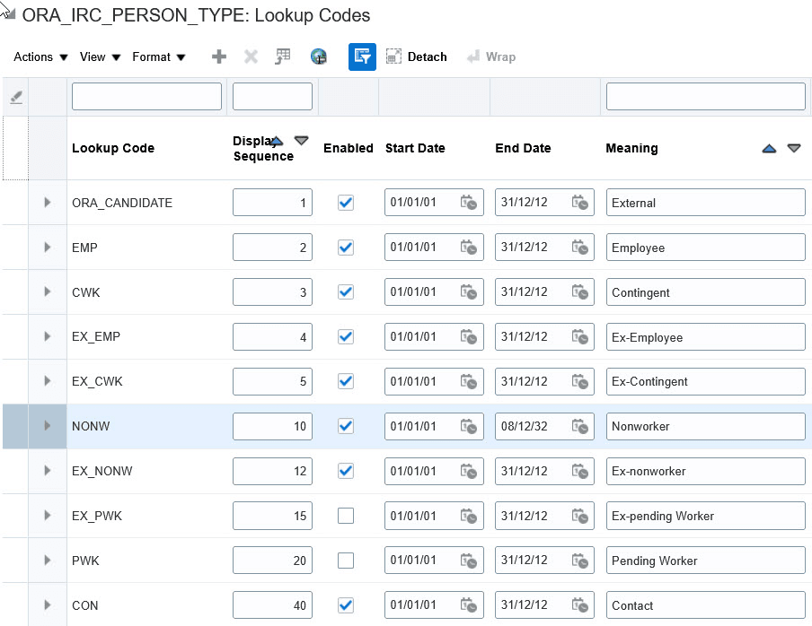

Step 1: Set up the ORA_IRC_PERSON_TYPE LOOKUP lookup
These person types are supported and enabled by default in Recruiting:
  • ORA_CANDIDATE
  • EMP
  • CWK
  • EX_EMP
  • EX_CWK
Note: You can’t disable nor change the sequence of standard person types used in Recruiting.
All person types supported in GHR have been added as lookup codes. These person types are considered as external candidates in Recruiting. You can enable the person types you want. For details, see How do I enable person types in Recruiting?
Additional Person Types in the Lookup
