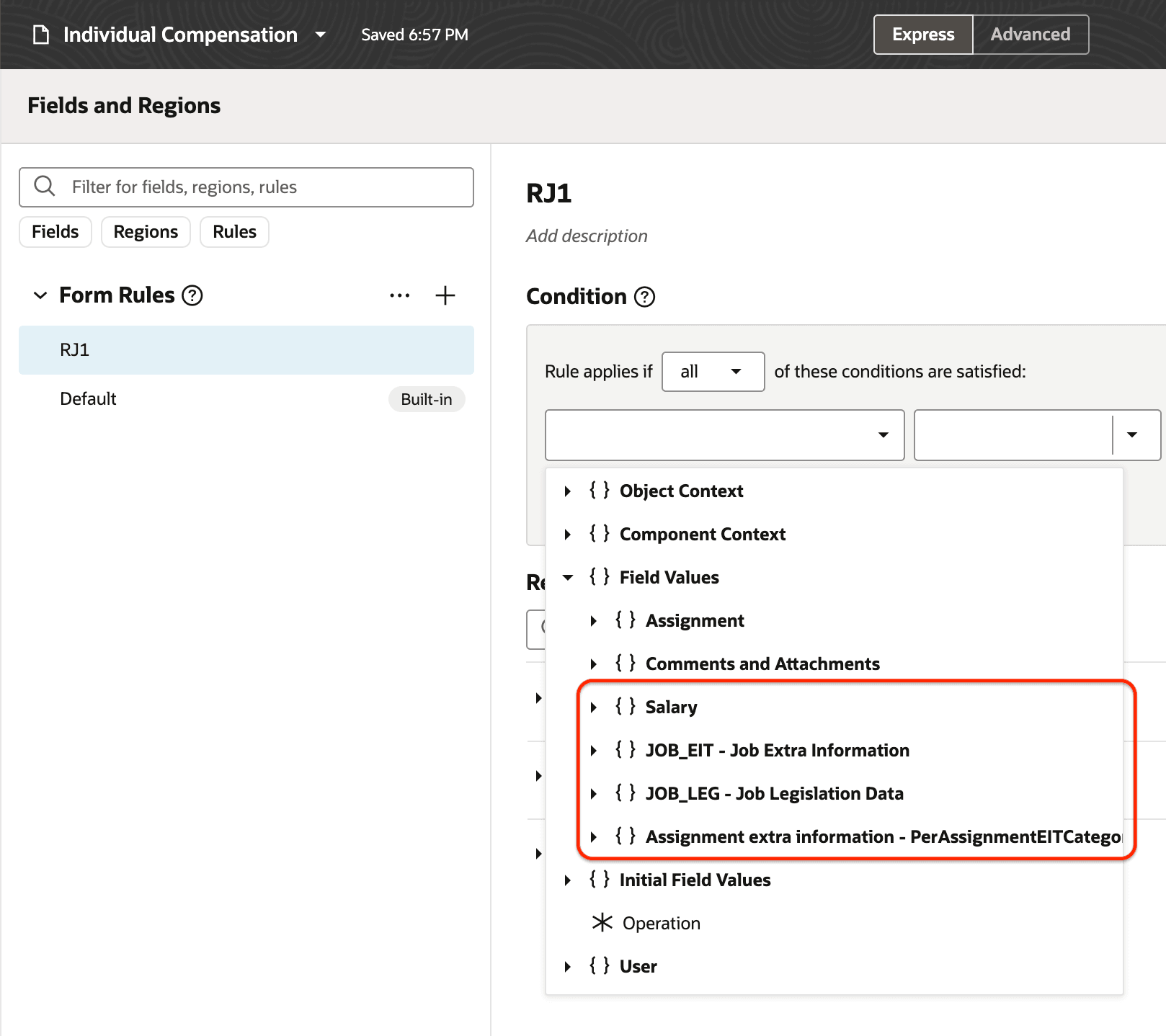

You can now define defaulting and validation business rules using Salary, Work Structures DFF, Job EFF, and Assignment EFF attributes.
Define Defaulting and Validations using Salary, Job, and Assignment EFF

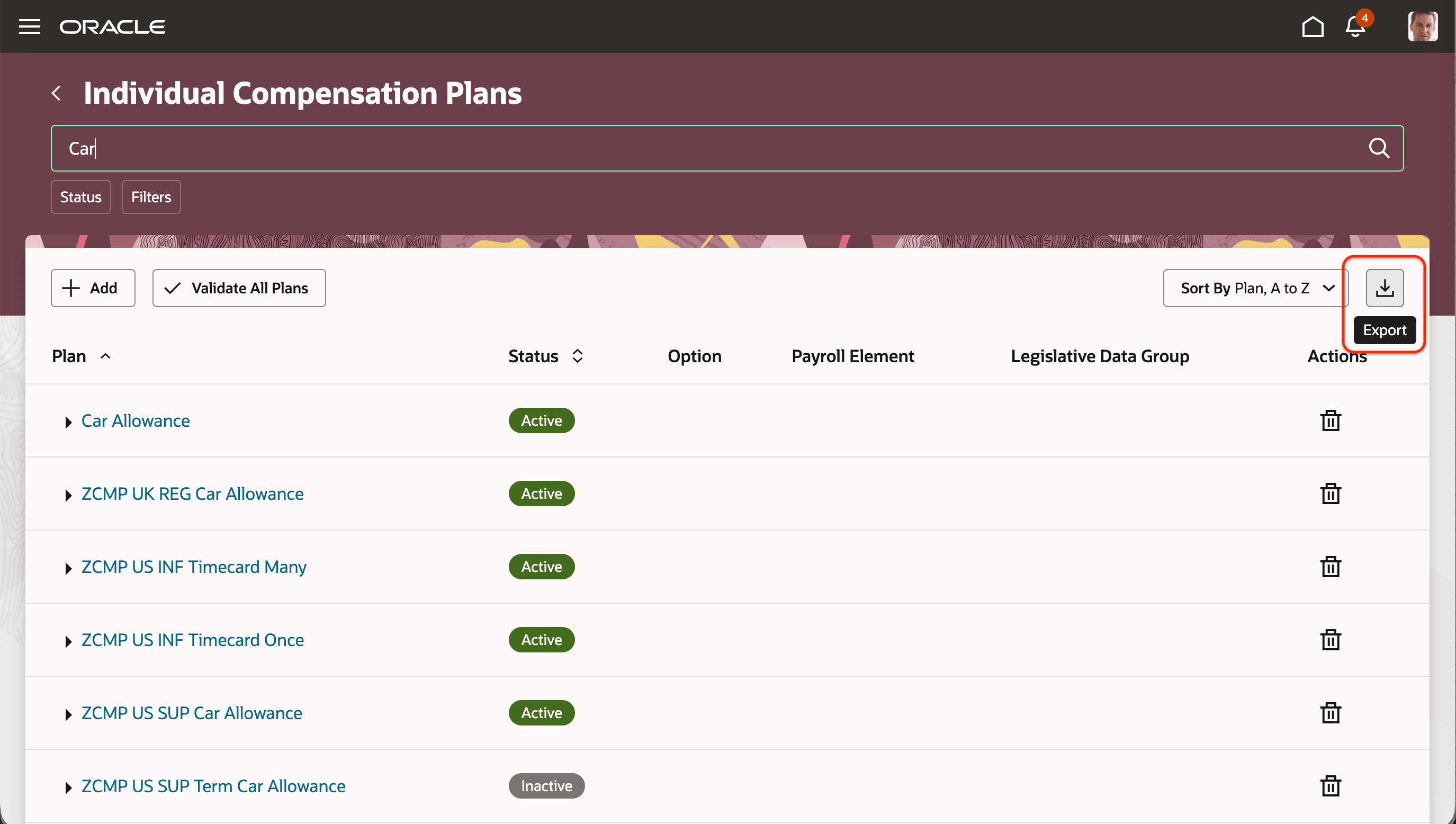

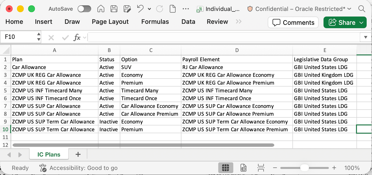

You can also export data from the Redwood Individual Compensation Plans page.
Export Ability in Redwood Individual Compensation Plan
Filtered Data Exported
You continue your journey into Oracle Redwood solutions. Configure more targeted defaulting and validation rules by using salary, job, assignment, and work-structure attributes.
Steps to enable and configure
Tips and considerations
- For salary, assignment, or job EFF-based defaulting and validation to work, users must have read-only access to the relevant data through appropriate security privileges. For example, if Matt is a line manager and his organization has a defaulting rule that uses assignment EFF to default an input value, Matt’s security must provide read access to assignment EFF for the defaulting to work when he performs a personal contribution.
When retrieving these details, the effective date is used. If the effective date is not available, the current date is used.
