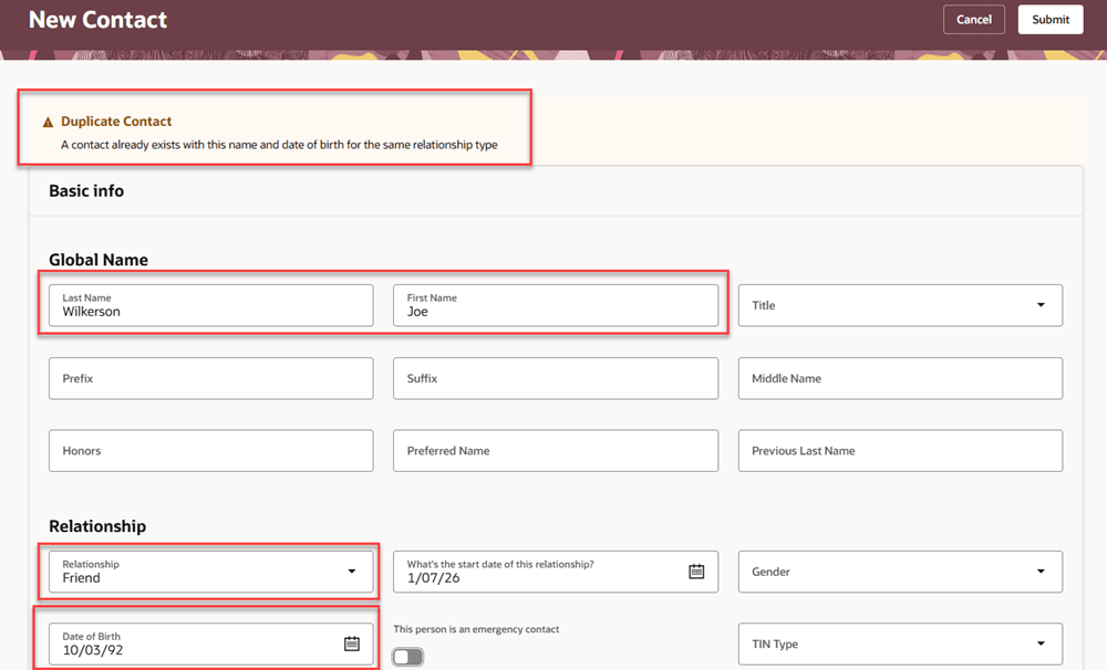

In the following example, we've created a rule that displays a warning message if the user creates a new contact with the same name, date of birth, and relationship type as an existing contact.
Warning message displayed when a new contact matches an existing contact based on name, relationship type, and date of birth

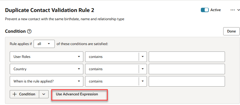

  4. Edit the validation condition.
  5. Select Use Advanced Expression.
VB Studio Validation Rule showing Link to Define Advanced Expression
VB Studio validation rule showing link to Define Advanced Expression

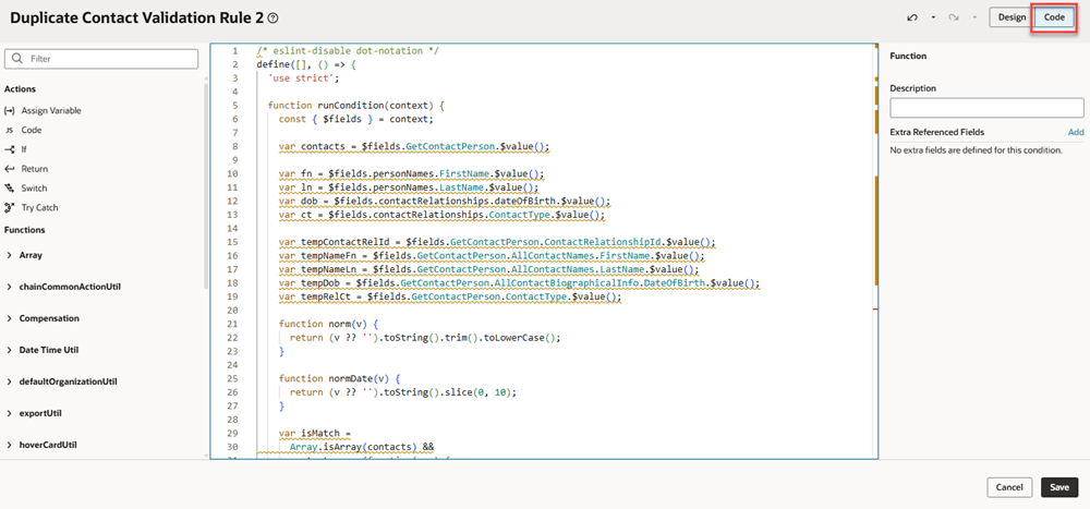

  1. Write your validation rule. You can paste in sample rules on the Code tab to get started. See the Tips and Considerations section for a sample rule and some guidelines.
    VB Studio Validate Rule Showing Code for the Rule
    VB Studio validation rule showing the code for the rule

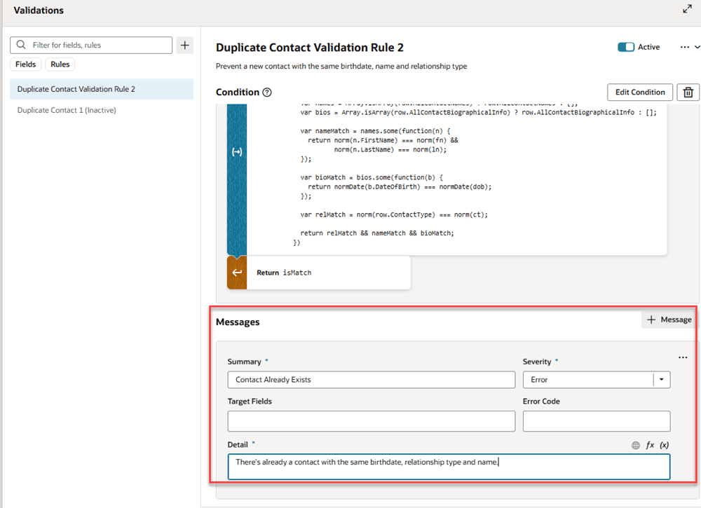

  1. In the Messages section below the condition, enter the warning or error message to be displayed when the rule criteria are met.
    VB Studio Validation Rule Showing Error Message Definition
    VB Studio validation rule showing error message definition

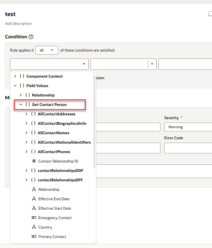

  • To see the specific attributes you can use, create a dummy business rule and inspect the field values available for creating a rule, as shown in the following image
    • The relevant grouping is Get Contact Person
    • Additional available attributes are shown under AllContactAddresses, AllContactBiographicalInfo, AllContactNames, AllContactNationalIdentifiers, and AllContactPhones
VB Studio Condition Builder showing Available Objects and attributes for GetContactPerson
VB Studio Condition Builder showing available attributes for Get Contact Person

Sample rule
Here's a sample rule that checks for an existing contact with the same first name, last name, birthdate, and relationship type:
/* eslint-disable dot-notation */
define([], () => {
  'use strict';
  function runCondition(context) {
    const { $fields } = context;
    var contacts = $fields.GetContactPerson.$value();
    var fn = $fields.personNames.FirstName.$value();
    var ln = $fields.personNames.LastName.$value();
    var dob = $fields.contactRelationships.dateOfBirth.$value();
    var ct = $fields.contactRelationships.ContactType.$value();
    var tempContactRelId = $fields.GetContactPerson.ContactRelationshipId.$value();
    var tempNameFn = $fields.GetContactPerson.AllContactNames.FirstName.$value();
    var tempNameLn = $fields.GetContactPerson.AllContactNames.LastName.$value();
    var tempDob = $fields.GetContactPerson.AllContactBiographicalInfo.DateOfBirth.$value();
    var tempRelCt = $fields.GetContactPerson.ContactType.$value();
    function norm(v) {
      return (v ?? '').toString().trim().toLowerCase();
    function normDate(v) {
      return (v ?? '').toString().slice(0, 10);
    var isMatch = Array.isArray(contacts) && contacts.some(function(row) {
      if (Number(row.ContactRelationshipId) < 0) {
        return false;
      var names = Array.isArray(row.AllContactNames) ? row.AllContactNames : [];
      var bios = Array.isArray(row.AllContactBiographicalInfo) ? row.AllContactBiographicalInfo : [];
      var nameMatch = names.some(function(n) {
        return norm(n.FirstName) === norm(fn) &&
          norm(n.LastName) === norm(ln);
      var bioMatch = bios.some(function(b) {
        return normDate(b.DateOfBirth) === normDate(dob);
      var relMatch = norm(row.ContactType) === norm(ct);
      return relMatch && nameMatch && bioMatch;
    return isMatch;
  return { runCondition };
