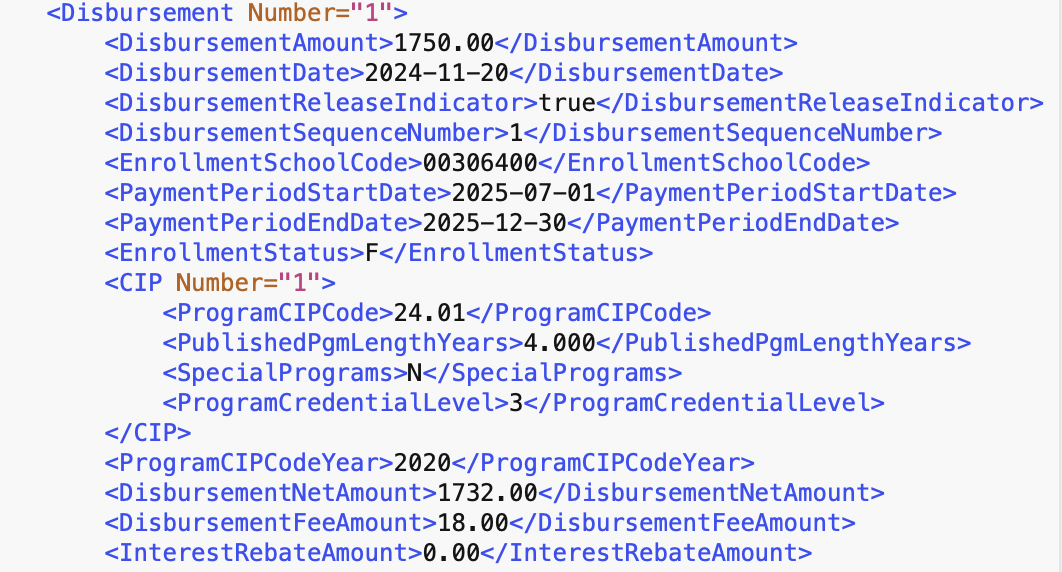

      • A new CIP type will contain the Program CIP Code tag and the corresponding program length/credential levels that are required per disbursement. The CIP tag will allow for a maximum of 3 occurrences per disbursement. Only one occurrence of CIP and corresponding  program length/credential levels will be required per disbursement, similar to how the Address line fields are defined.
      • Added new CIP Tag and Type (File Line 761) for the 25/26 Award Year and forward
        • <xsd:element name="CIP" type="cod:CIPType" minOccurs="0"maxOccurs="3"/>
      • The new CIP Type Tag will enclose the following existing tags ((File Line 776-849) <xsd:complexType name="CIPType">)

          <xsd:attribute name="Number" use="required">
      • The new CIP Type Tag is per disbursement within the <Disbursement> block. The tag will be =  <CIP Number="1">.
        •  For example:
        • 2025-26 COD new CIP Type Tag Example
