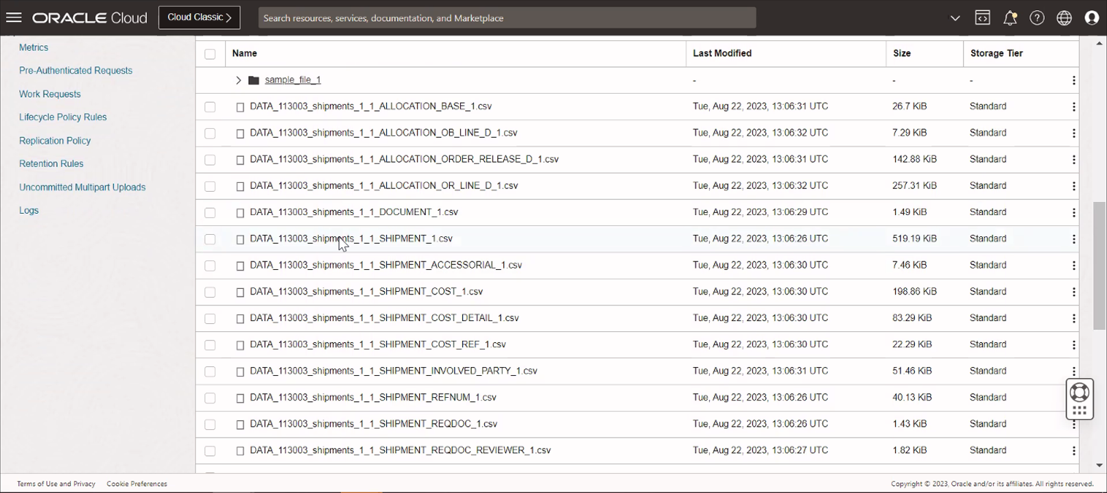

In the example below, the Data Export API has been run on an object basis, in this case, a shipment object, note that the parent object and the related child objects are provided.
Shipment Object Data Export API Example

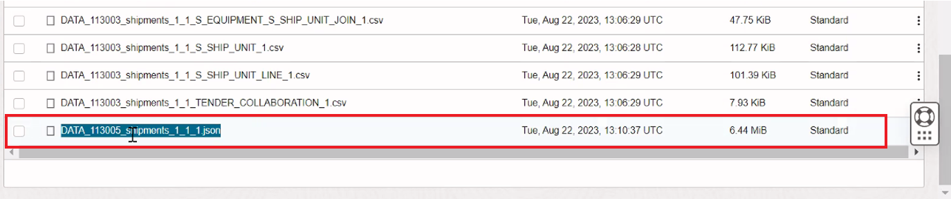

Export Data to a Single JSON File
In the example below, the same shipment object exported above was exported, but in this case the JSON file format was selected. The extract in this scenario provides a single file in a JSON file format.
JSON File Format Export - Single File

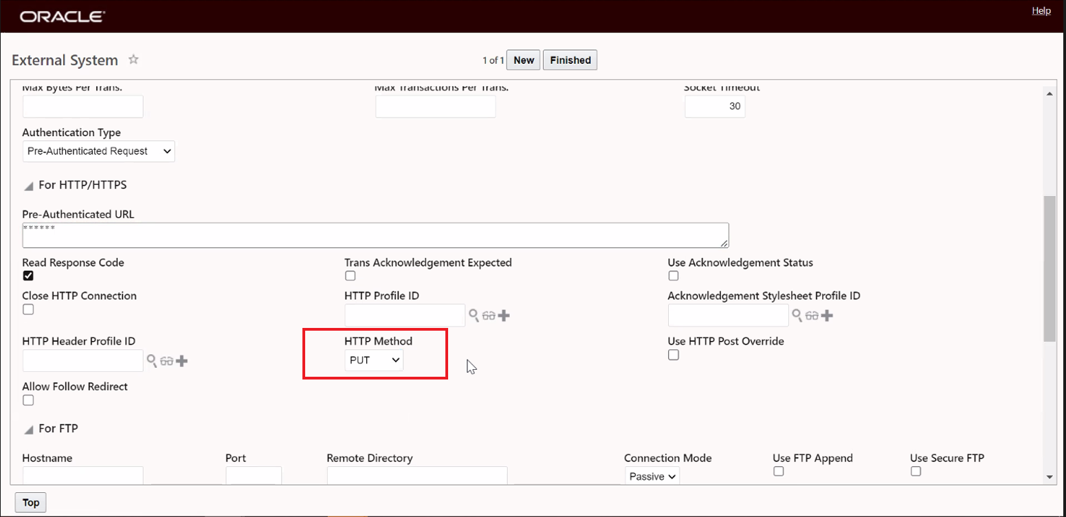

External System the HTTP Method Includes the PUT Method
In the image below the new option for the External System HTTP Method of PUT is highlighted. Previously, the httpMethod PUT had to include in the request itself, with the addition of the HTTP Method of PUT in the drop down, you only need to specify the PUT HTTP Method on the External System setup.
External System - HTTP Method PUT Added
