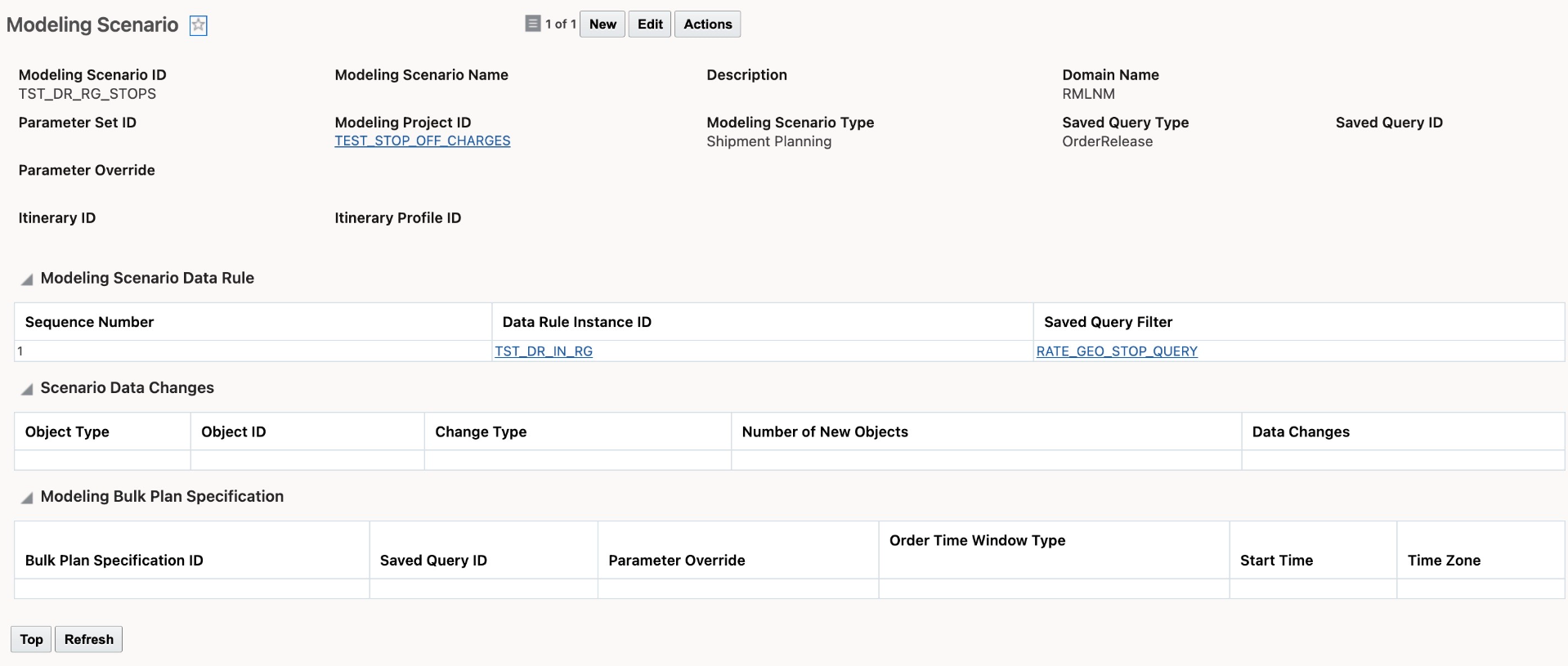

Below are the Modeling Scenario and the Data Rule created on the Rate Record.

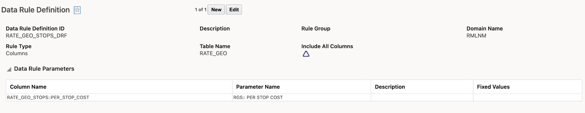

Data Rule Definition

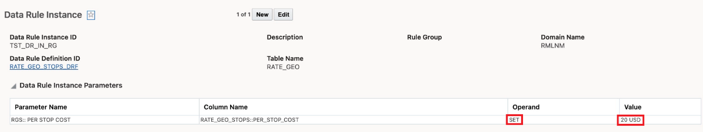

In the below Data Rule Instance, the Per Stop Cost has been modified to 20 USD via the data rule using the Set operand. Other supported operands are Increase, Decrease, Increase by Percent and Decrease by Percent (operand functionality same as that of other data rules)

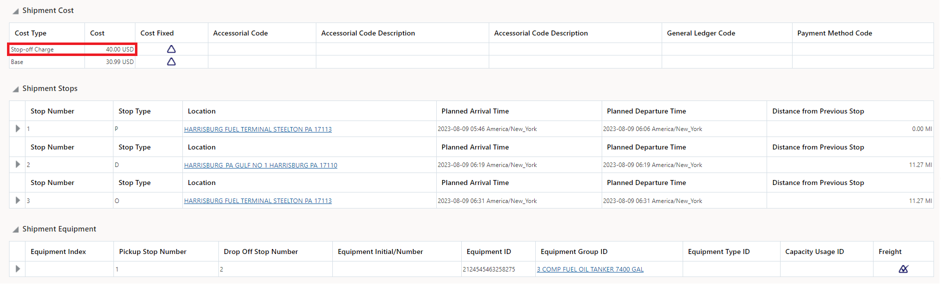

When a scenario bulk plan is run without any data rules, stop-off charges for the shipment is 20 USD (this shipment has 2 chargeable stops (No charge for pickup stop as Stops Included in Rate = 1) and the per stop cost as defined on the Rate Record is 10 USD, so the total stop-off charge is 20 USD)

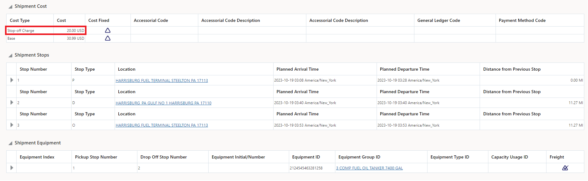

When a scenario bulk plan is run with the data rule, stop-off charges for shipment is 40 USD (this shipment has 2 chargeable stops (No charge for pickup stop as Stops Included in Rate = 1) and the per stop cost was set to 20 USD via the data rule, so the total stop-off charge is 40 USD)
