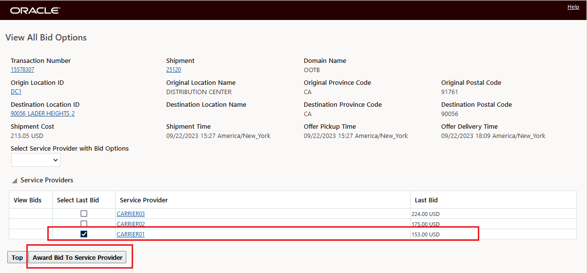

In the example below, a shipment has been Spot Bid Tendered to a set of service providers.  The lowest bid service provider CARRIER01 is awarded the shipment - as shown below.
Lowest Bid Wins Spot Bid Tender

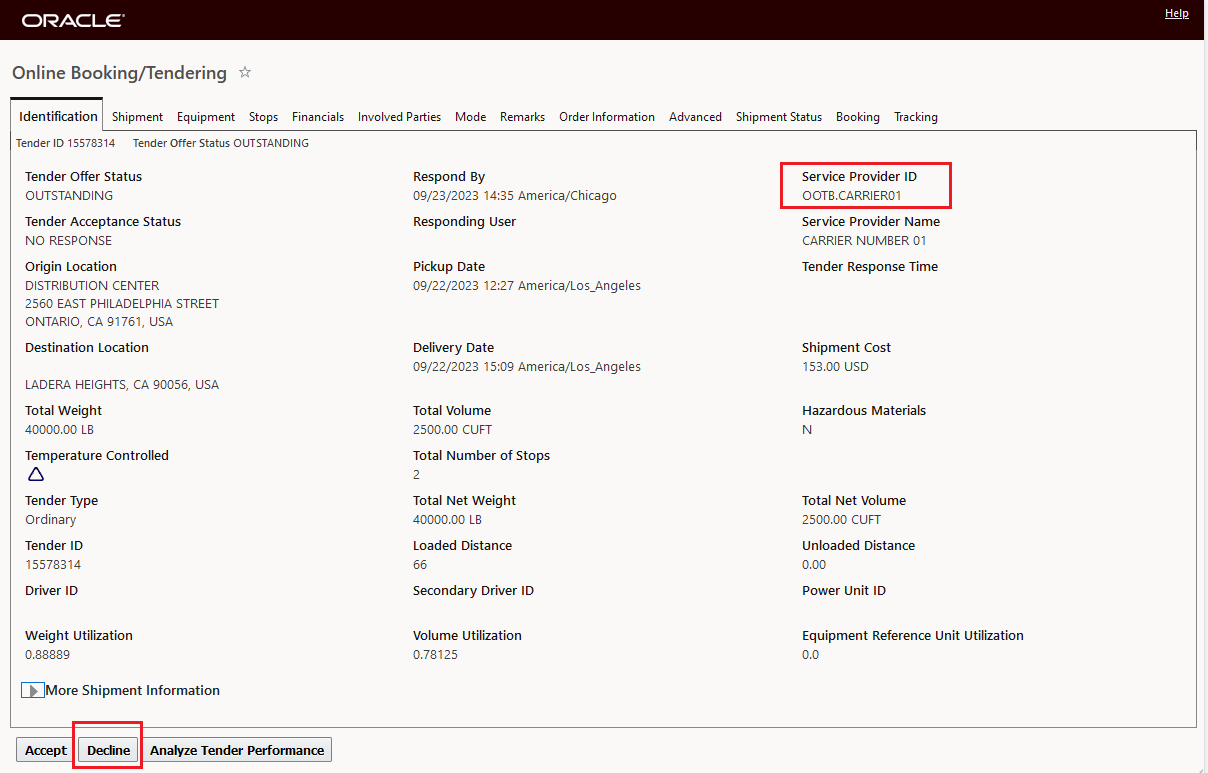

The winning service provider, CARRIER01, then Declines the Ordinary Tender as shown below.
Decline Ordinary Tender

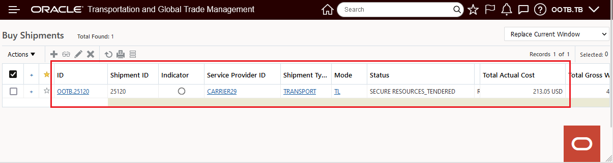

With the property - glog.tender.spotbid.avoidRetenderOnAcceptedSpotBidTender set to false - the default value for this property - the waterfall tender continues to process - in this case the shipment is tendered to CARRIER29, the lowest cost carrier with a contract rate on the lane.
Waterfall Tender After Decline Property = false - Previous Behavior

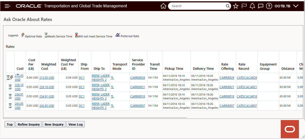

The first service provider tendered to is more expensive, the cost for the shipment only goes up from there as the waterfall tender process continues.
Other Contract Rate Service Provider Options

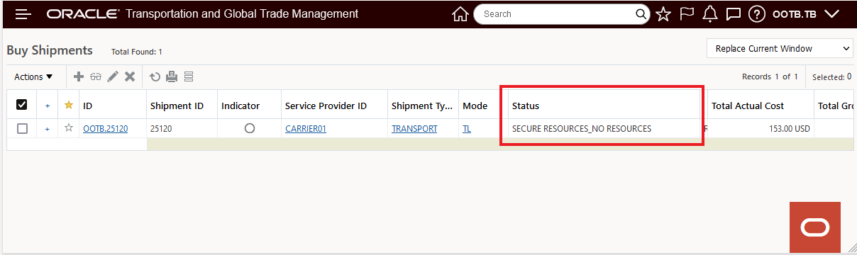

With the property - glog.tender.spotbid.avoidRetenderOnAcceptedSpotBidTender set to true- the new behavior, there is no waterfall tendering.  Now when the winning carrier declines the ordinary tender, the shipment is not retendered and the status type SECURE RESOURCES will have the value of SECURE RESOURCES_NO RESOURCES as shown below.
Waterfall Tender Stopped on Decline With Property = true - New Behavior

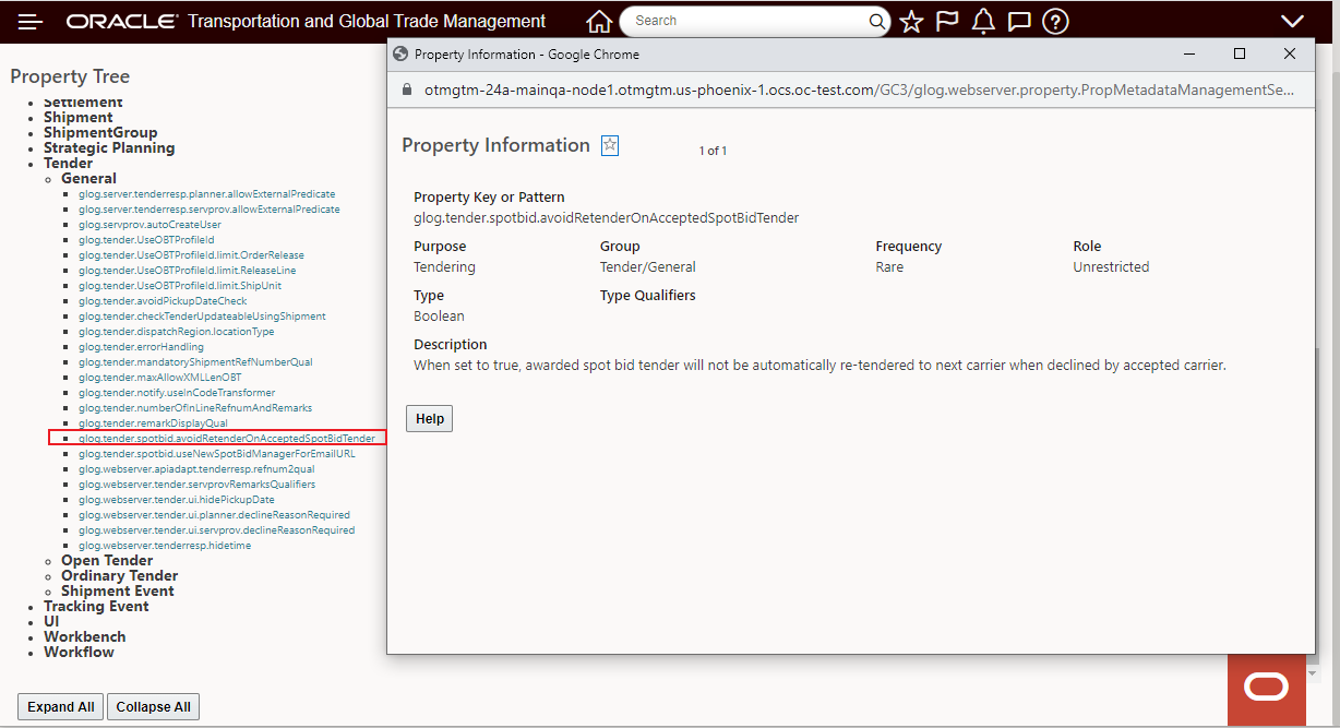

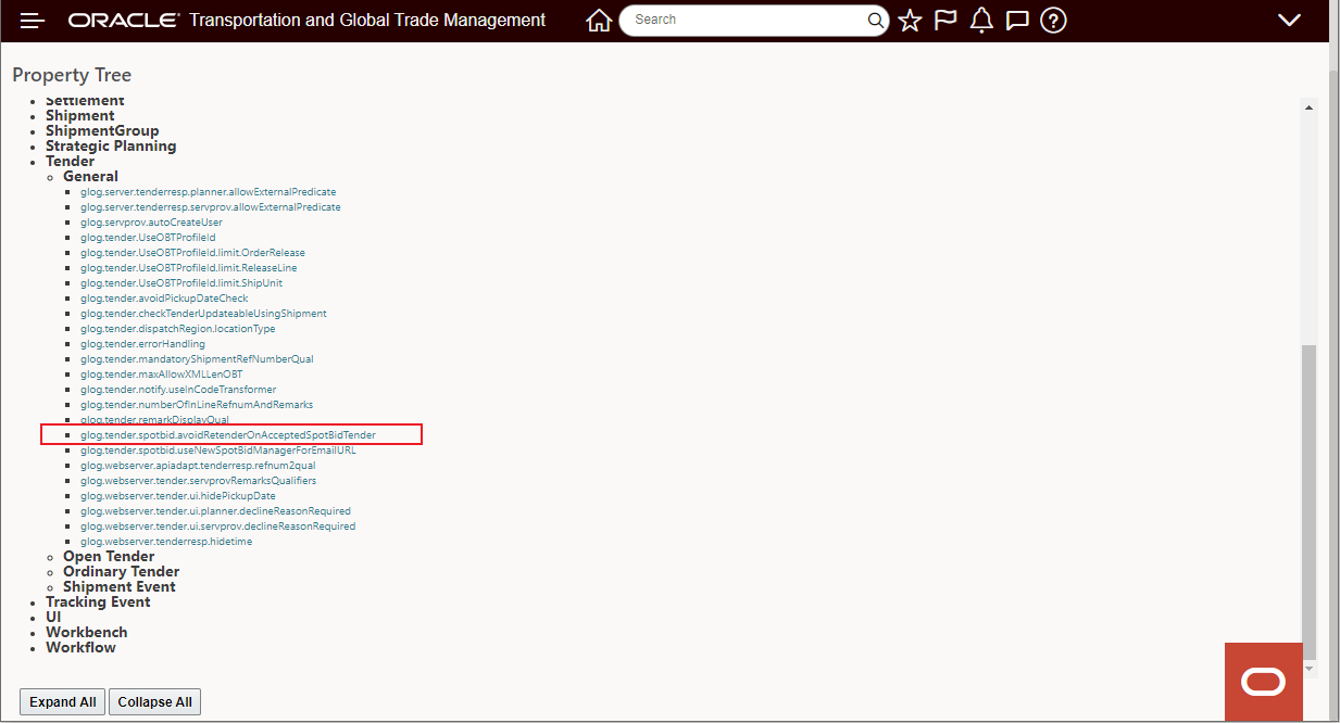

Property Tree Info
Property Tree Info
Property Information

To take advantage of the new workflow - you will need to set the set the property - glog.tender.spotbid.avoidRetenderOnAcceptedSpotBidTender - to true.  Setting the property to true will - in the case where the winning spot bid service provider declines the normal tender, will stop the retender process and will set the status SECURE_RESOURCES to SECURE RESOURCES_NO RESOURCES.
