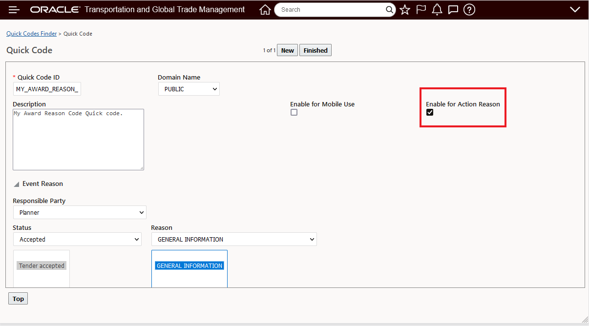

Configure Quick Codes to Select for Award Reason Codes
This feature allows you to tag the Quick Codes displayed to the planner for the Award Reason Codes when the planner awards a Spot Bid Tender to a service provider other than the lowest bid service provider.  To configure a Quick Code to show in the list of Award Reason Codes, on the Quick Code screen you should select the Enable for Action Reason checkbox to have the Quick Code displayed.  In the example below, the MY_AWARD_REASON_CODE Quick Code will be provided as an option for the planner to select since the Enable for Action Reason checkbox is selected.
Quick Code Setup
Quick Code Setup

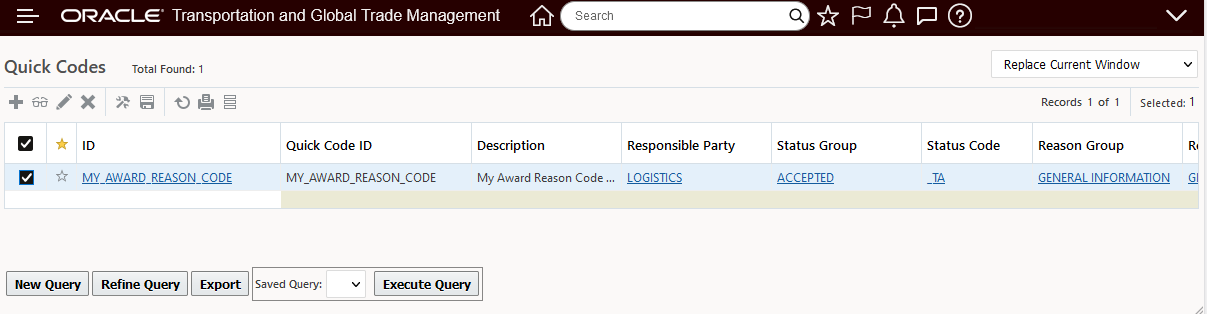

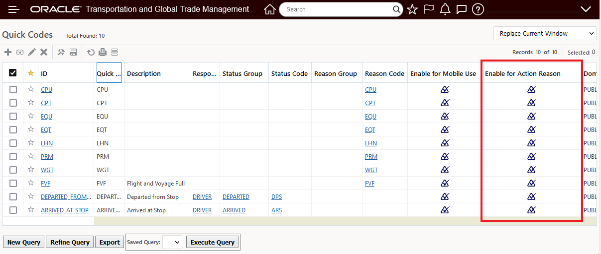

The Enable for Action Reason option is available in both the Finder and the Finder Results for the Quick Codes.
Enable for Action Reason - Finder
Enable for Action Reason - Finder Results

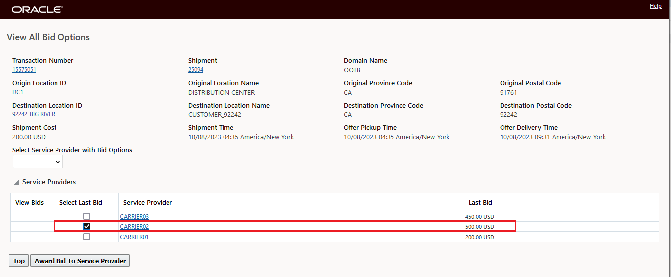

In the example below, there are currently three bids for a shipment, the planner has selected the bid for a service provider that is not the lowest bid.
Planner Award Bid to Service Provider - Not Lowest Cost

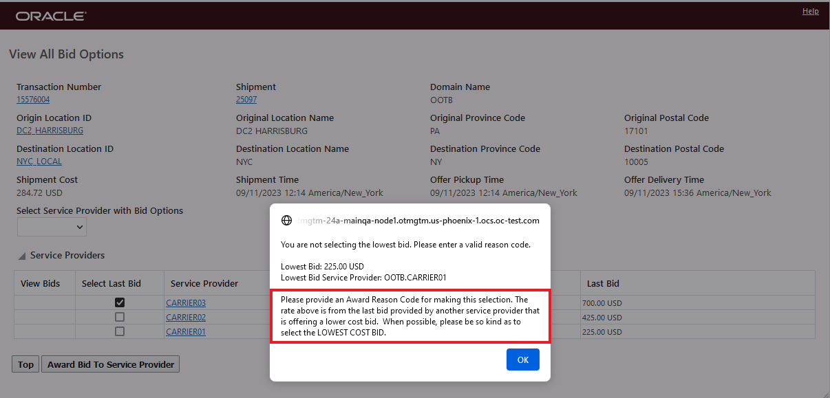

When the planner selects a bid that is not the lowest bid, the following message is displayed and the Award Reason Code is displayed.
Award Reason Code Required

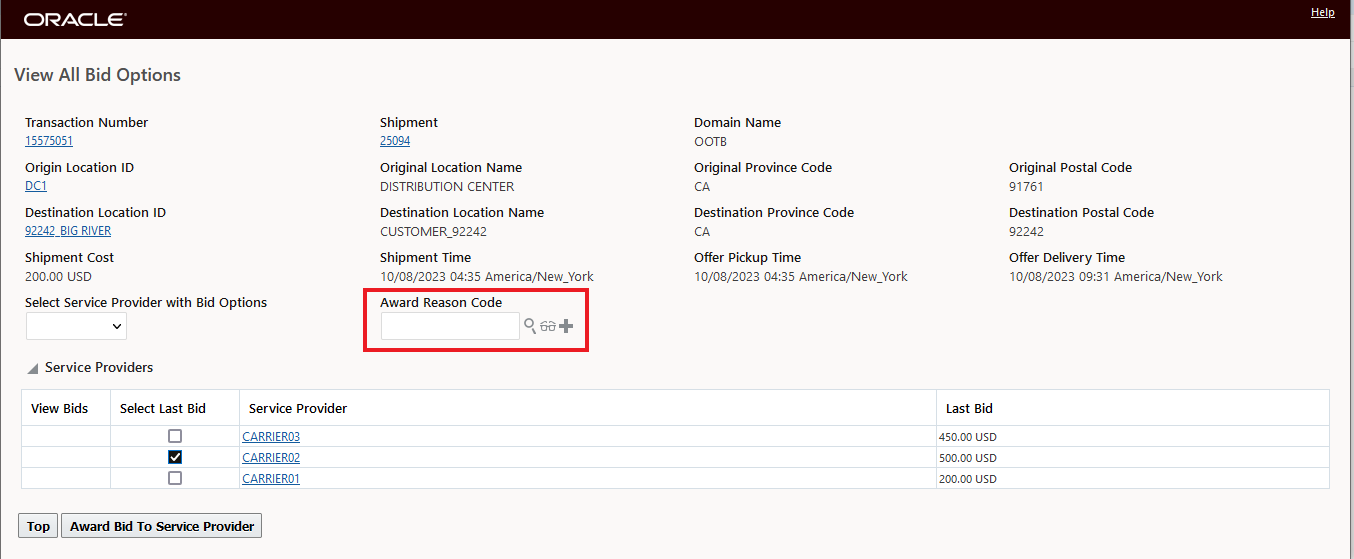

Once the planner selects a bid that is not the lowest, the Award Reason Code field is displayed as shown below.
In this setup  with - glog.tender.spotBid.enableValidationForLowestBid set true, the planner is required to provide an Award Reason Code to successfully award the bid to a service provider other than the lowest bid service provider.

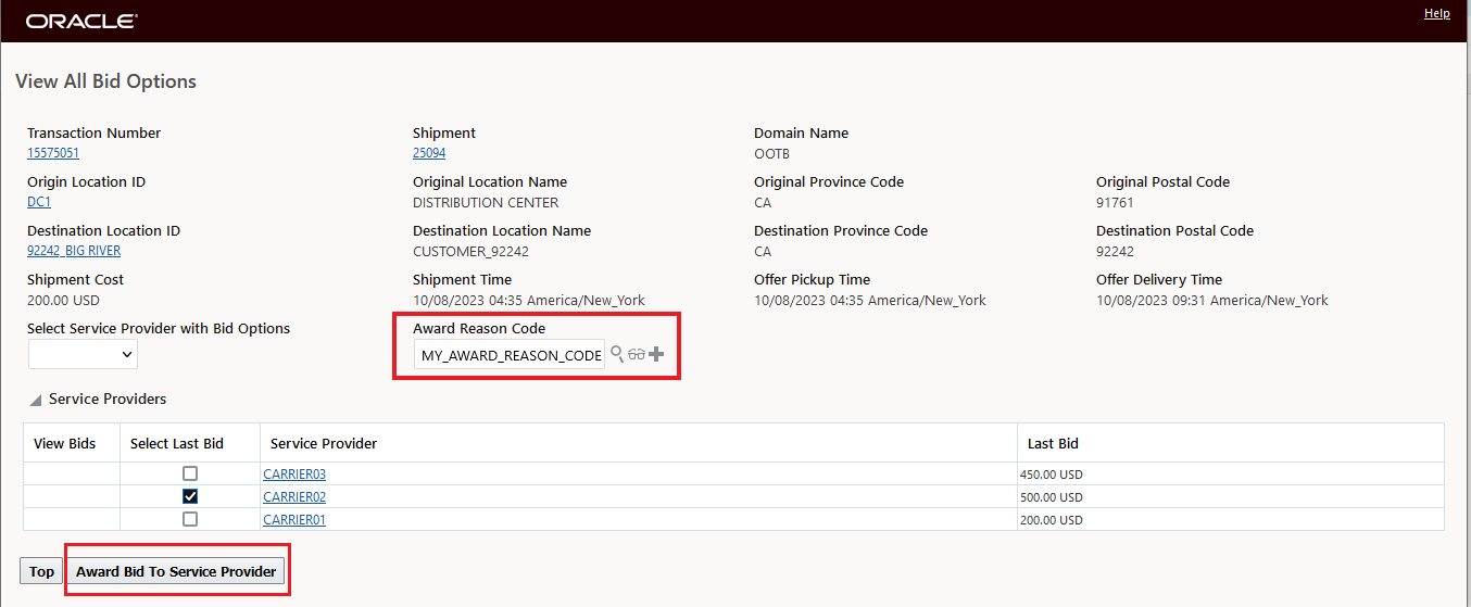

When the MY_AWARD_REASON_CODE Award Reason Code is provided - the planner is able successfully submit the Award Bid To the higher cost service provider.
Award Reason Code Provided

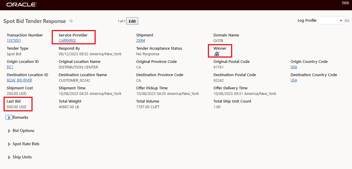

Final result - CARRIER02, with a higher bid 500.00USD is the winner.
Higher Bid Service Provider Selected

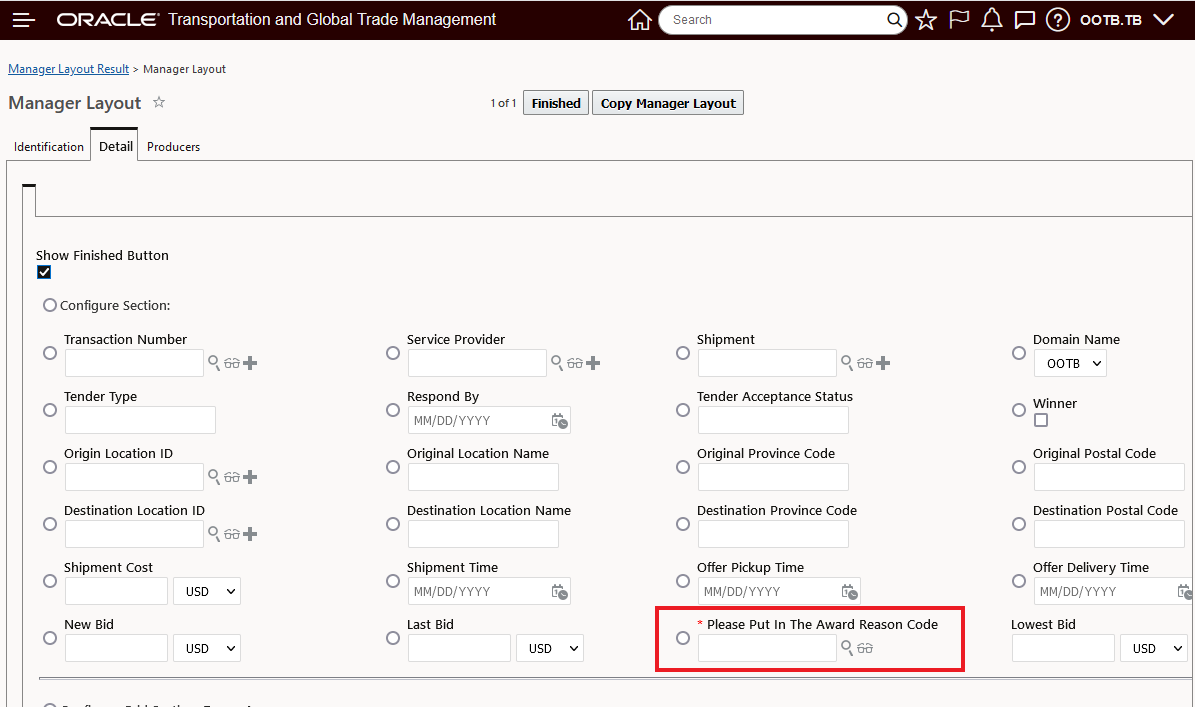

Configuration for the Award Reason Code Field
The Award Reason Code field has been enhanced to support Manager Layout configuration. You can change the label, make the field a fixed list, remove the View or New button etc. In the example below, the Award Reason Code fields label has been changed and the option to Add a new Quick Code has been removed.
Configure Award Reason Code field

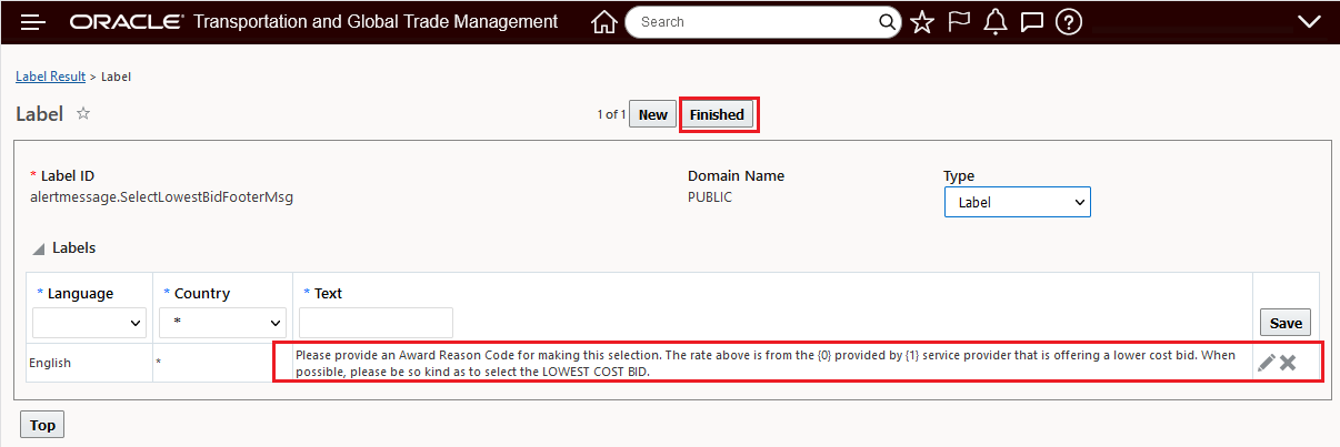

Configure Alert Message
To configure the alert message you will need to perform the steps below.
  1. Login as DBA.
  2. Navigate to the Label Manager. Configuration and Administration > User Configuration > Label Manager.

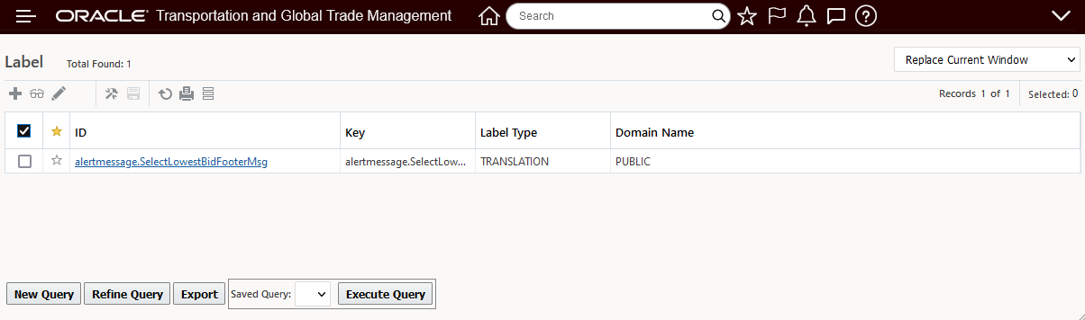

  3. Search the Key = alertmessage.SelectLowestBidFooterMsg
Search for Key = alertmessage.SelectLowestBidFooterMsg
Finder Result
Finder Result
  1. Modify the label and Finish.
Modified Label
Modified Label
  1. Then, when the alert is raised the new modified label will be shown.
Modified Label Shown In Alert
