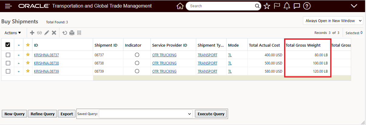

In the example below, the three shipments all fall into the same tiered rating time period definition.  The Total Actual Cost shown 1,480 USD, is the total cost the the shipments before the action Record Shipment For Tiered Rating has been run.
  • Shipment 1 - 400.00 USD (80 LB * 5.00 USD per LB) +
  • Shipment 2 - 500.00 USD (100 LB * 5.00 USD per LB) +
  • Shipment 3 - 580.USD (100 LB * 5.00 USD per LB + 20 LB * 4.00 USD per LB)

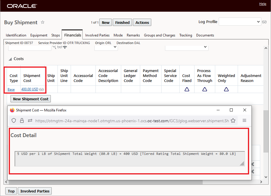

  • Shipment 1 = 400.00 USD (80 LB * 5.00 USD per LB) +

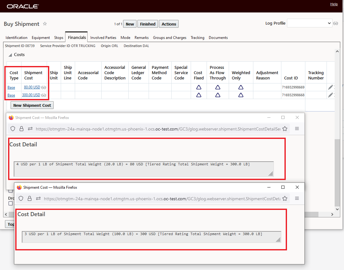

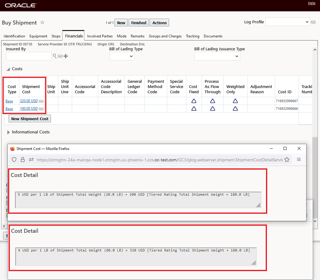

  • Shipment 2 = 420.00 USD (20 LB * 5.00 USD per LB) + (80 LB * 4.00 USD per LB) +
  • Shipment 3 = 380.00 USD (20 LB * 4.00 USD per LB) + ( 100 LB * 3.00 USD per LB).
For the Shipment 1 below, for 80 LBs, all of the shipment weigh falls into the 5.00 per pound rate break.

For shipment 2, the marginal rating impacts is shown.  In this case, 20 LB of this shipment falls into the first weight break, so the Cost Details shows 20 LB at 5.00 USD per pound for a cost of 100.00 USD. Then, the remaining balance of 80 LB for this shipment is rated using the 4.00 USD per LB rate, for a total cost of 320.00 USD.

Finally, for the third shipment of 120 LB, the first 20 LB falls into the 4.00 per LB break and then the balance of 100 LB falls into the final break where the rate is 3.00 USD per LB.

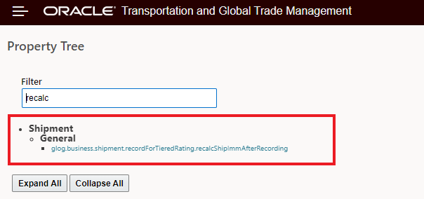

To properly calculate the Tiered Cost in situations where multiple shipments are recorded together - for example a multi-shipment select input to the Record Shipment for Tiered Rating action, the property glog.business.shipment.recordForTieredRating.recalcShipImmAfterRecording should be set to true.
 Property Tree
Property Tree
When the property glog.business.shipment.recordForTieredRating.recalcShipImmAfterRecording is set to true, the application recalculates the shipment costs immediately after recording the shipment for tiered rating.  This means if multiple shipments are being recorded, each shipment can get into different tiers. When set to false, this property recalculates shipment costs of all the shipments after they have been recorded. This means all the shipments will be in the same tier. By default, this property is set to false.
