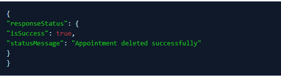

Example of a successful remove appointment response.
