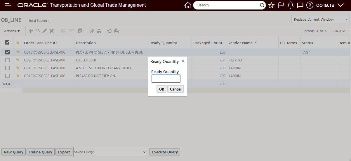

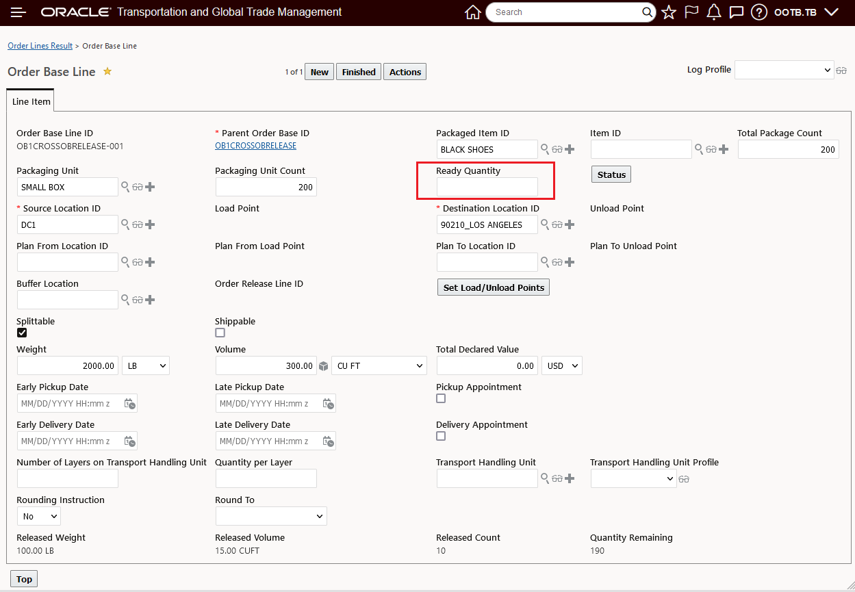

To start the process, you will provide a Ready Quantity value for your Order Base Line. You can add the value by editing your Order Base Line using the Manager as shown below.
Order Base Line - Ready Quantity

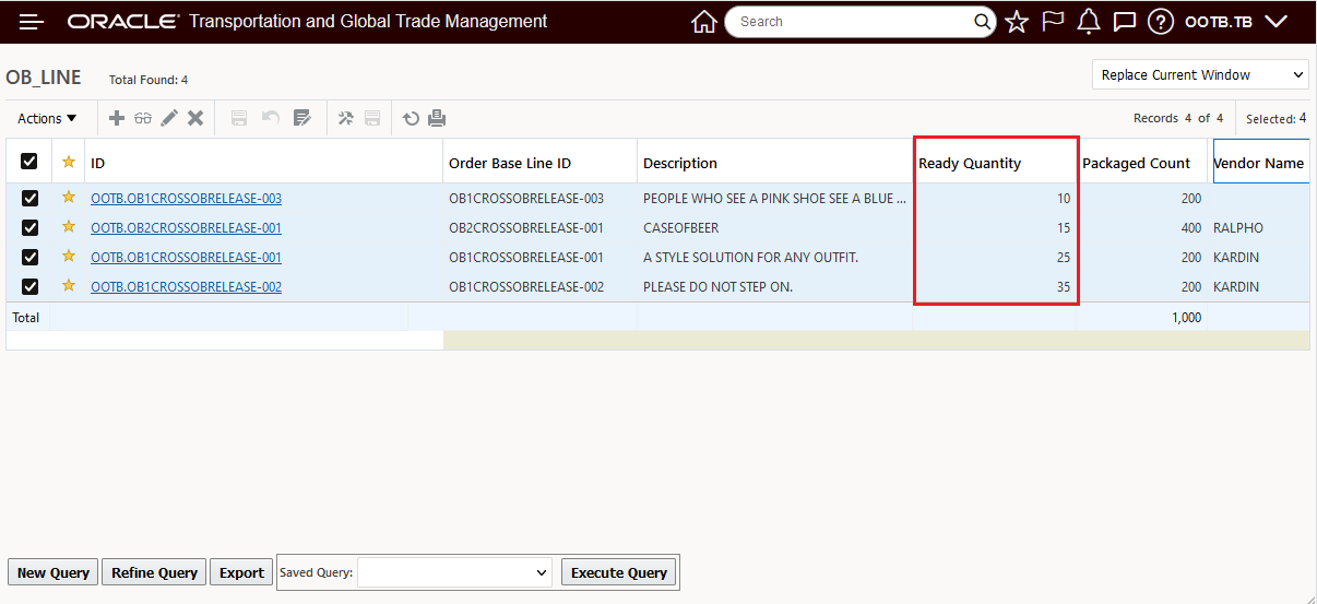

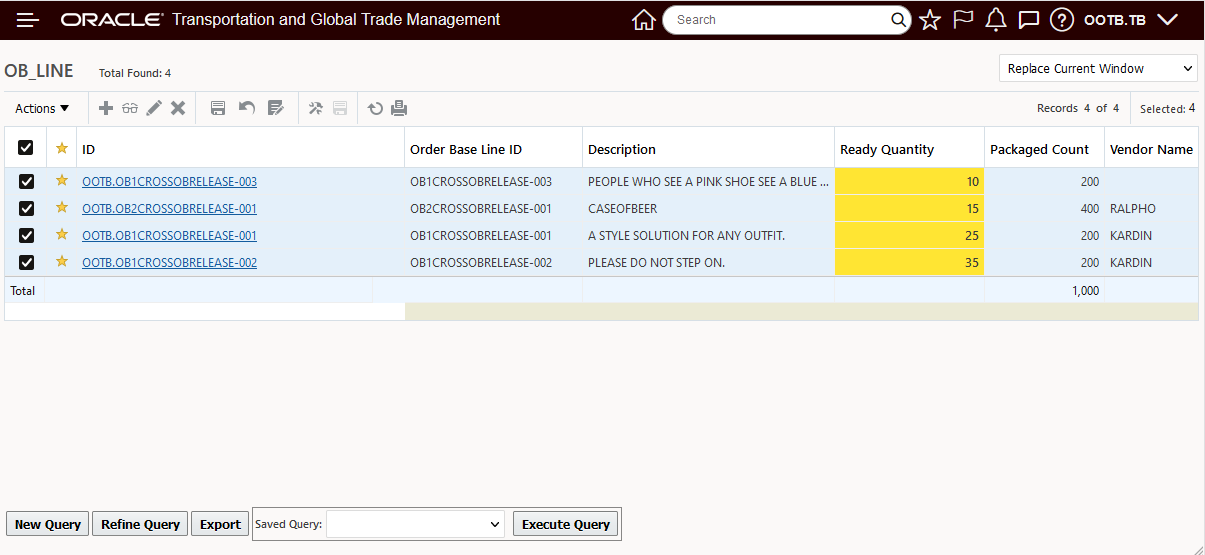

In this example, the Order Base Line Screen Set has been configured to allow for a quicker entry of the Ready Quantity using the in-line edit feature.
In-line Edit - Entry
In-line Edit - Ready Quantity Entered
Ready Quantity Entered for the Order Base Lines

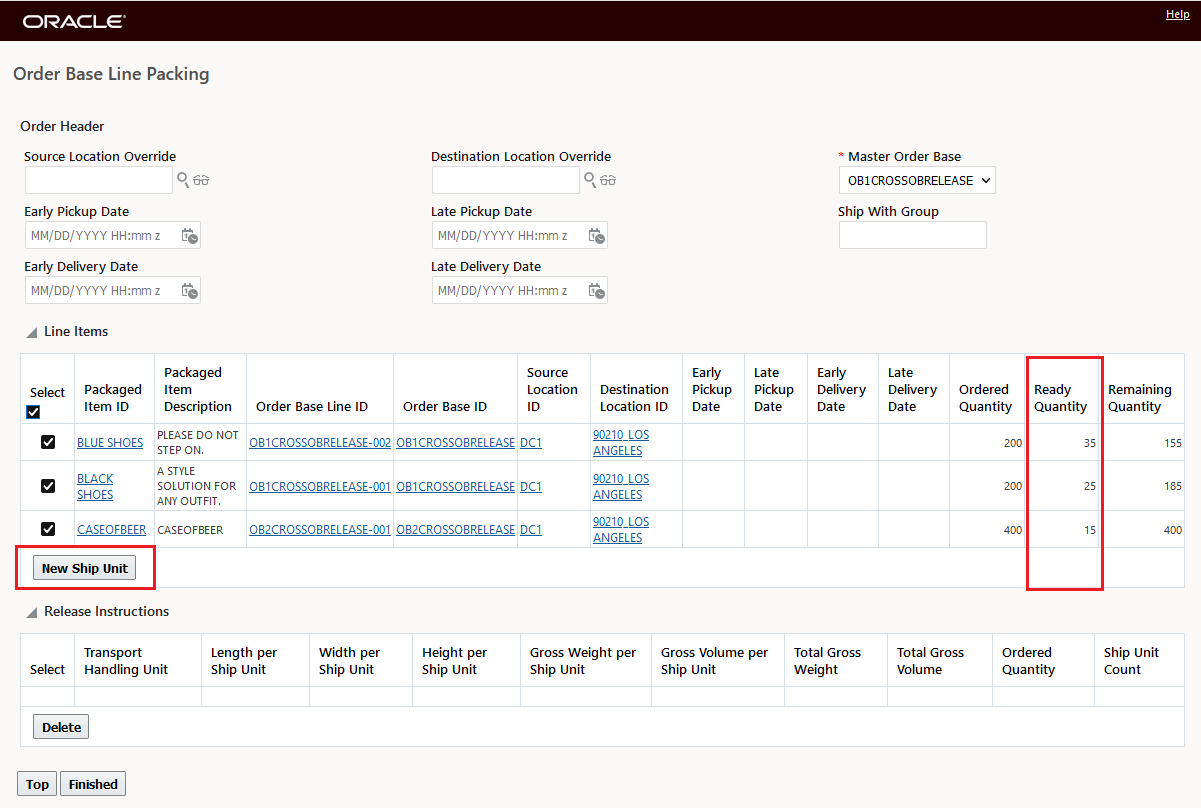

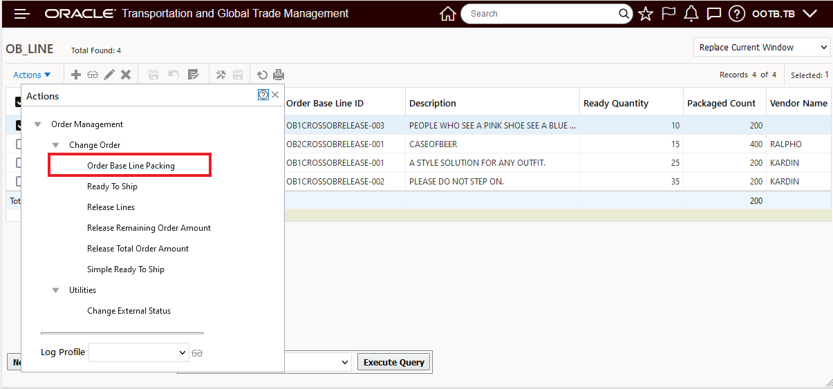

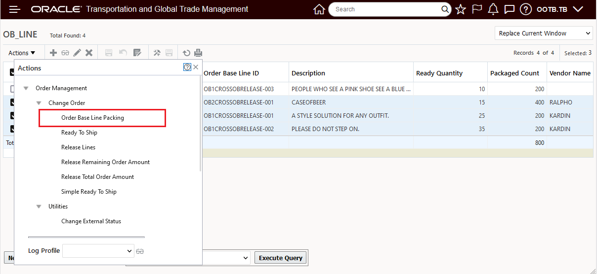

Now that you have entered the Ready Quantity for the Order Base Lines, you can now use the Ready Quantity to set the Ship Quantity for your Release processing. In this first example, the first Order Base Line with A Ready Quantity of 10 will be used to demonstration the new capabilities. To initiate the process, select Order Base Line and run the Order Base Line Packing action as shown below.
Run Action Order Base Line Packing

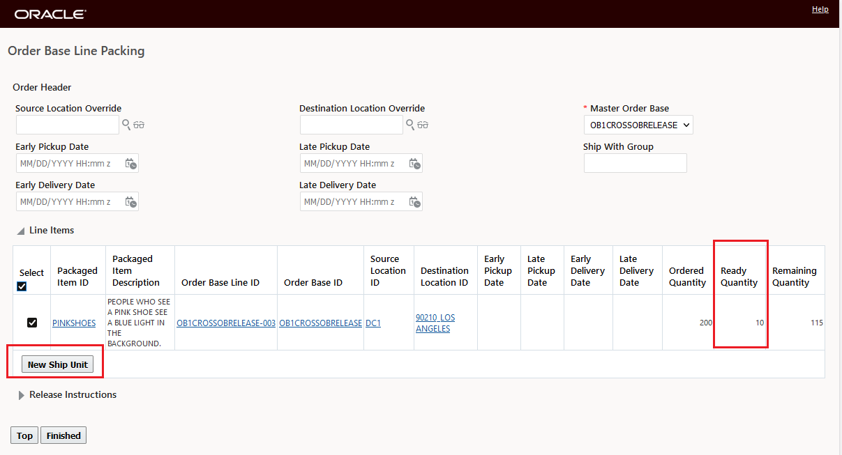

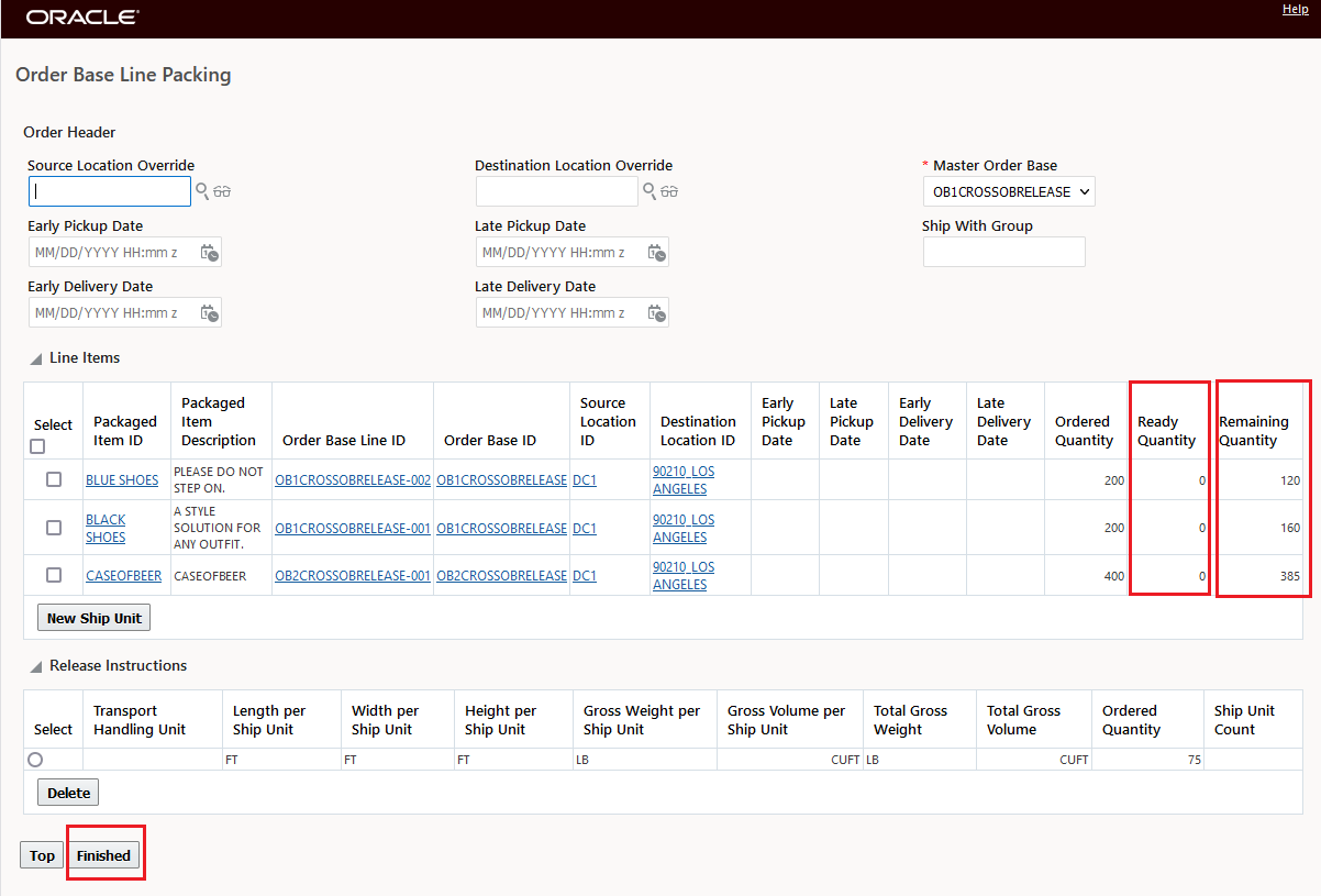

When the action is run the action input screen below appears, note that Ready Quantity column is now shown under in the Line Items grid. The next step in the process is to select the New Ship Unit option.
Order Base Line Packing Detail Screen

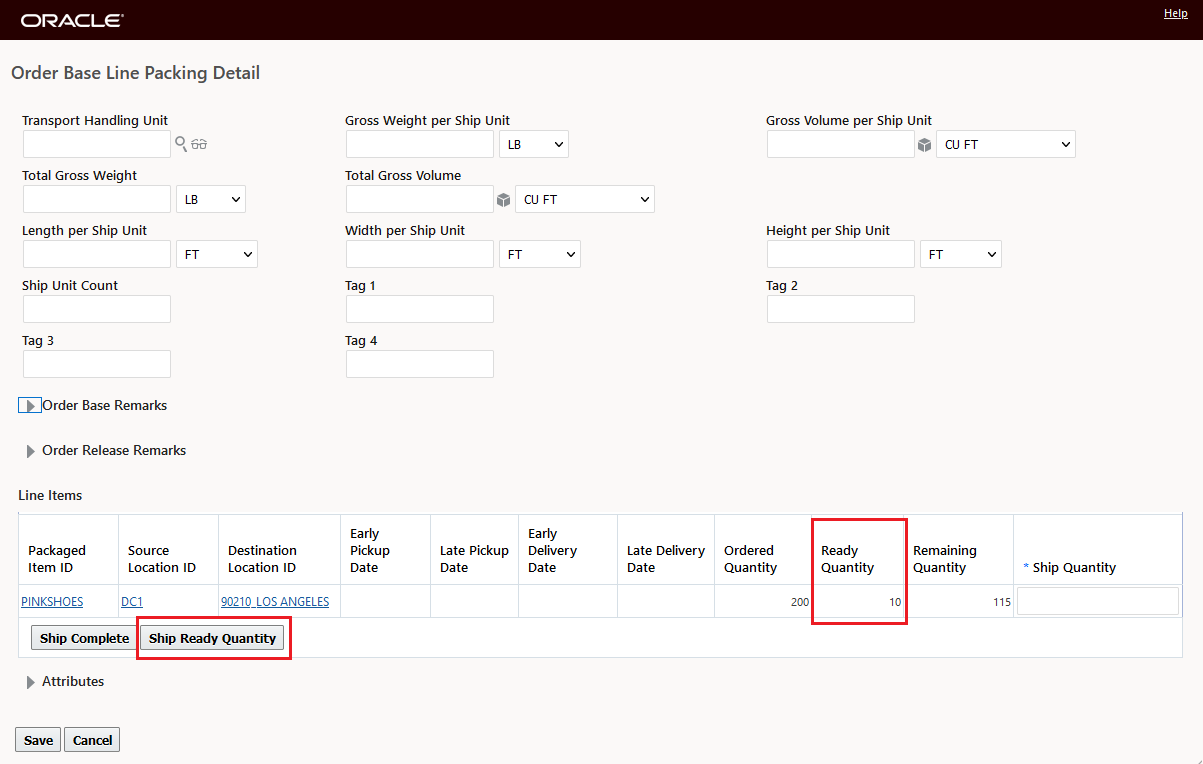

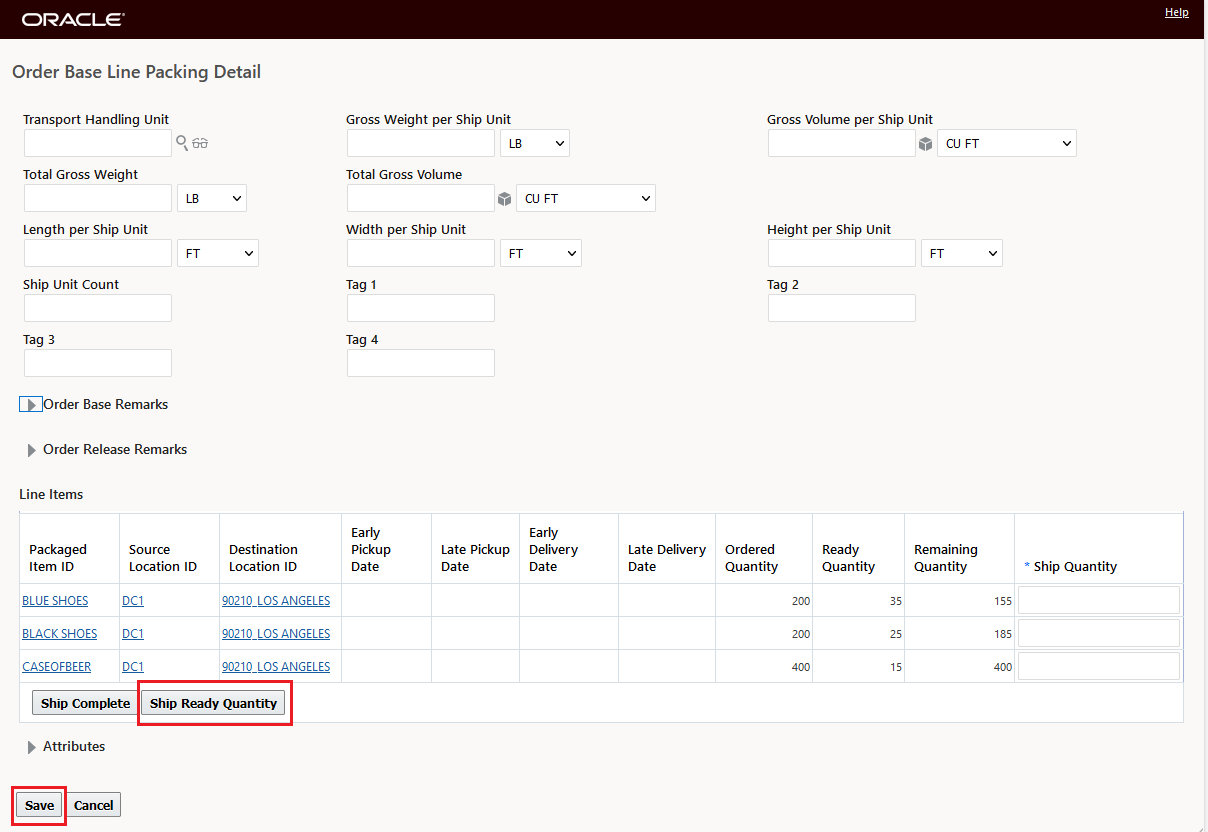

When the New Ship Unit button is selected, the Order Base Line Packing Detail screen is displayed. The Order Base Line Packing Detail screen now has a new option to Ship Ready Quantity or Ship Complete. In this example, the Ship Ready Quantity will be selected..
Order Base Line Packing Detail - Ship Ready Quantity

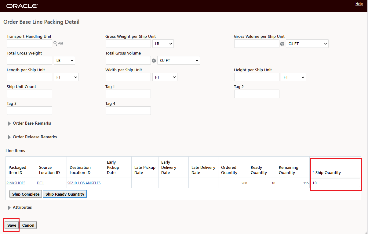

When you select the Ship Ready Quantity button, the Ready Quantity is moved to the Ship Quantity as shown below.
Ready Quantity to Ship Quantity

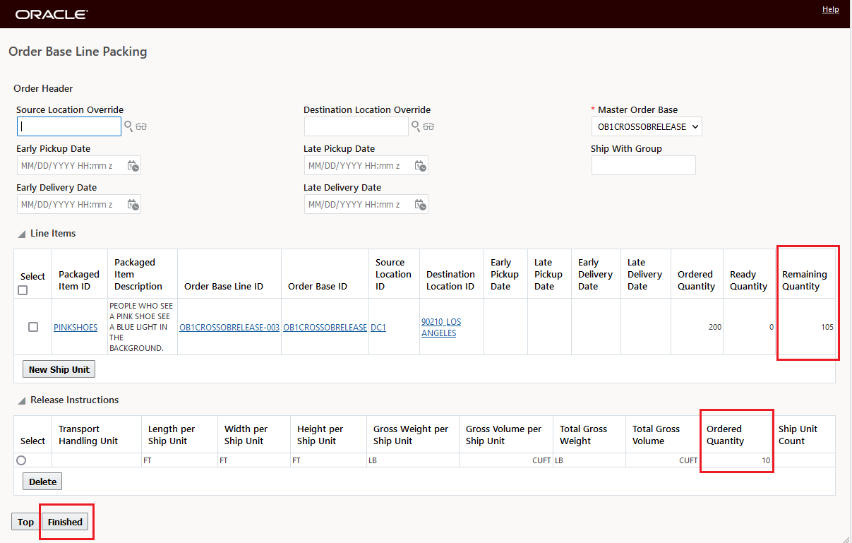

After you select Save above, the screen below appears - note that, as expected, the Release Instruction is for the Ship Quantity entered above, which originate from the Ready Quantity value and the Remaining Quantity has been reduced by the amount of the Ordered Quantity.
After Save

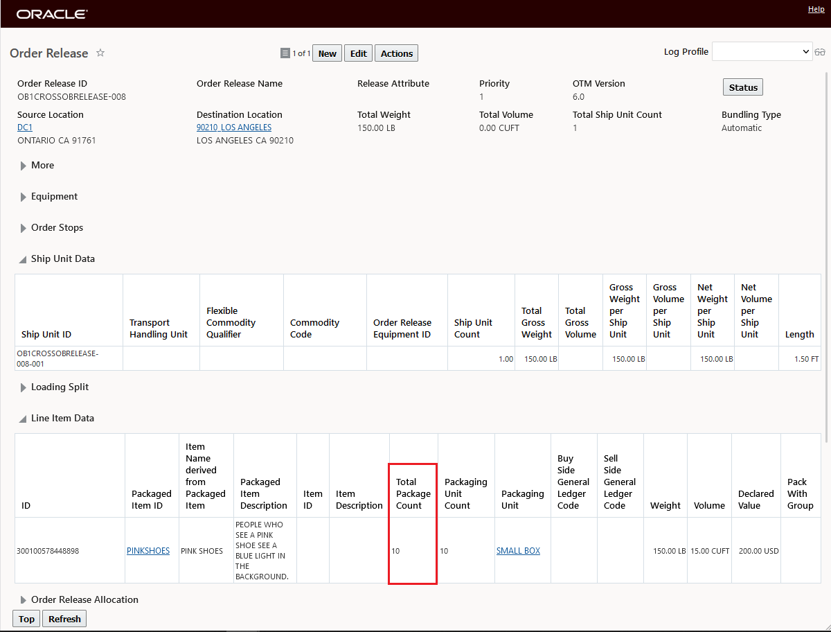

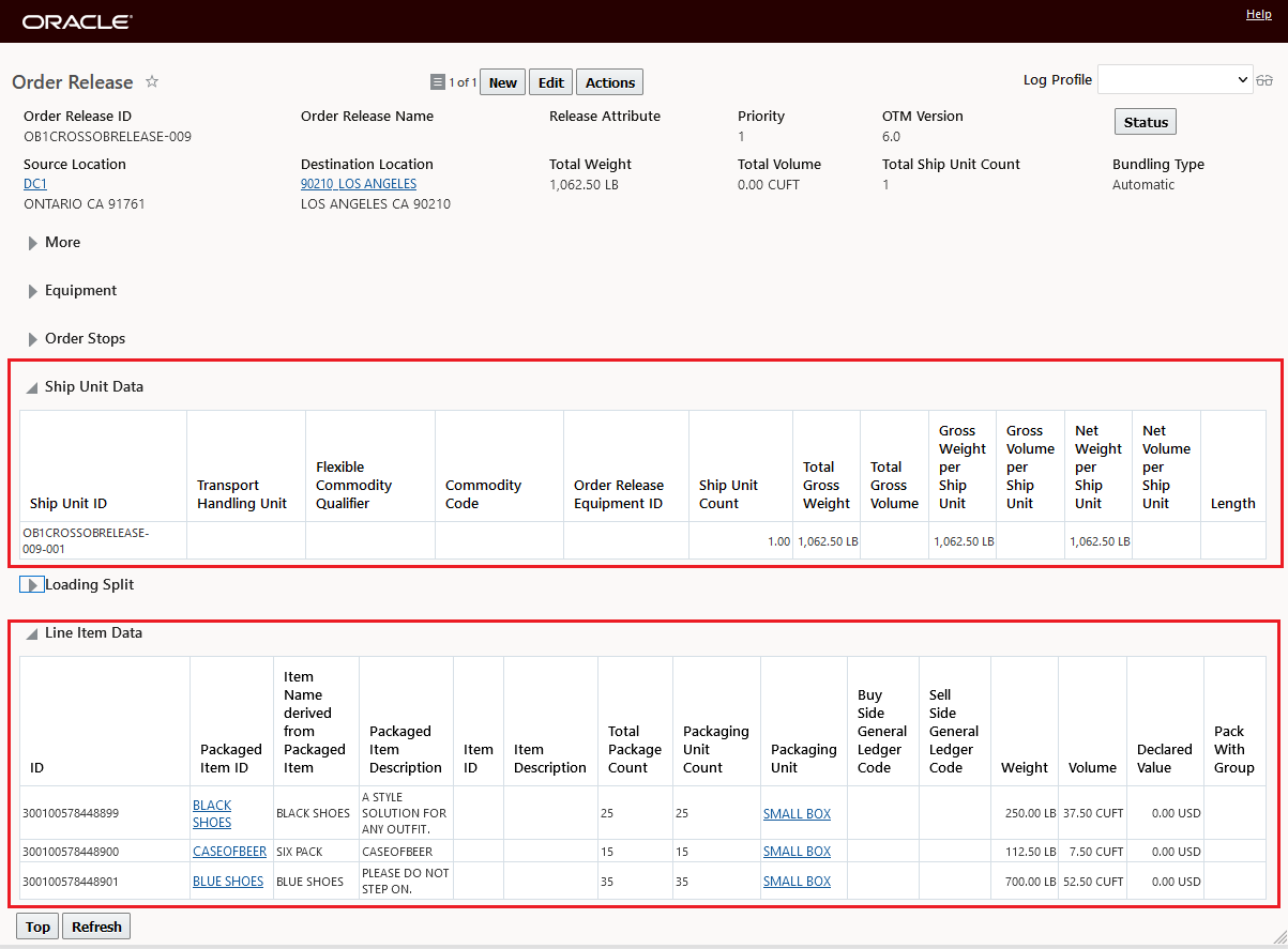

Below is the Order Release created after selecting Finish above.
Order Release Created
In the example below, the three Order Base Lines will have the Ready Quantity used for the Ship Quantity. The Order Base Line Ready Quantity values have already been set - as shown below..
Order Base Line Packing Three Order Base Lines
In the Details step of Order Base Line Packing action input, the three Order Base Lines Line Items are checked and the Create New Ship Unit is selected.
Order Base Line Packing - Line Items Selected

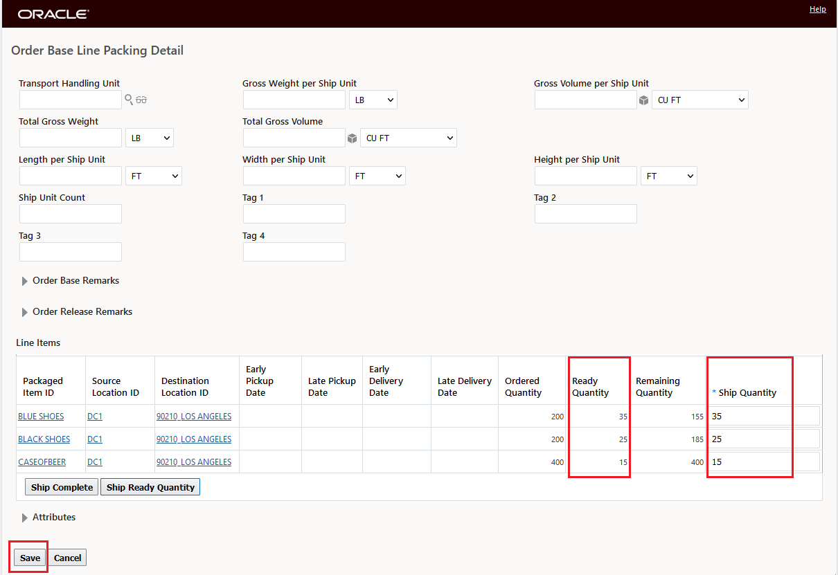

In the Order Base Line Packing Detail screen, you select the option to Ship Ready Quantity, which moves the entered Ready Quantity value to the Ship Quantity value.
Order Base Line Packing Detail Ship Ready Quantity
Ship Quantity is now equal to the Ready Quantity.
Ship Quantity = Ready Quantity
After Save above, the Ready Quantity is set to zero and the Remaining Quantity is updated to reflect the entered Ship Quantity.
Update Ready Quantity and Remaining Quantity
Selecting Finish creates the Order Release using the Release Instruction from above. The created Order Release has one Ship Unit with three Lines.

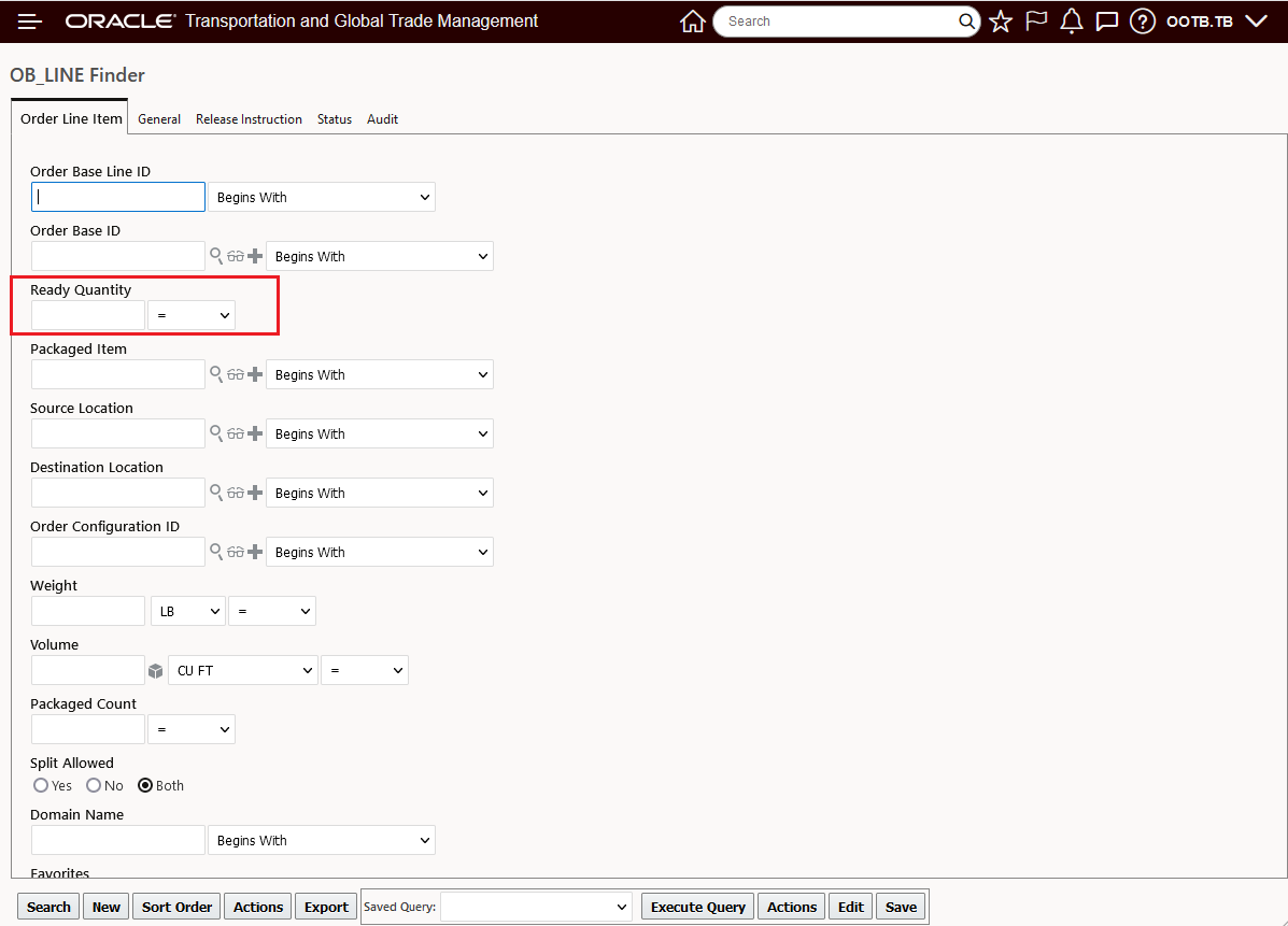

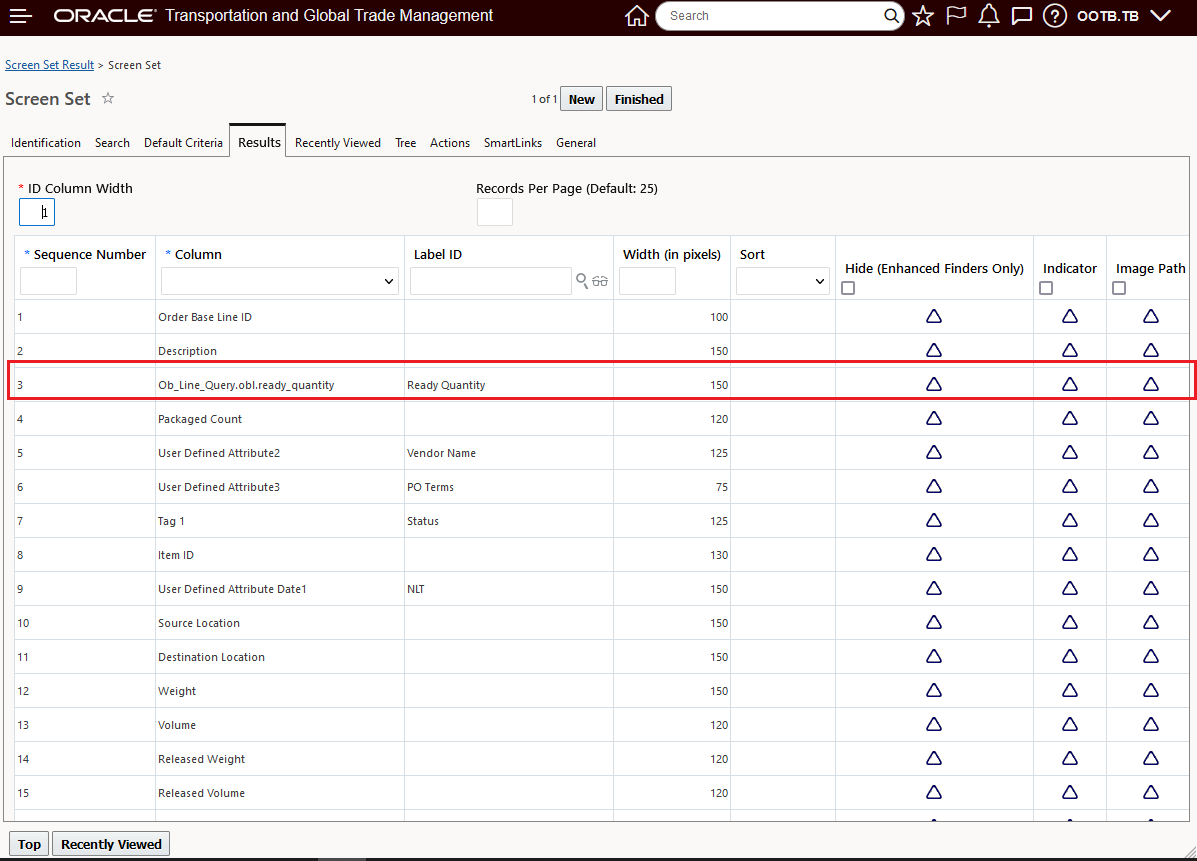

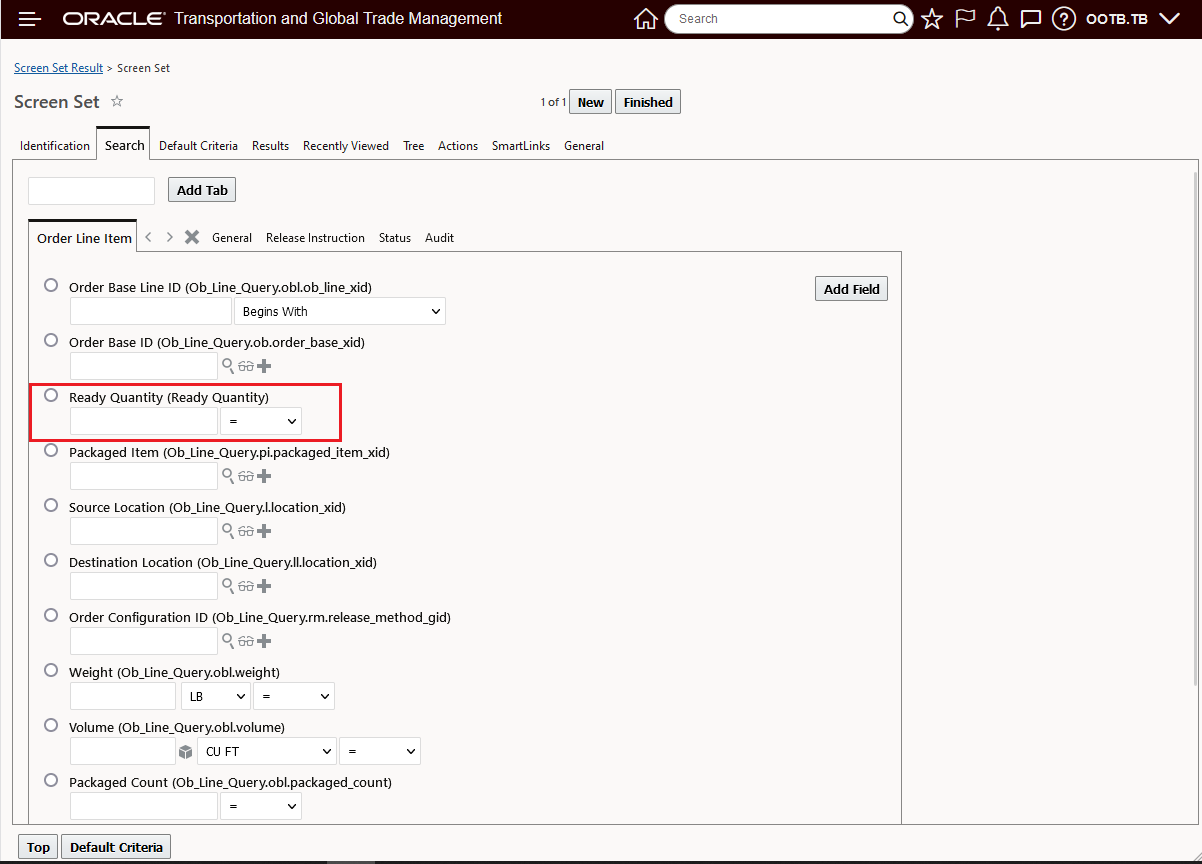

The Ready Quantity feature is Ready To Use - however - you might want to consider adding the Ready Quantity to your Screen Set (Finder, Finder Results) to allow for greater visibility and easier processing.
In the setup below the Ready Quantity field has been added to the Order Base Line Finder and Finder Results.
Screen Set - Add Ready Quantity to Finder
Finder - Ready Quantity
Also, adding the Ready Quantity to your Finder Results - with the option to Edit - will allow you to use In-line Editing to enter the Ready Quantity values.
Screen Set - Add Ready Quantity to Finder Result
With the Ready Quantity added to the Finder Results - with Edit Enabled, you now have the option to use In-line Editing to update the value.
Ready Quantity Added to Finder Result

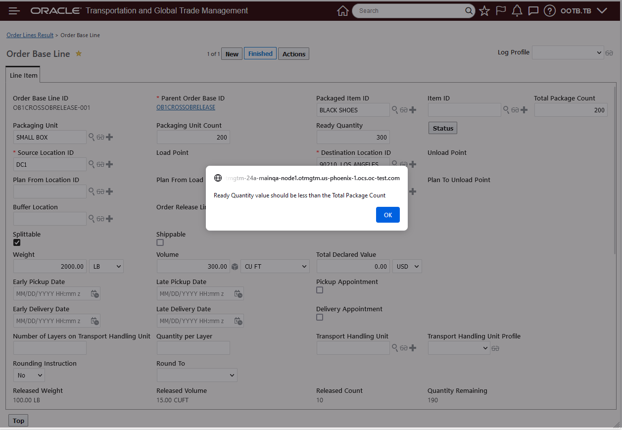

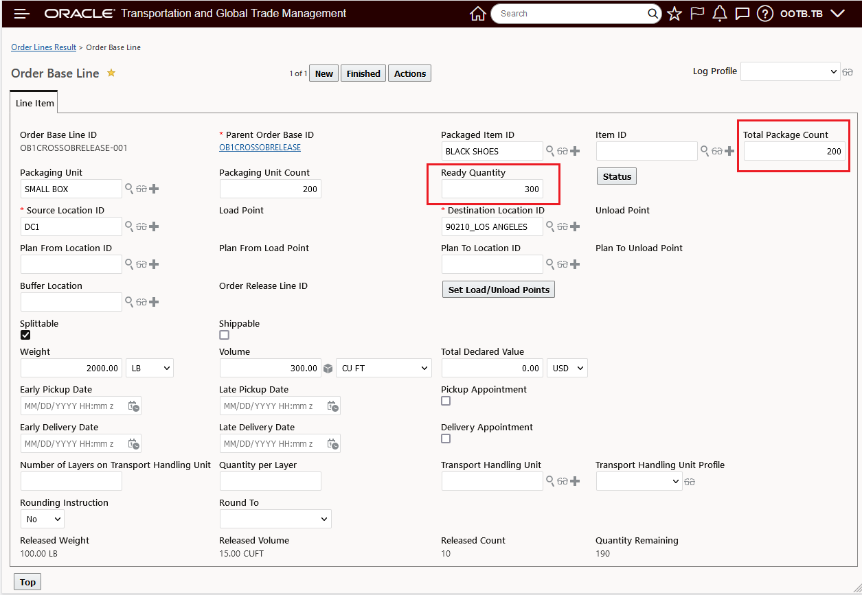

The application checks that Ready Quantity is less than Total Package Count..
Ready Quantity Greater Than Total
In the example above, where Ready Quantity is 300 and Total Package Count is 200 - the message below appears when an attempt is made to save the Order Base Line.
Ready Quantity Greater Than Total Package Count Error Message
