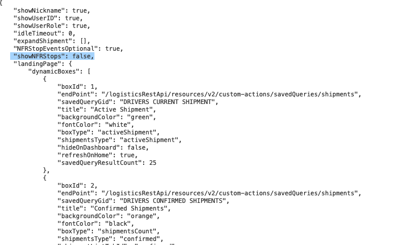

Highlighted below is the "showNFRStops" parameter set to the new option of false - NFR stops will not be shown on the Shipment List page.
Default value is true, set it to false if you don't want to show NFR stops at Shipment List page.

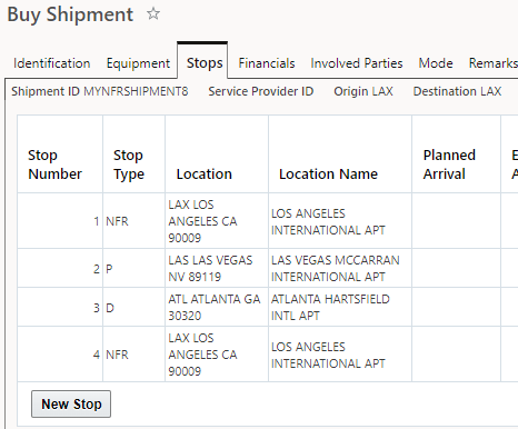

Shipments with NFR Stops will generally look like below with beginning/ending NFR Stops (the Shipment starts and ends at the Drivers home) with Pickup/Delivery Stops in between.

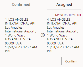

This will appear as below on Mobile app shipment list, while first and last stop show exact same information as both are NFR stops.

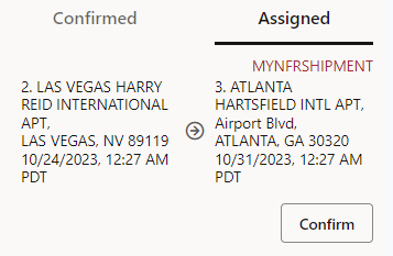

With showNFRStops set to false the user would then see the actual Pickup and Delivery Stops on the Shipment List.

To take advantage of this feature, in the Mobile Layout used for your Driver Flow, you will need to set the parameter showNFRStops to false. As always we recommend copying the Public Mobile Layout and configuring and assigning the copied version versus using the Public version of the Mobile Layout.
