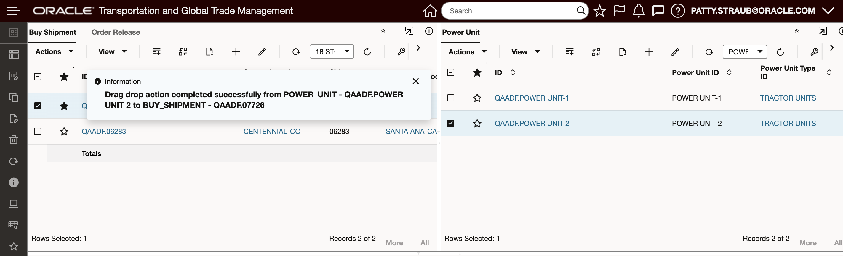

This new feature allows a user to assign a Power Unit to a Buy Shipment by using Drag/Drop.
To improve usability the Action Check ASSIGN POWERUNIT TO SHIPMENT can be engaged within an Enhanced Workbench Layout using drag and drop.  The drag of a Power Unit to a Buy Shipment will trigger this Action Check.
Workbench Example - Power Unit to Buy Shipment Drag/Drop
If Action Checks are configured for the action ASSIGN POWERUNIT TO SHIPMENT on the Buy Shipment Table, that will be honored and an error will be thrown if the check fails.
