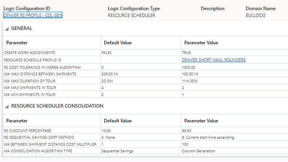

A new resource Schedule Logic Configuration Parameter was added, WA BETWEEN SHIPMENT DISTANCE COST MULTIPLIER allows the user to control the cost impact of the distance traveled between shipments on a Work Assignment. This cost is used only to influence the Work Assignment Optimization Algorithm and is not an actual cost on any shipment. The default value of the parameter is 1. This results in a cost of one monetary unit per distance unit. (Example $/mile) The default provides the same behavior as prior to this enhancement. The larger the value for the parameter, the costlier the distances between the shipments are viewed in the optimization algorithm, so the optimizer will be more likely to minimize this distance.

The two shipments to be linked in the WA may be close together or not. This enhancement adds a cost between shipments.
