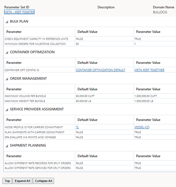

New Bundling Parameter
This is the full parameter set for the test case. This is important to note since the feature used in context with the Allocation by ERU enhancement so the ERU configuration is essential to both solutions.
Parameters Overrides Used for the Test Case

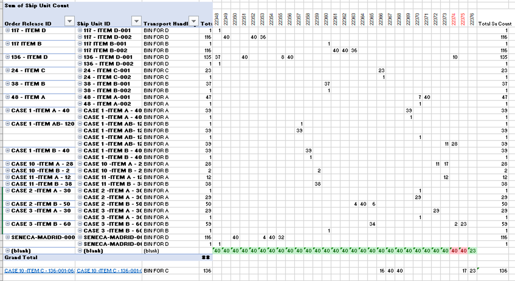

The next slide shows the results of a test. The left column shows the orders including the notation of full and partial pallets. Since the destination is a shipper controlled warehouse, the domestic orders are mixed but the desire is to keep the same items together. It is not always possible to have only one container with remnants, the goal is to minimize mixed loads. The Green and Red colors on the bottom show the success of the packing.
Test Case Analysis
