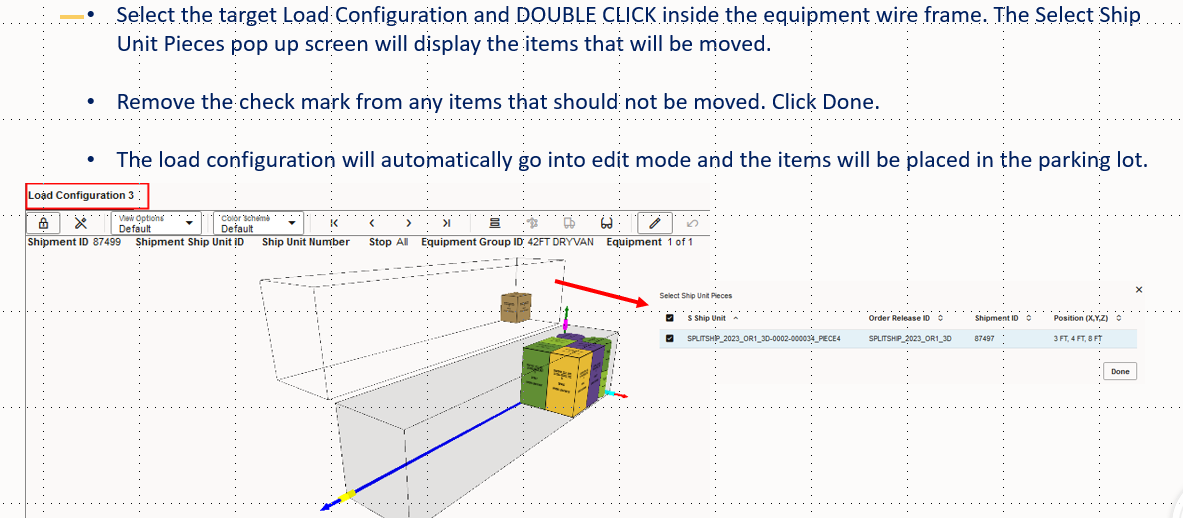

Mouse Action required to select the packing item to be moved.
Source Load Configuration Component

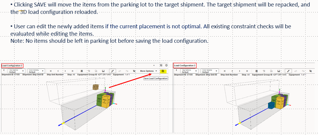

Select the target shipment and the packing item will be moved to the parking lot for that shipment.
Target Load Configuration
Drag the newly added item to the desired position on the target shipment.
Target Load Configuration Placement
