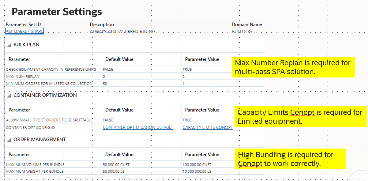

Steps to Enable

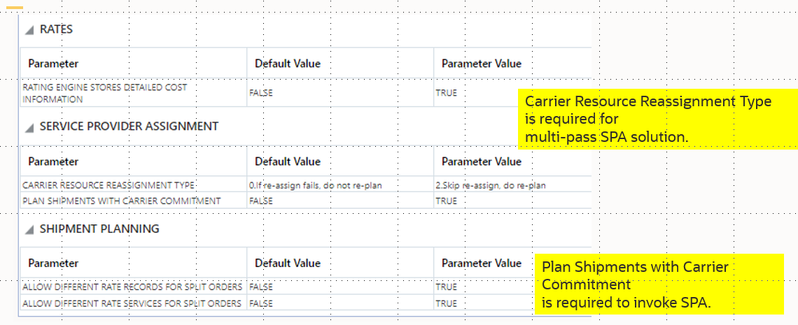

These are the primary parameter settings.
Market Share Parameter Settings

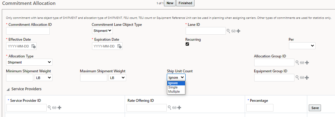

The Allocation Configuration has new fields to define the new attributes. These new fields are all on the header and apply to multiple carrier records in the grid. A separate Allocation must be configured for "each" grouping of Market Share. It is literally a separate allocation.
Overlapping is prohibited by the UI but not for CSV loading so care must be taken to not overlap.

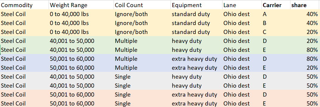

Market Share Allocation Configuration

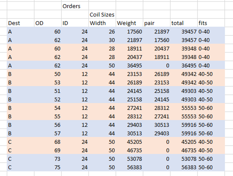

Sample Test Case where there are multiple Allocation Strategies. This chart shows those cases. There are 5 distinct Allocations. Each Allocation can be thought of as a Strategy as it is self contained and applied based on shipment attributes. Only ONE strategy should apply to any shipment. No overlapping is allowed.
Market Share Test Case
These orders are the basis of the test case.
Test Case Orders

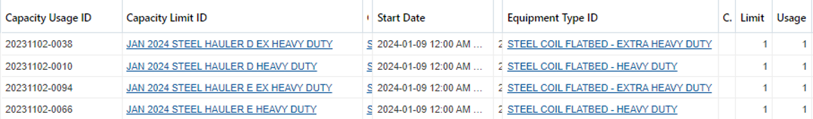

Results for test case with capacity limits.
Test Case Capacity Limits

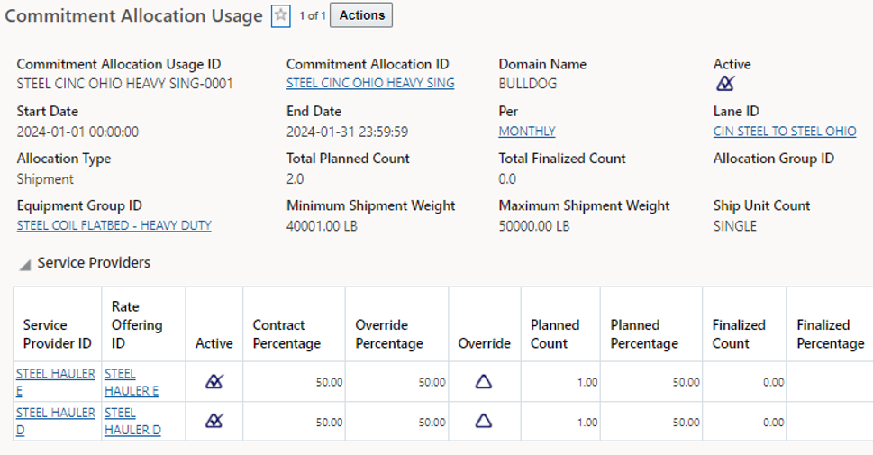

Test Case Allocation Usage

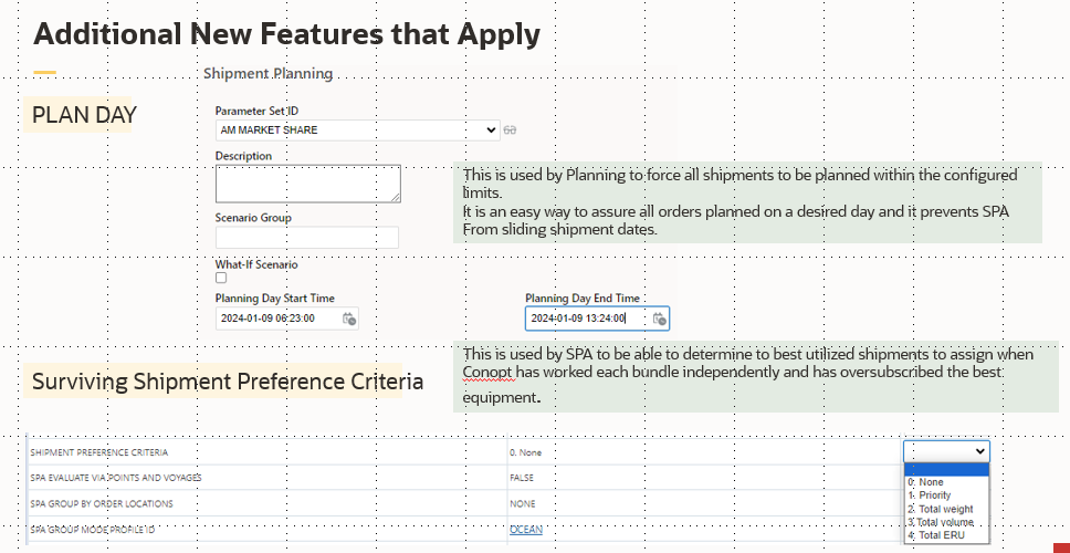

New Features that may apply.
New OTM Features That May Apply

Bundling and Conopt will build the shipments to be allocated as part of the normal workflow.
DO NOT configure Allocation within Conopt. It must be a sequential workflow process.
Capacity Limits within Conopt is needed to deal with limited resources, else Conopt will tend to favor large equipment.
