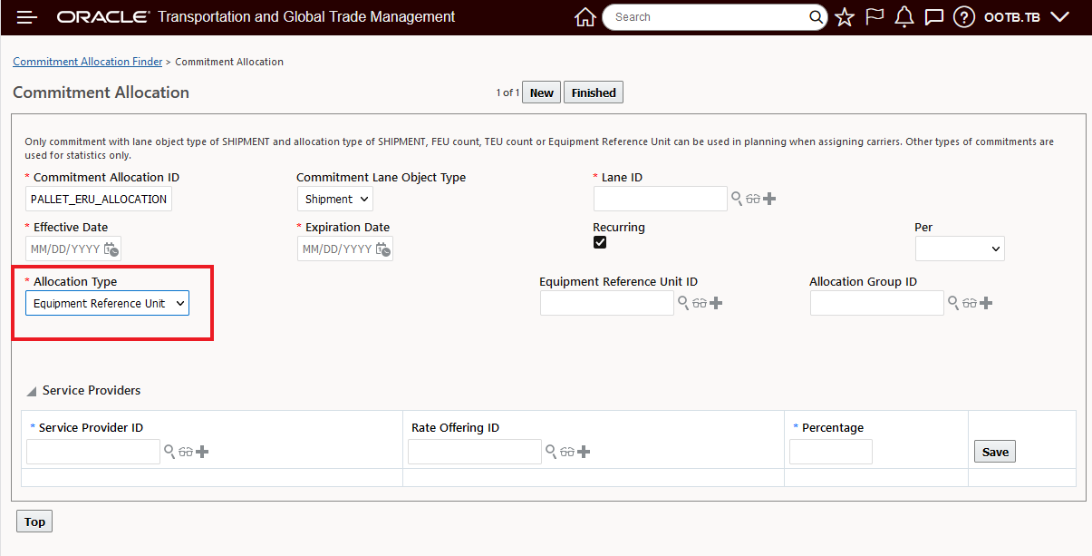

Commitment Allocation by Equipment Reference Unit
This enhancement allows the definition of Commitment Allocation with a Commitment Allocation Type of Equipment Reference Unit (ERU). This feature will be beneficial to support scenarios where the Commitment Allocation to Carriers and/or Freight Forwarders is based on pallets (modeled as ERUs) versus shipments, FEUs or TEUs. In this setup, the logic follows the following pattern - pallets are Ship Units, Ship Units have Equipment Reference Units, and the decision was made to enhance allocation based on the Equipment Reference Unit.
The Equipment Reference Unit Allocation Type can be found by navigating to Contract and Rate Management > Contract Management > Commitment Allocation.
Commitment Allocation Type Equipment Reference Unit

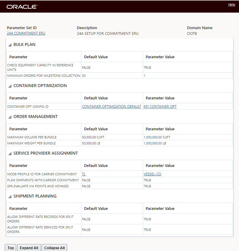

The Planning Parameter Set should be set for Service Provider Assignment as illustrated.
Parameters to Configure

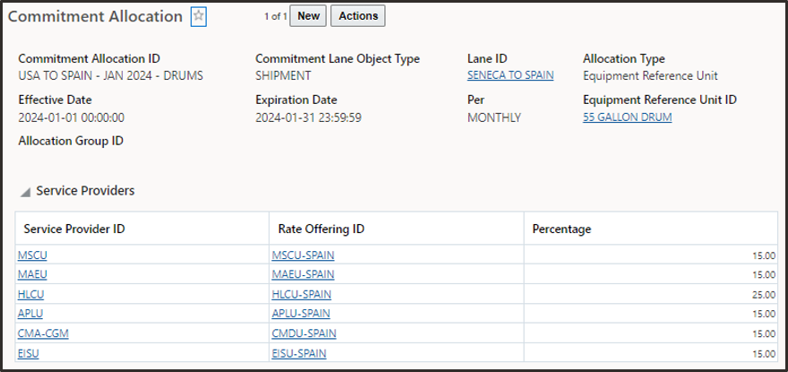

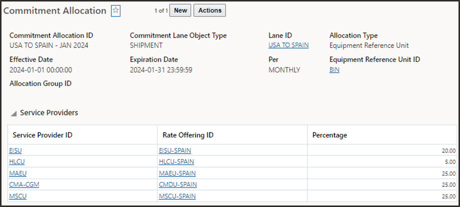

The Commitment Allocation should contain the specified ERU, Which is a DRUM in this example and a BIN in the next.
Allocation Configuration for DRUM
Allocation Configuration for BIN

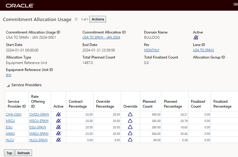

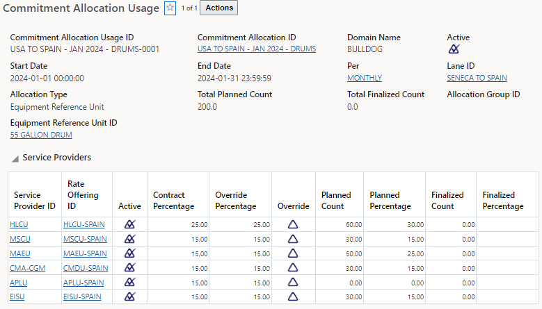

After planning Orders into Shipments, you will want to look at the usage. In this case there were 2 sets of orders, BINS and DRUMS and each one was intended to use a different allocation strategy.

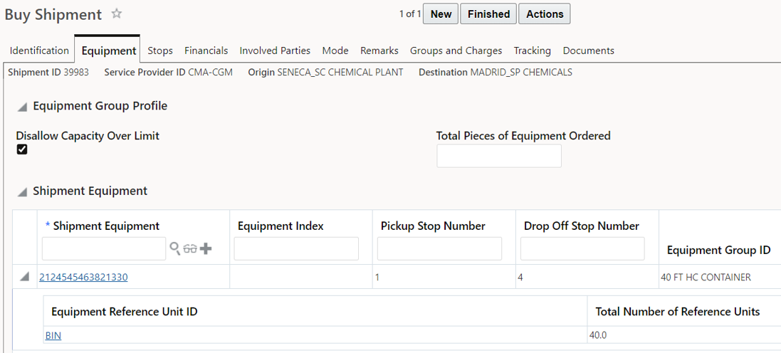

Please note that the ERU does NOT have to be configured on the Order Ship Unit if it is already configured on the Packaged Item or the Transport Handling Unit. The place to view the ERU used and the count is on the Shipment Ship Unit.

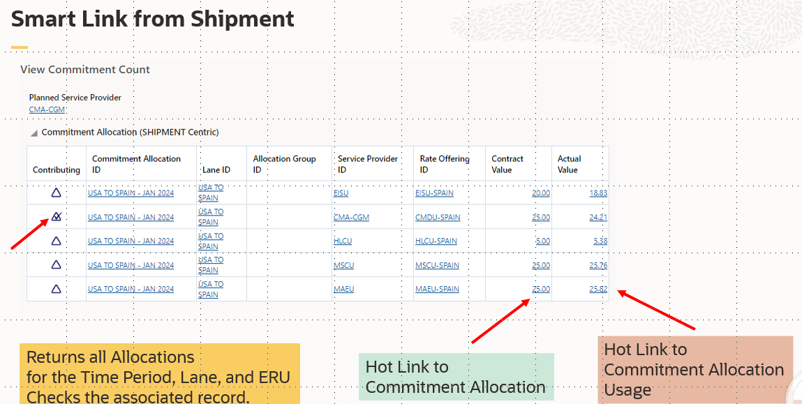

Shipment Ship Unit as Viewed Through S-Equipment
A Smart link is provided from the shipment to view the Commitment Allocation. This is a quick way to see the usage.
Allocation Smart Link
This is the Allocation Usage for the Drum
Allocation Usage for Drum
This is the allocation Usage for the BIN.
Allocation Usage for Bin

Required PPS Configuration
- CHECK EQUIPMENT CAPACITY IN REFERENCE UNITS
- PLAN SHIPMENTS WITH CARRIER CAPACITY
- MODE PROFILE FOR CARRIER COMMITMENT
- Optional Parameters if using Arbitrary Shipments
- SPA EVALUATE VIA POINTS AND VOYAGES
