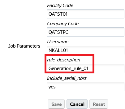

GENERATION RULE NOW MANDATORY
In order to prevent multiple instances of the Generate Inventory Balance Snapshot scheduled job being run at the same time, the rule description field is now mandatory.
Rule Description
NOTE: If you initiate the scheduled job rule without providing the generation rule description name, then the scheduled job will fail with an error message.
You will be able to view any failed jobs in the Scheduled Jobs -> Details UI and the Application Logs UI.

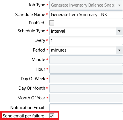

PREVENT RUNNING OF GENERATION OF INVENTORY SNAPSHOT SIMULTANEOUSLY
From 24A release onwards, simultaneous runs of the Generate Inventory Balance Snapshot scheduled job will not be supported. The frequency of scheduled jobs will be spaced out so that simultaneous runs do not get initiated.
In the Scheduled Job details, when you have the “Send email per failure” field configured, the system will send an email with the job failure reason.
Send Email Per Failure
