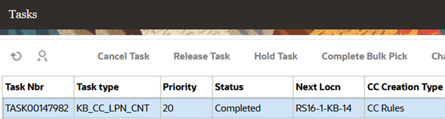

RECALCULATE TASK - ENSURE CC TASK TYPE GOES TO COMPLETED OR CANCELLED
In certain scenarios, such as a network outage, the Cycle Count (CC) Adjustment Record might still be in “In-Progress” or “Processing Started” status.
In the Task UI, the Recalculate Task button has been extended to handle scenarios for Cycle Count Tasks in Deferred mode.
You now have the option to manage the following for the CC_LOCATION_DTL and CC_LPN_COUNT Task Types:
  • update the task status to Completed if the associated CC Adjustment Record status is Pending or No Variance Status.
  • update the task status to Cancelled if the associated CC Adjustment Record status is Cancelled.
