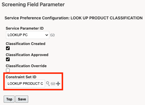

Service Preference
A Constraint Set field is added to the Service Preference. When you select a Service = Look Up Product Classification and configure the details, you can specify the Constraint Set ID which contains the matching criteria. If the constraint set is not specified on the service preference, all item classification records on the item associated with the transaction line are considered. In this example, you are specifying the Constraint Set ID = LOOKUP PRODUCT CLASSIFICATION which you previously created.
Service Preference with Constraint Set ID

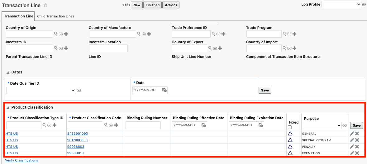

Trade Transaction Line/Declaration Line
You can add product classification data to the transaction line/declaration line manually or via the Look Up Product Classification action or agent action. When you trigger the action, GTM uses the details in service preference to determine which item classification data on the item to copy to the line. All applicable codes are copied to the line. In addition, a new Purpose field has been introduced on the transaction line/declaration line. This field enables you to model the usage of an HS tariff code such as GENERAL, PENALTY, EXEMPTION, or SPECIAL PROGRAM. If the purpose is identified on the item classification, it will be copied to the line when the action is triggered.
Trade Transaction Line with Multiple Classification Codes
