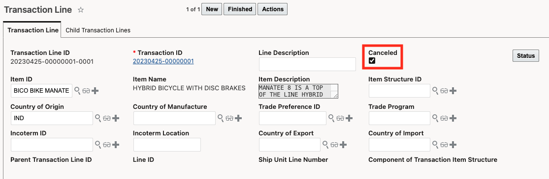

The feature enables you to flag a trade transaction line that is canceled. A new field is available on the transaction line called 'Canceled'. You can use this field to indicate that an existing transaction line has been canceled. If a transaction line is flagged as canceled, the Estimate Duty & Taxes action will not send it to an external engine for duty and tax calculation.
Trade Transaction Line Canceled Checkbox
Canceled Checkbox on Trade Transaction Line
This feature provides the ability to flag a transaction line that has been canceled. This helps to ensure that only active transaction lines are being sent to external engines for duty and tax calculations.
