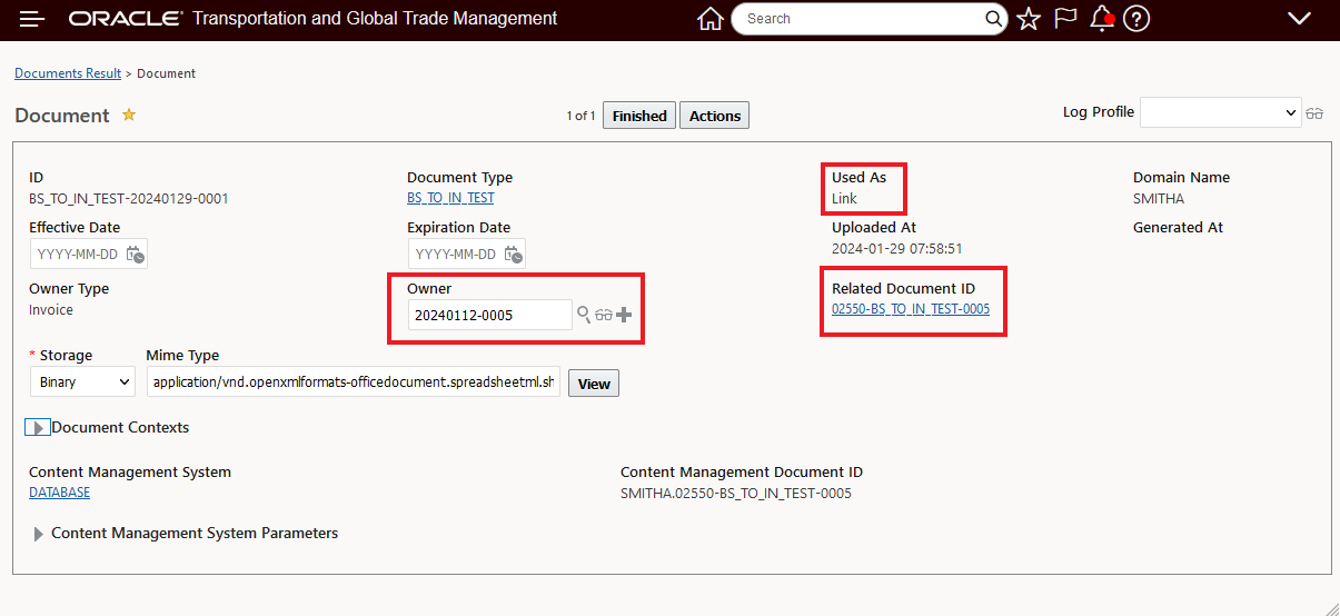

In the example below, the Invoice Document was Linked from the original document on the Buy Side Shipment.
Invoice Document Linked From Buy Side Shipment Document

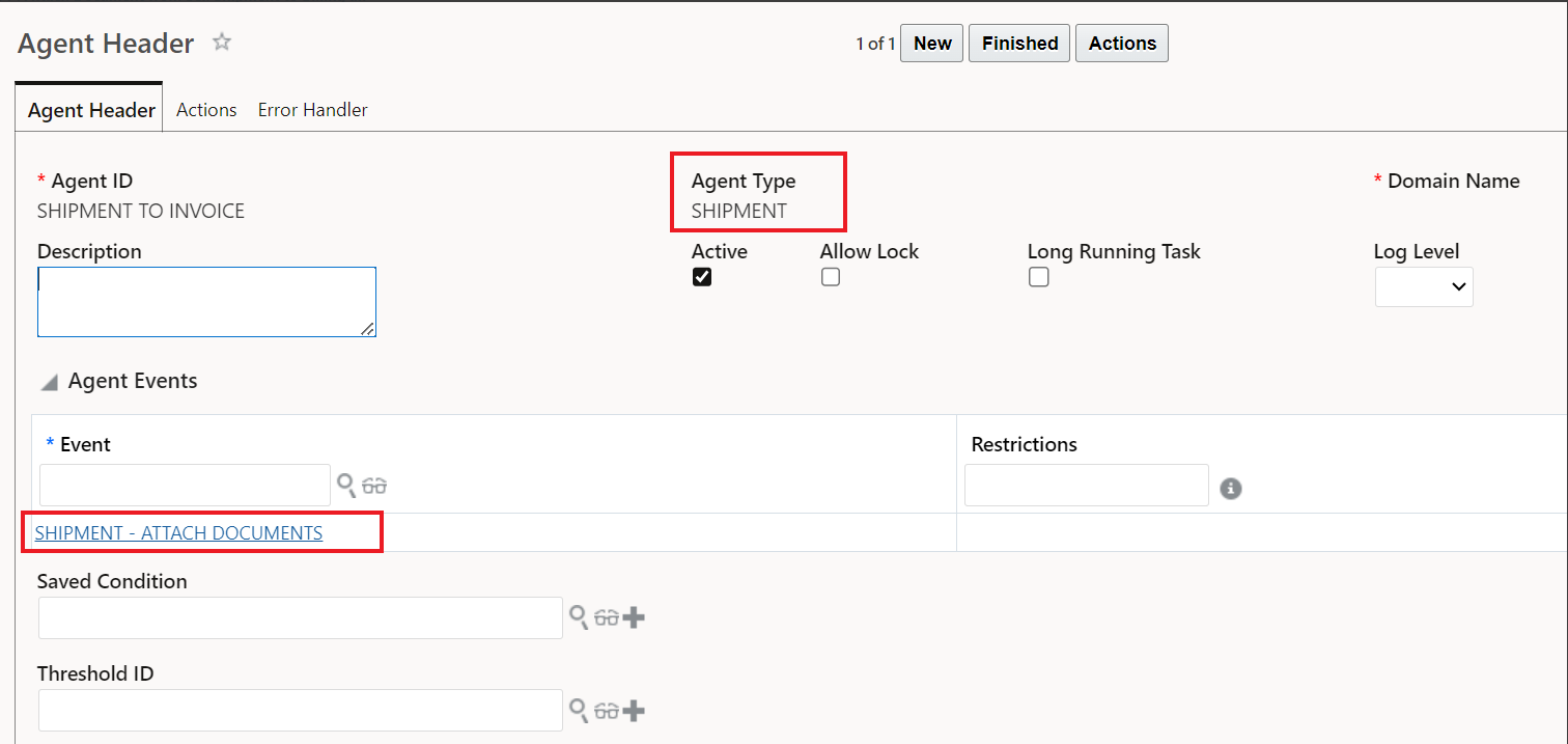

In the first example, the Document will be going from the Buy Side Shipment to the Invoice. The Agent Type for this setup is Shipment. In this example the Agent is triggered when a Document is Attached to the Buy Side Shipment.
Invoice to Shipment Automation Agent Header Example

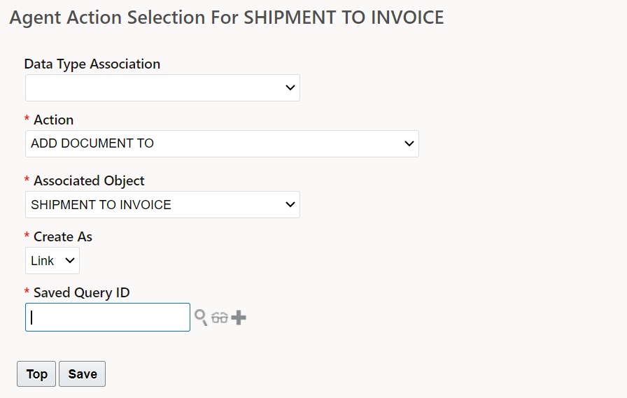

The Agent Action is as shown below. The Action is Add Document To, the Associated Object - in this case - is Shipment to Invoice and for this example the Buy Side Shipment Document will added as a Link to the Invoice.
Shipment to Invoice Agent Action

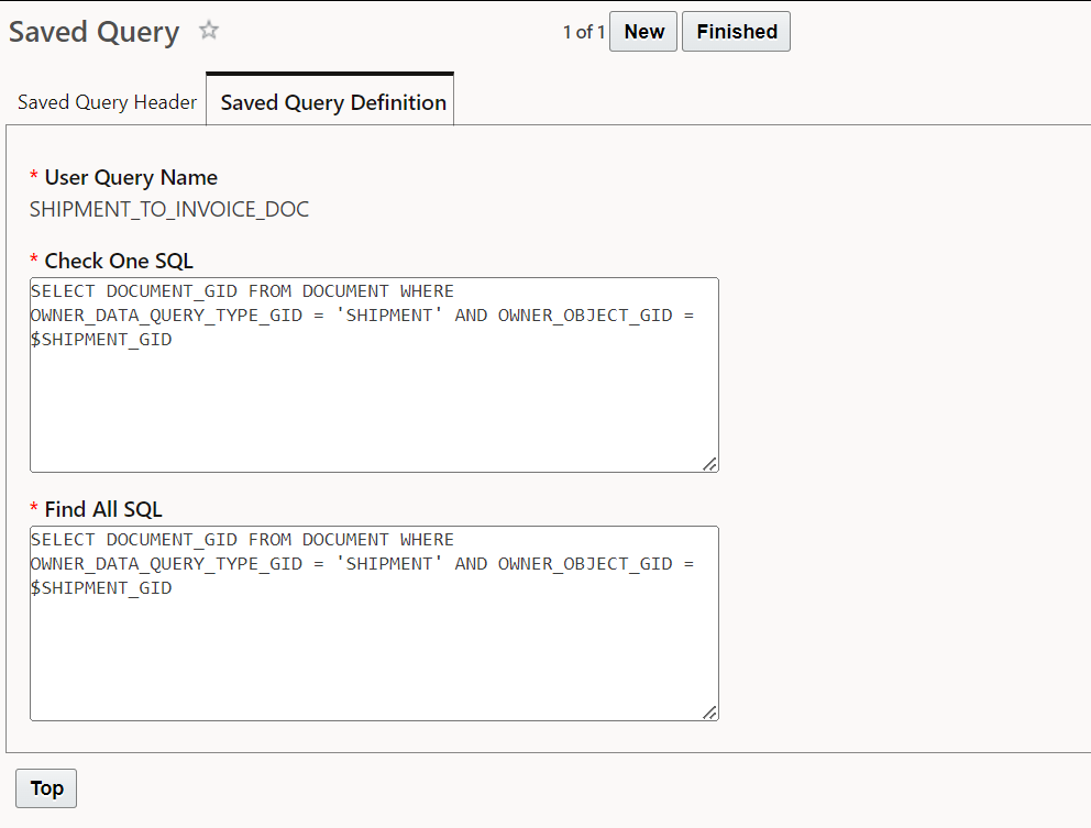

To complete the example, the Saved Query is provided below.
Shipment to Invoice Automation Agent Saved Query

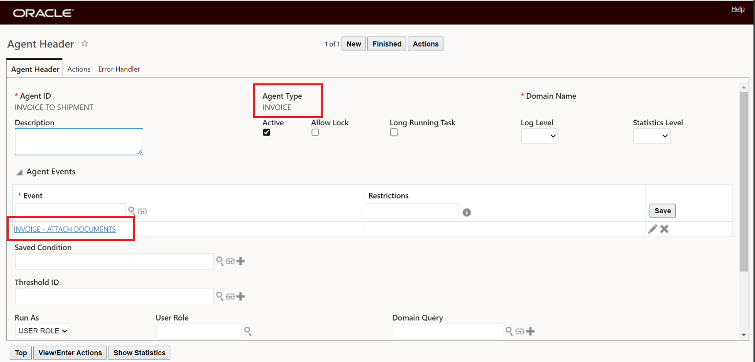

In the second example, the Document will be going from the Invoice to the Buy Side Shipment. The Agent Type for this setup is Invoice. This Agent is triggered when a Document is Attached to the Invoice.

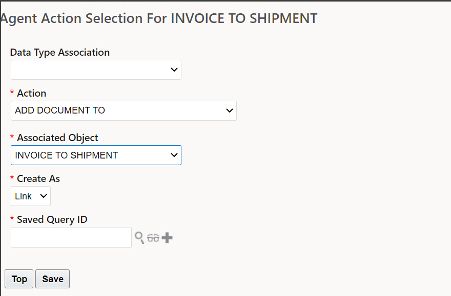

The Agent Action is shown below. The Action is Add Document To, the Associated Object in this case is Invoice to Shipment and in this example the Invoice Document will added as Link to the Shipment.
Invoice to Shipment Agent Action
