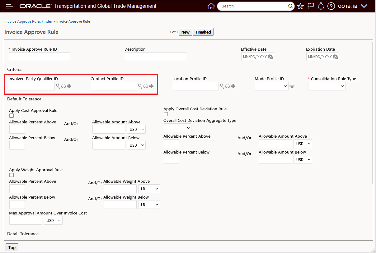

This feature adds additional criteria, Involved Party Qualifier and Contact Profile to the Invoice Approve Rule, allowing you to further refine the Invoice Approval Rule that will be used when approving invoices. You will find this feature particularly useful in configurations where you have a shared service for multiple customers configured in a single domain, and you have customers in that shared domain who require different criteria for invoice approvals - e.g., different Allowable Percents Above/Below or different Detail Tolerances.
In the Invoice Approval Rule screen below the new Involved Party Qualifier and Contact Profile fields are shown.  This allows you to define a specific Involved Party Qualifier and Contract Profile for matching the Invoice Approval Ruler when the Invoice Approval Process is run.  The combination of Involved Party Qualifier and Contact Profile allows you to easily setup Invoice Approval Rules that apply to one or many of your customers in your shared domain.
Invoice Approval Rule UI

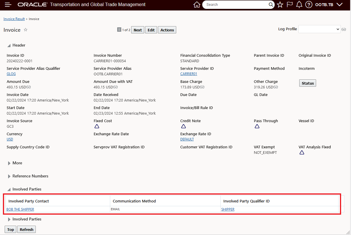

Given the invoice below - with the involved Party Qualifier value of Shipper and Involved Party value of Bob The Shipper, the Approval Rule in the image above will match and will be the Invoice Approval Rule used.
Sample Invoice with Involved Party and Contact Defined

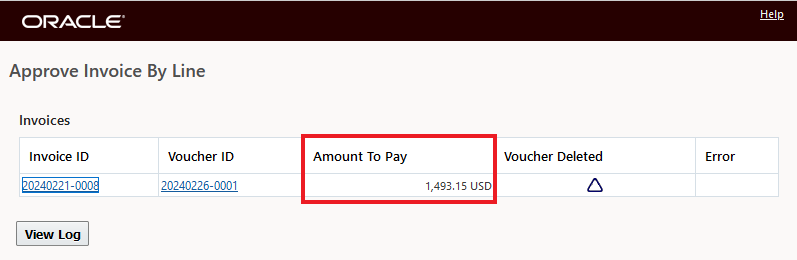

The total shipment and invoice amounts are provided below.  If the Amount to Pay for the first Base cost of 70.00 is increased to up to 74.00 USD, the invoice  be approved, as shown below.
Intial Approval Amounts
Initial Approval Amounts

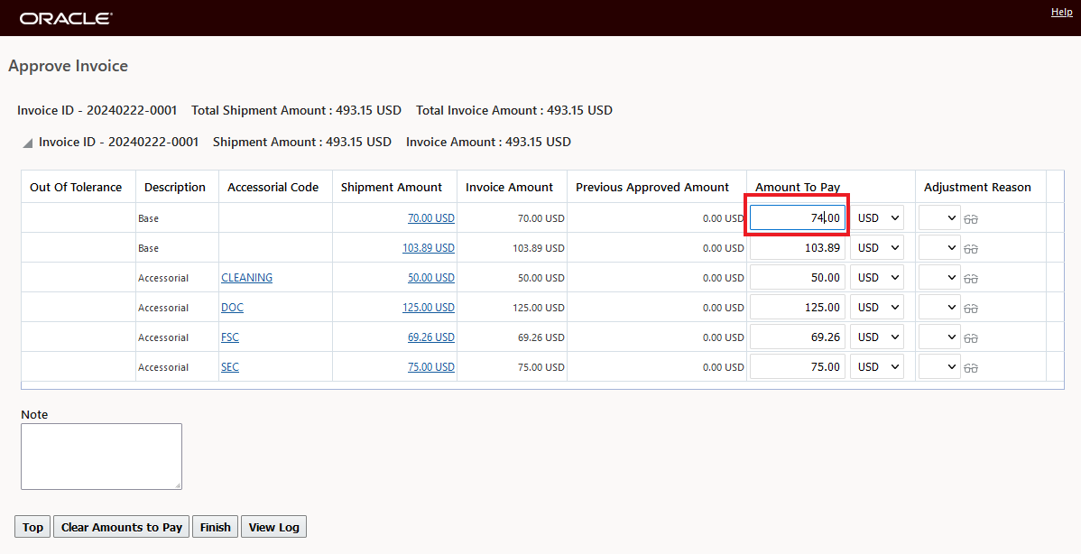

Increasing the Base amount by 4.00 USD to 74.00 USD will still allow the invoice to be approved - as shown below.
Base Cost for 70.00 Increased to 74.00 USD

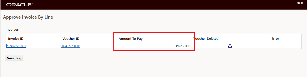

After increasing the value and selecting Finish the invoice is approved.
Invoice Approved with additional 4.00 USD Added Total Approved 497.15 USD - Original Invoice 493.15
Invoice Approved with Additional 4.00 USD Added Total Approved 497.15 USD - Original Invoice 493.15 USD

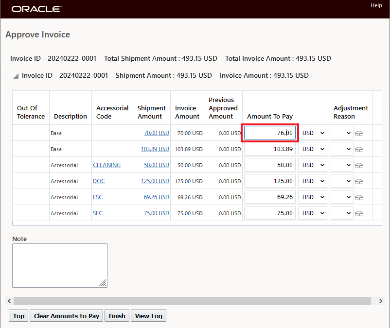

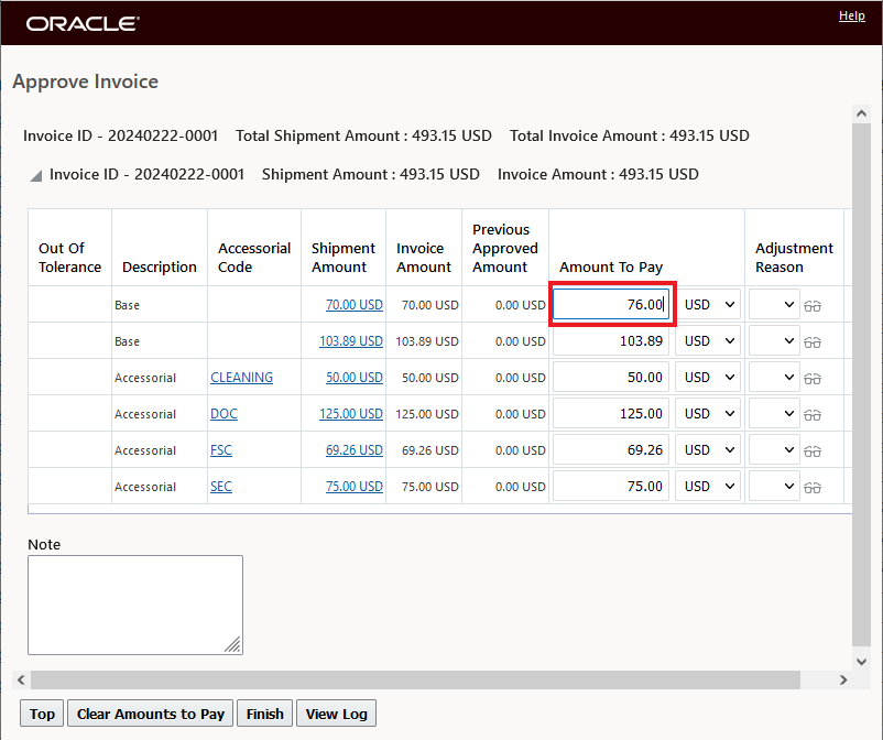

Using the same scenario as above, but this time with the amount of the first Base cost increased to 6.00 USD, the invoice will not be approved, as shown below..
Base Cost for 70.00 USD Increased to 76.00 USD

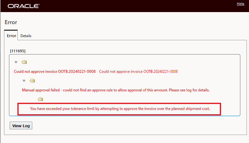

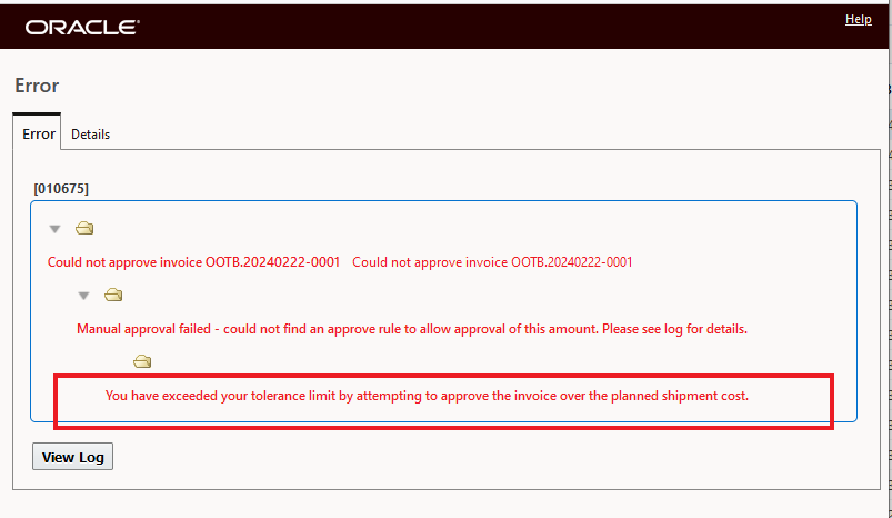

After increasing the value and selecting Finish, the invoice is not approved, as shown below.  In this case the Allowable Amount Above limit defined on the Invoice Approval Rule (5.00 USD) has been surpassed with the increase from 70.00 USD to 76.00 USD.
Invoce Not Approved
Invoice Not Approved

After increasing the value and selecting Finish, the invoice is not approved, as shown below. Like before, the Allowable Amount Above limit defined on the Invoice Approval Rule has been surpassed with the increase from 70.00 USD to 76.00 USD.
Invoice is not Approved
Invoice Is Not Approved

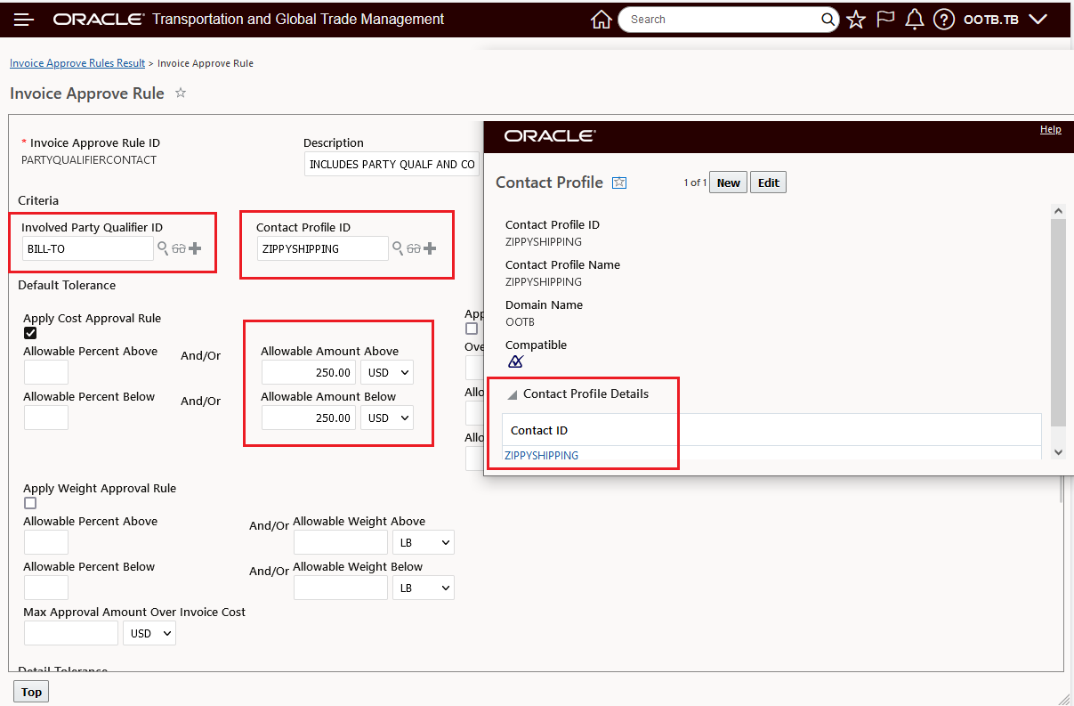

In the example below, in the same domain, an Invoice Approval Rule has been setup for the Involved Party Qualifier ID of Bill-To and with a Contract Profile of Zippyshipping which contains one Contact ID Zippyshipping.  This rule will be used for Invoice Approval when the defined criteria matches the Involved Parties  - Qualifier and Contact on the Invoice.  In this case, the Allowable Amount Above and Below is 250.00 USD.  The important point here is that in a single domain (OOTB) for different combinations of Involved Party Qualifier and Contacts - you can configure different Involve Approval Rules based on this additional criteria and more precisely determine the rule that matches.
Sample Invoice Approval Rule Setup

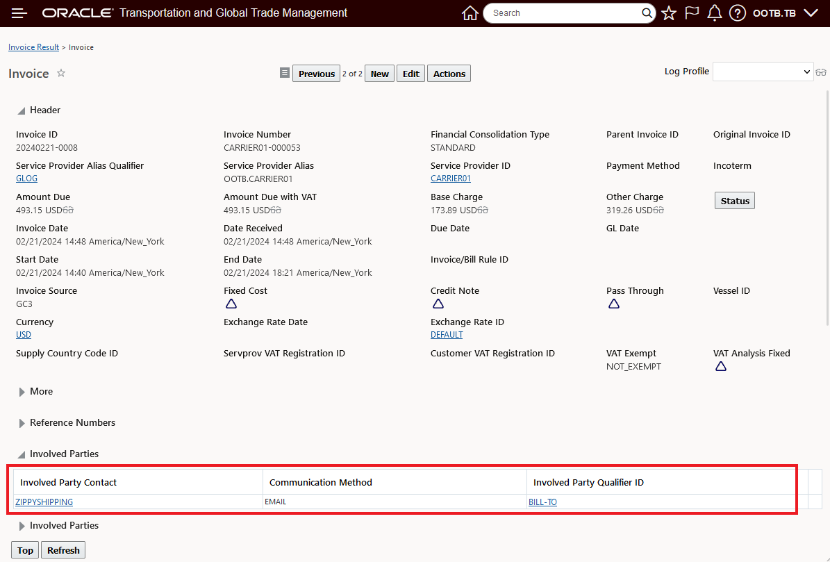

The invoice below has the Involved Party Qualifier of Bill-to and the Contact Zipplyshipping - this criteria will be use to match the to the Invoice Approval Rule defined above.
Invoice With Involved Party Contact Bill-to and Zippyshipping as Contact

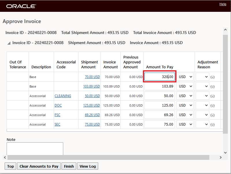

Similarly to the examples above, the first line Base cost will be increased from 70.00 USD to 320.00 USD - an increase of 250.00 USD which is the Allow Amount Above for the Invoice Approval Rule that will be used in this case.  The Invoice Approval Rule defined previously, with an Allowable Amount Above of only 5.00 USD is not being considered.
Base Cost Increased From 70.00 USD to 320.00 USD and Increase of  250.00 USD to 320
Base Cost Increased from 70.00 USD to 320.00 USD an Increase of 250.00 USD

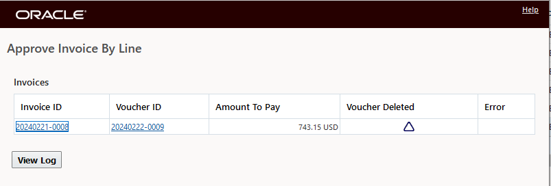

Based on the matching Invoice Approval Rule, the invoice is approved with the additional 250.00 USD added - as shown below.
Approved Invoice with 250.00 USD Added

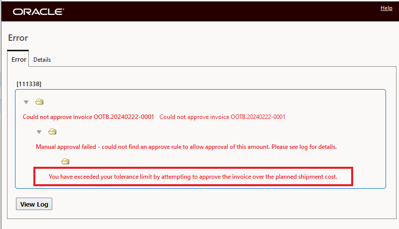

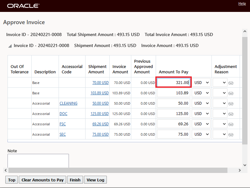

The same scenario as above, but in this case the amount is increased by 251.00 USD - over the Allow Amount Above of 250.00, in this case invoice is not approved.
Base Cost Increased from 70.00 USD to 321.00 USD and Increase of 251.00 USD
Base Cost Increased from 70.00 USD to 321.00 USD an Increase of 251.00 USD
After increasing the value and selecting Finish, the invoice is not approved, as shown below. The rule set for the Allowable Amount Above limit defined on the Invoice Approval Rule has been exceeded.
Allowable Amount Above Exceeded  - Invoice Approval Failed

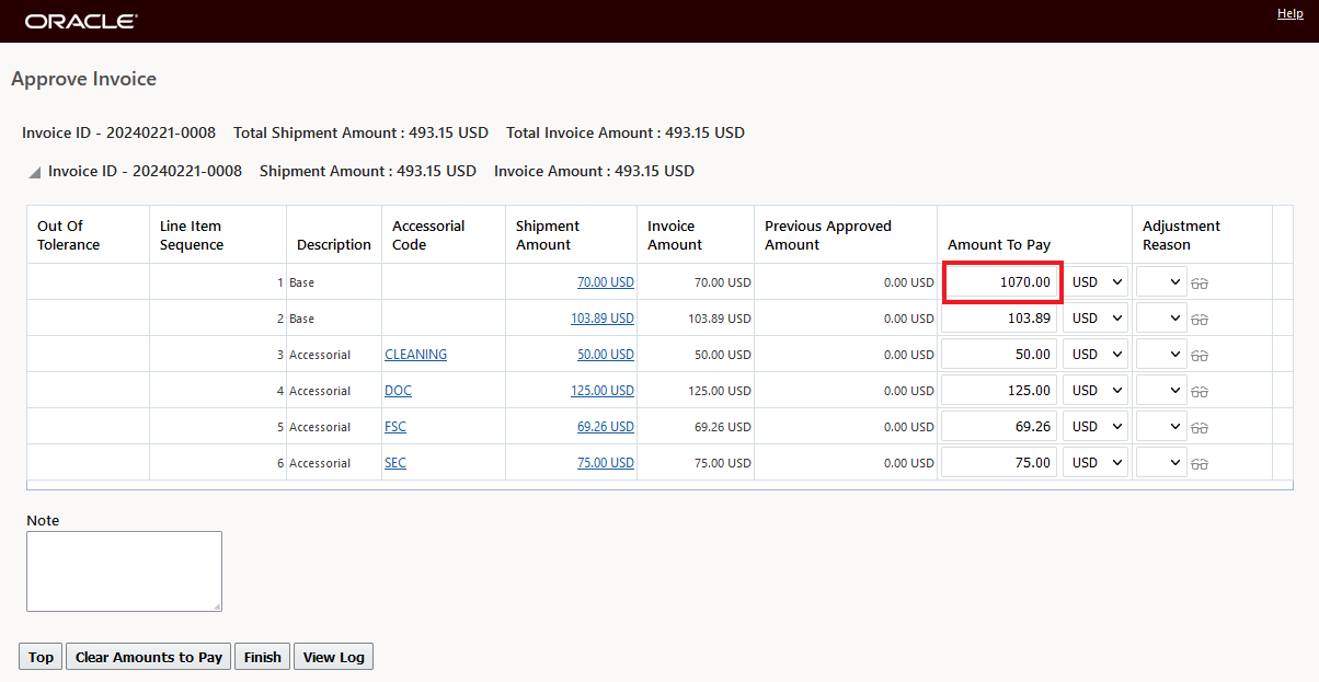

In this case the 70.00 USD Base mount is increased by 1000.00 USD, in this case - without the rules defined for Involved Party Qualifier and Contact, the available Invoice Approval Rule has an Allow Amount Above of 2000.00 USD.
Base Cost Increaed by 1000.00 USD to 1070.00 USD
Base Cost Increased by 1000.00 USD to 1070.00 USD
Based on the matching Invoice Approval Rule, the invoice is approved with the additional 1000.00 USD added - as shown below.
Invoice Approved With Addtional 1000.00 USD
Invoice Approved with Additional 1000.00 USD
