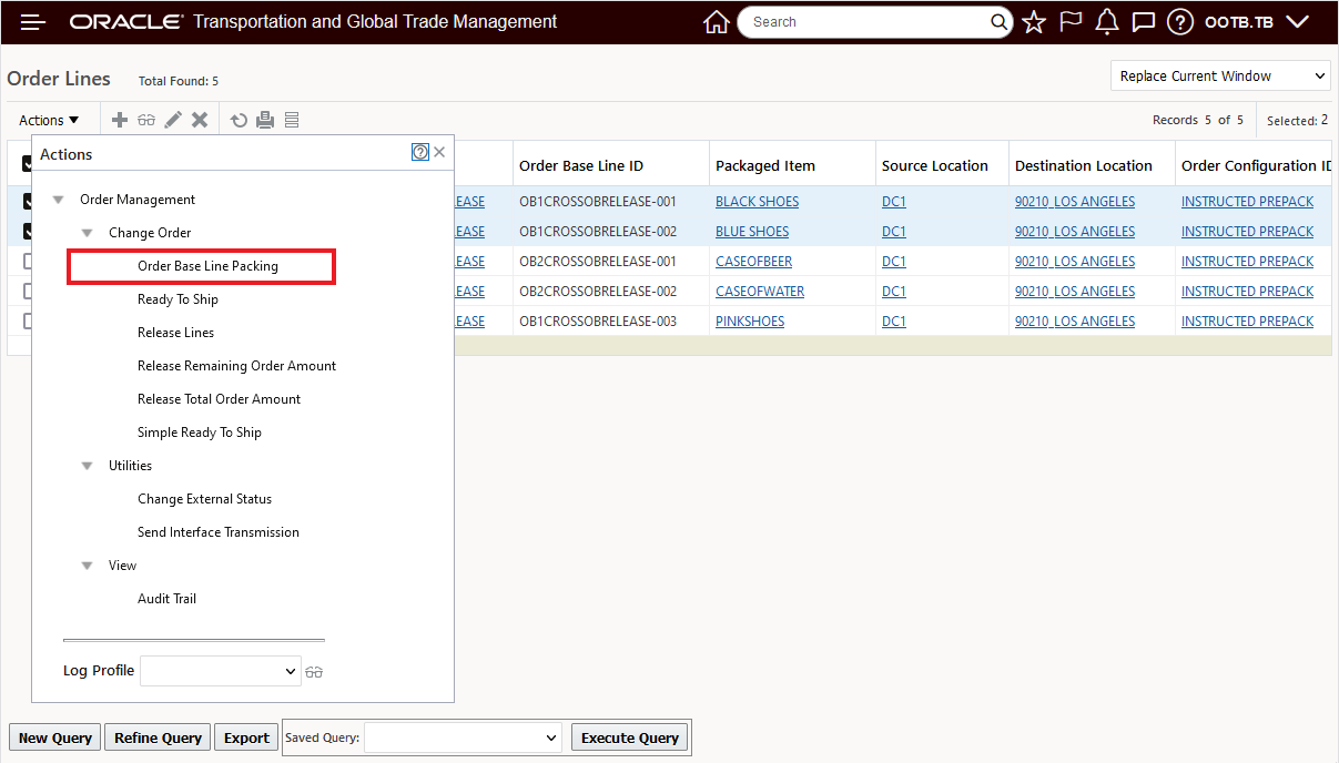

When the action Order Base Line Packing action is run, the order base lines selected when the action was run are displayed as available lines.   In the example, the example below two order base lines have been selected when the Order Base Line Packing action is run.

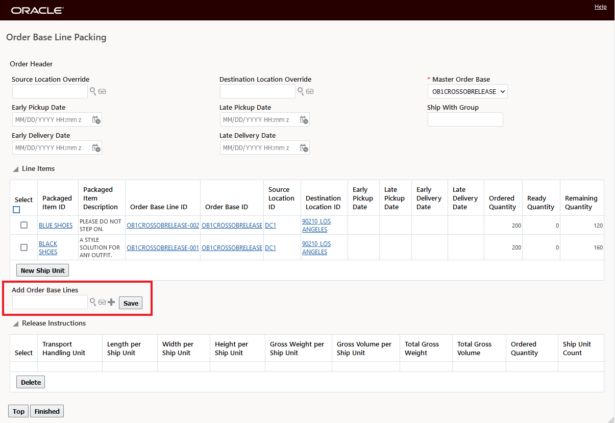

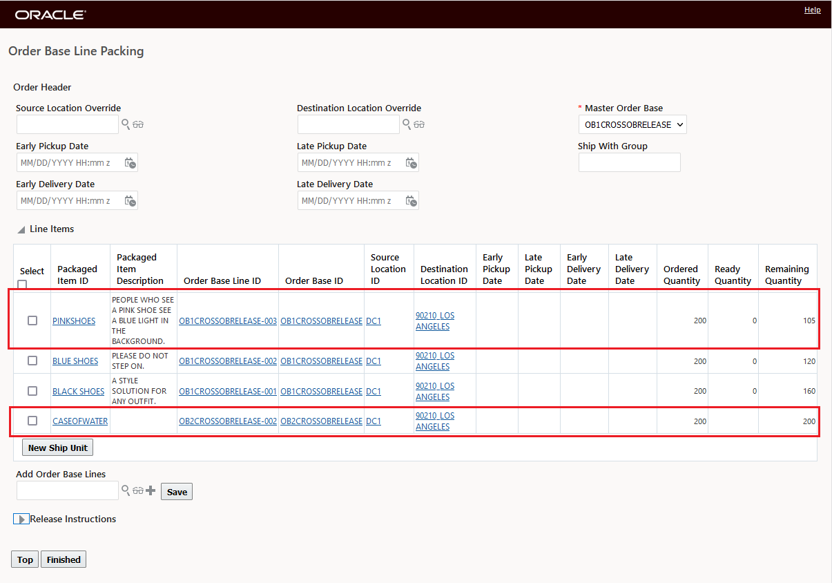

The Order Base Line Packing action input screen with the selected lines used to initiate the action is shown below.  Note the addition of the Add Order Base Lines finder.  The Add Order Base Lines finder provides you with the option to find and add additional Line Items to the list of available Line Items for packing and releasing.
Order base line packing action input screen
Order Base Line Packing Action Input Screen

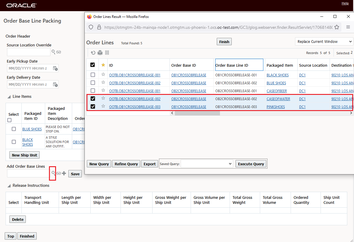

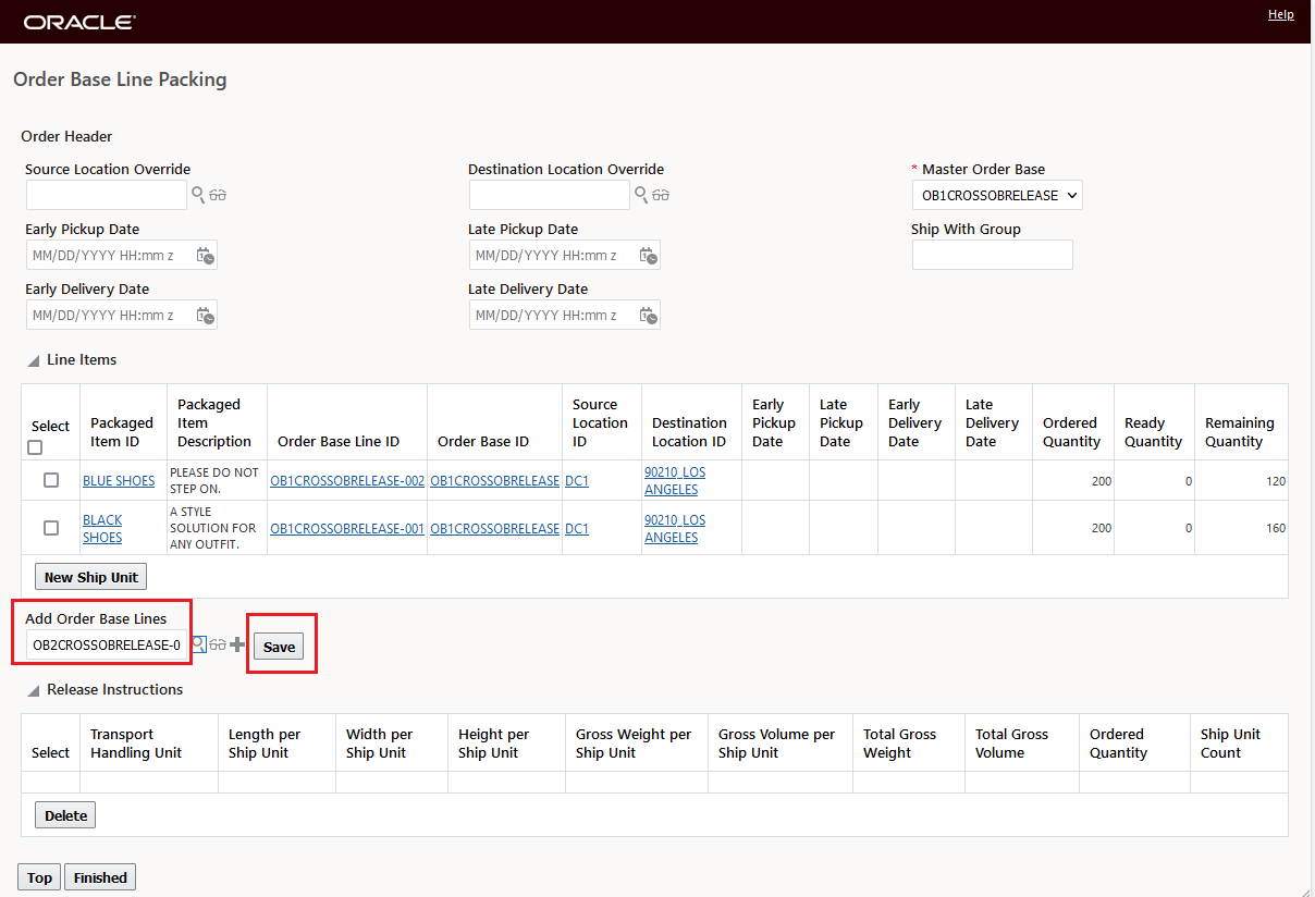

In the example below, the Add Order Base Lines Finder was used to find and select two additional order base lines to add to the list of Line Items.
Find additional order base lines
Find Additional Order Base Lines
Selecting Finish in the screen above, will add the selected order base lines to the list of order base lines that will be added when the save option is selected below.

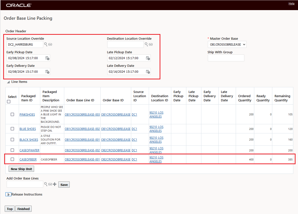

After selecting Save, the selected set of order base lines are added as shown below.

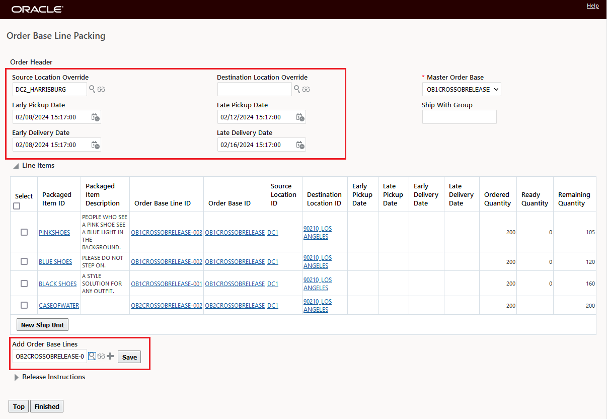

You can add Order Header information to the screen, like Overrides and dates as shown below, and then continue to add additional lines as necessary - and your entered data will be retained.
Order header info added - additional order base line selected
Order Header Info Added - Additional Order Base Line Selected
When the Line Items are added the entered Order Header info is retained as shown below.
Additional order base line added - order header additions retained
Additional Order Base Line Added - Order Header Additions Retained
