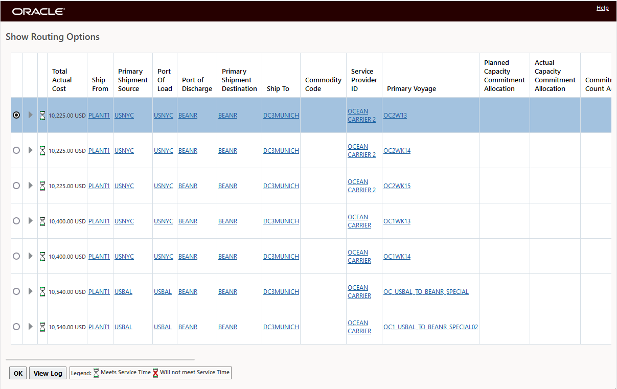

In the example below, the order being considered has multiple routing options, considering various ports of load (USNYC and USBAL) and voyage schedules.  With the Save Order Movements parameter set to Save All Order Movements without Building Shipments the actions Network Routing Options and Show Network Routing Options - Ocean will allow you to select the desired option and just create the desired Order Movements without building shipments.  In this example the Show Network Routing Options - Ocean  is being used.
Show network routing options, list of options
Show Network Routing Options, List of Options

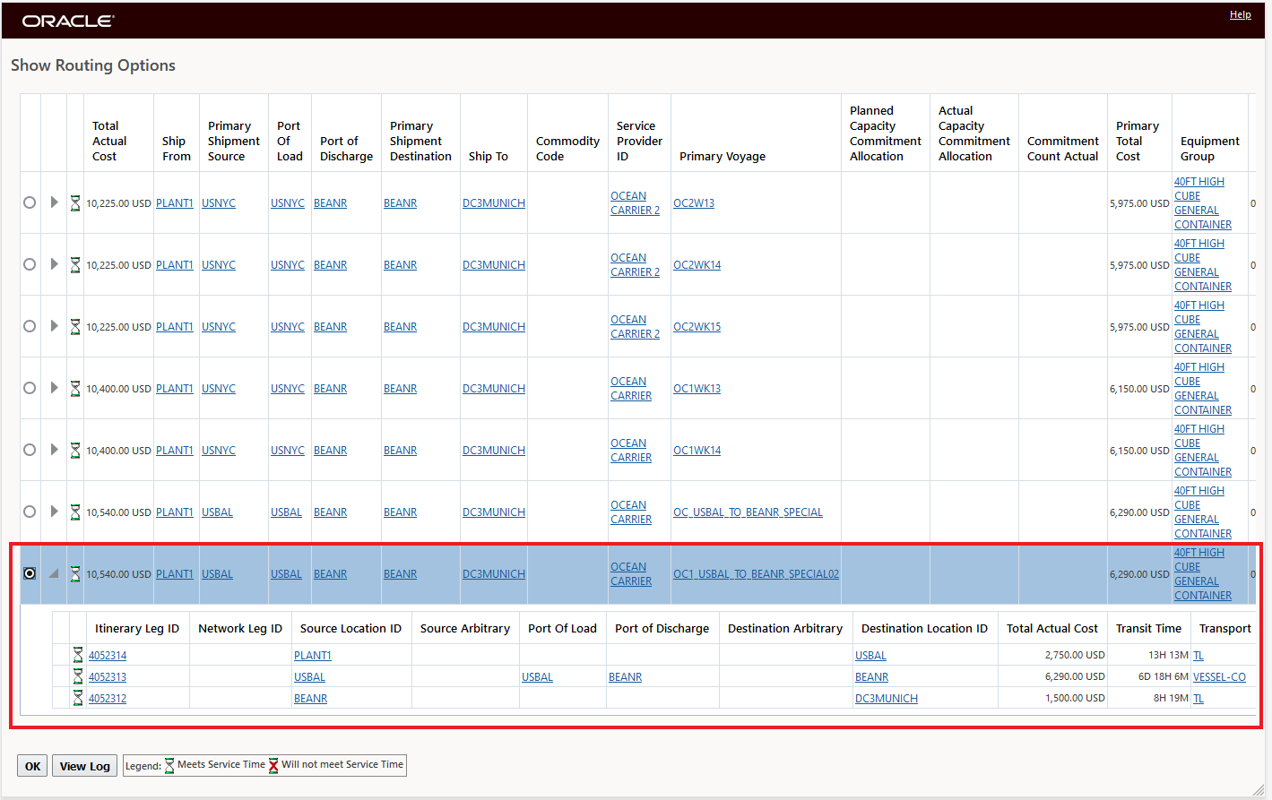

For demonstration purposes, the more expensive and later option out of USBAL will be selected, as shown below.
Option out of USBAL is selected, more expensive later option
Option Out of USBAL Is Selected, More Expensive Later Option

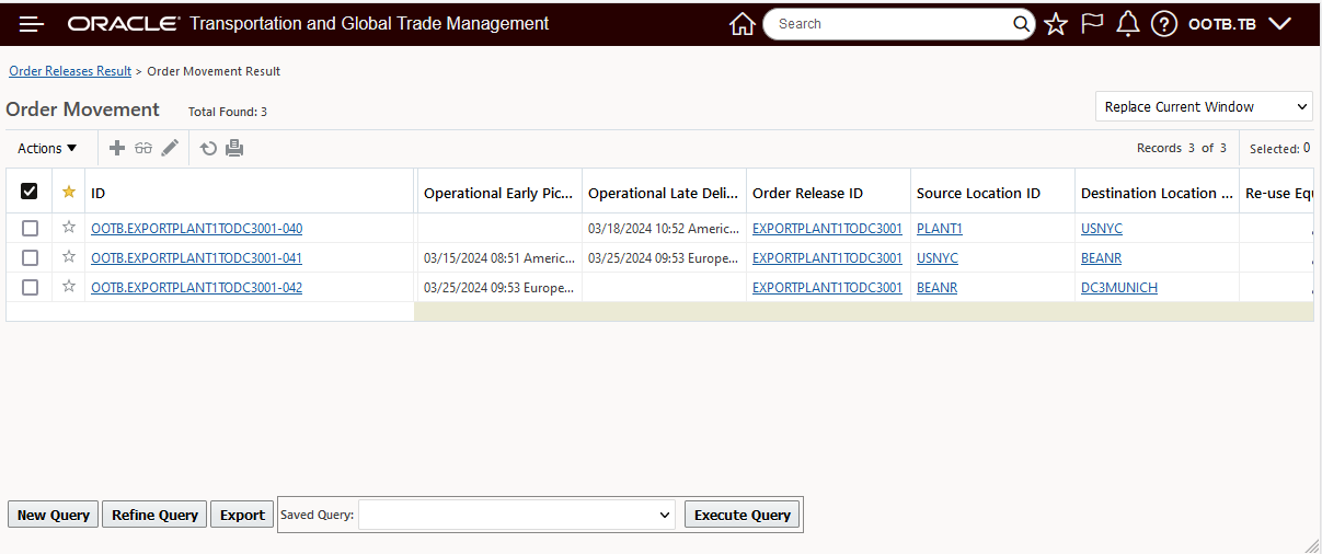

In this case, the selected option out of USBAL, will only generate the Order Movements, since the Network Routing Logic Configuration parameter Save Order Movements has been configured to only create the Order Movements.
Order movements generated by the selected option
Order Movements Generated by the Selected Option
Note that you still have the option of running a Bulk Plan to generate just the Order Movements - the actions and Bulk Planning use the same parameter.   In this case, the Bulk Plan will select the lowest cost earliest option - which is the first option in the list - shown below.
Option that will be selected by the bulk plan
Option That Will Be Selected by the Bulk Plan
