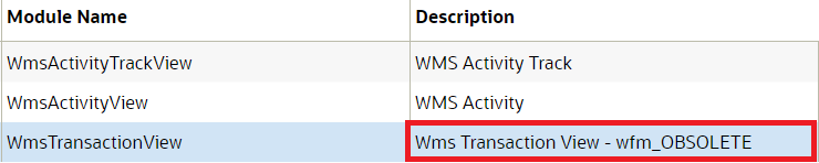

Deprecating the WMS Transaction View
As part of the deprecation process, we have suffixed the description of the module WmsTransactionView (Products = wfm) with _OBSOLETE as a warning and disabled the create, copy, edit, and delete buttons on the screens. However, if you create a new screen, _OBSOLETE will not be added automatically and CRUD operations are not disabled.
