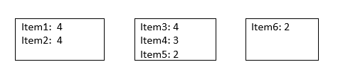

The current cubing feature of WMS employs an algorithm that relies on strict ordering and capacity checks. For example, a configuration which orders by item barcode, allowing for up to three distinct items per LPN and targeting an LPN type with a max volume of 10 would yield the following results:
Configuration by Item Barcode
Resulting LPN utilization:
  • LPN1: 80%
  • LPN2: 90%
  • LPN3: 20%
You will notice that a third LPN is required due to the algorithm preserving a strict ordering. By removing the requirement of strict ordering, the new cubing modes will now employ a constraint model that enforces a constraint “no more than three distinct items per LPN.”
No More than Three Distinct Items
  • LPN1: 100%
  • LPN2: 90%

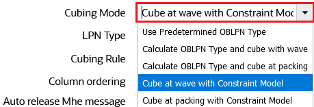

We’ve added two new values to the Cubing Mode drop-down field in the Wave Template UI. The values are:
  • Cube at wave with Constraint Model
  • Cube at packing with Constraint Model

In the Wave Template UI, set the Cubing mode value to ‘… with Constraint Model.’  This will enable constraint-based cubing, along with other regular cubing configurations (like the Cubing Rule/break by criteria and so on).
