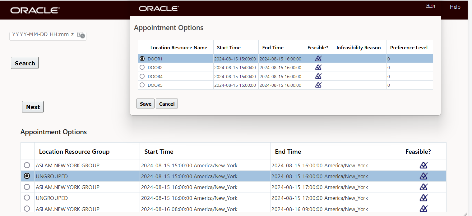

In the example below, the glog.appointment.workbench.filterLocResBasedOnApptRuleSet property is set to false, the default. In this case the list of Location Resources displayed is not restricted based on the assigned Appointment Rule Set.
Property Set to False - Default

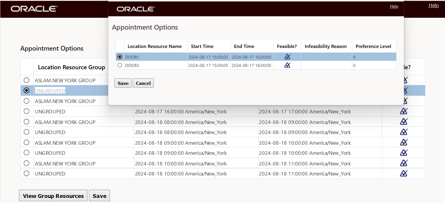

The same example with the glog.appointment.workbench.filterLocResBasedOnApptRuleSet set to true, and the appointment options provided are now limited based on the Appointment Rule Set.
Property Set to True
This feature reduces the set of resource options displayed to the set of valid resources improving both performance and usability.

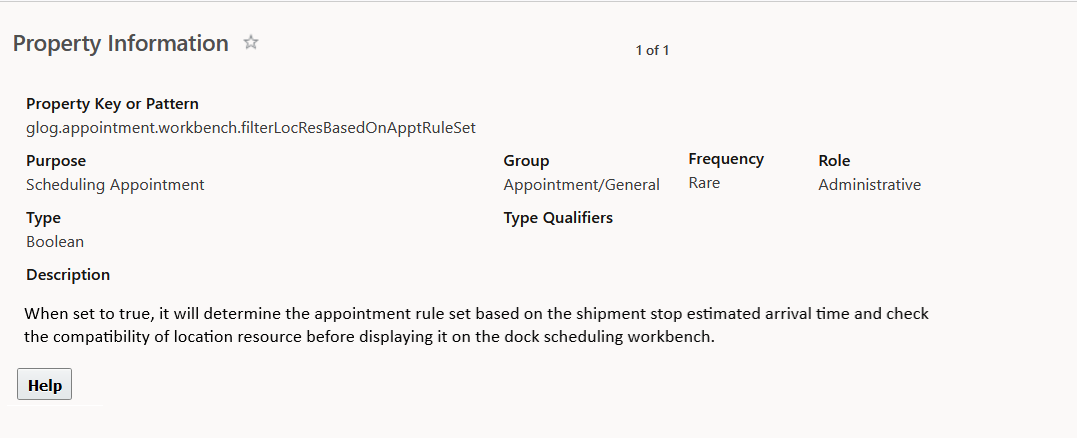

This feature is enabled with a property - glog.appointment.workbench.filterLocResBasedOnApptRuleSet - the Property Information is provided below and also is available in the Property Tree.
To set the property you will need to navigate to Configuration and Administration > Property Management > Property Sets.
NOTE: Only the DBA.ADMIN user can access and use the Property Sets page.
