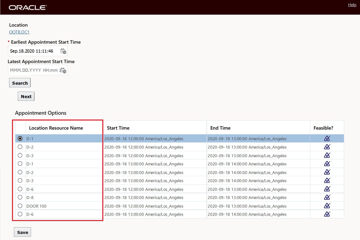

In the example below, no Grouped Resources have been configured, and the property - glog.appointment.showOptions.displayLocationResources has been set to true - in this setup, as shown, you have visibility to the Location Resources without having to select a group and then select the View Group Resources option to view the Location Resources in the selected group.
Ungrouped Resources Location Resources shown

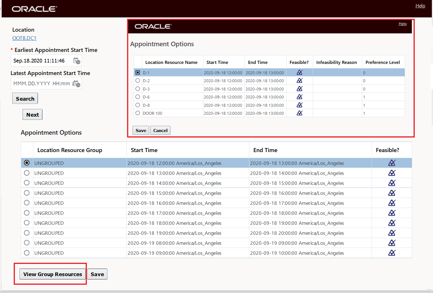

In the example below, the property is set to the default value of false - the previous behavior. In this case, even though the Location Resources are not grouped, you must select a group and then select View Group Resources to see the Location Resources.
Previous behavior - View Group Resources required to see Location Resources
