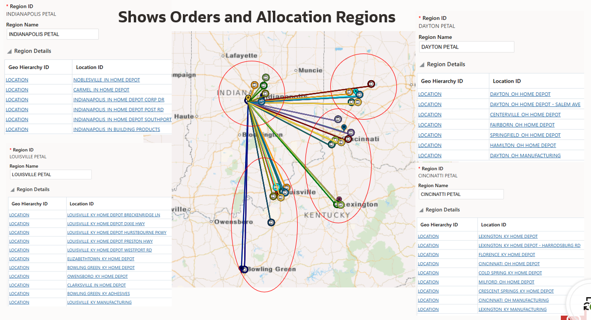

This example shows a DC in Indianapolis and 4 distinct allocation petals.  The multi-stop planning will plan with the cheapest carrier using the rate geography configured.  This creates a typical mult-stop shipment based on the rates.  When the workflow reaches Service Provider Allocation, then the carriers will be changed.  Shipments will not be re-planned nor stops re-sequenced.
Petals should NOT overlap. That is why these are done by location.
Map of All Orders for Most Distant Allocation Enhancement

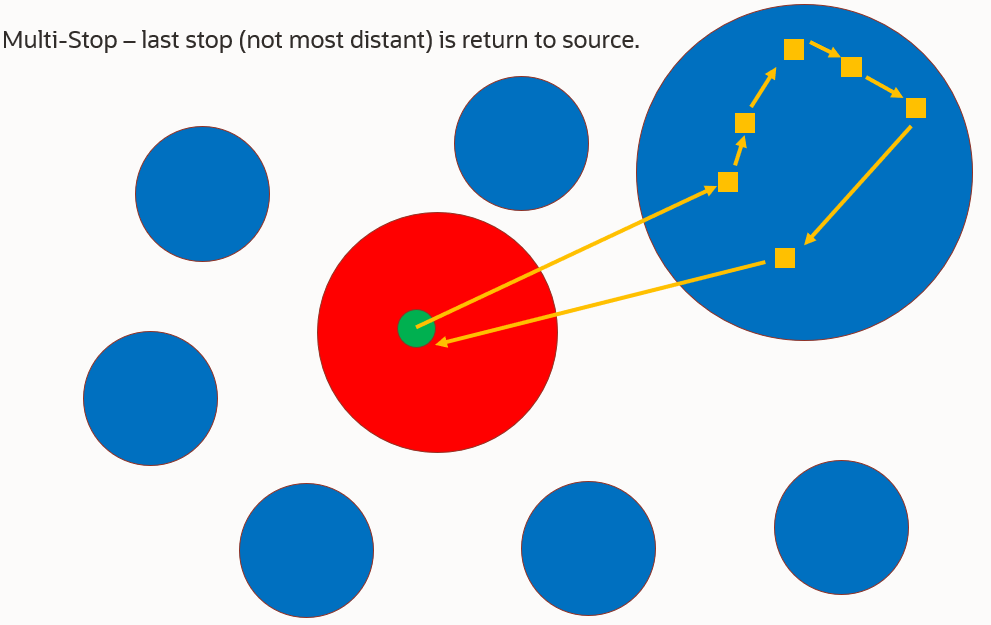

The logic will always look for the most distant stop.
Example of Round Trip

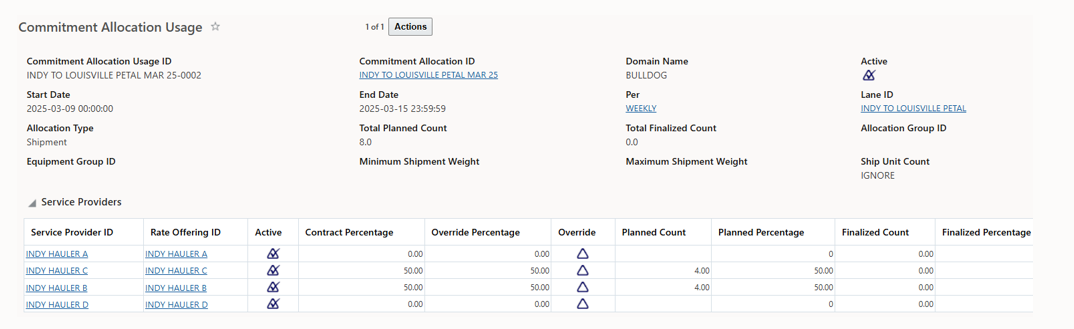

Each allocation is to be configured as before.  There are no changes with this step.  The Allocation Usages are then created for the logic to use. The only caveat is that the lanes are not traditional lanes but are ones to work with the enhancement and are based on the most distant stop.
Round Trip Allocation Usage

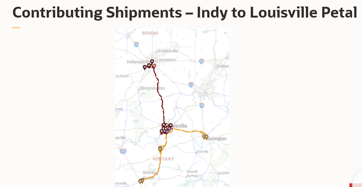

A mouse click on the usage record brings a list of the contributing shipments.
Round Trip Contributing Shipments

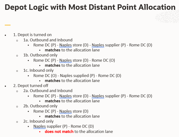

Depot Configuration is also part of this logic.  This chart explains the participation of depots.
Round Trip with Depot
