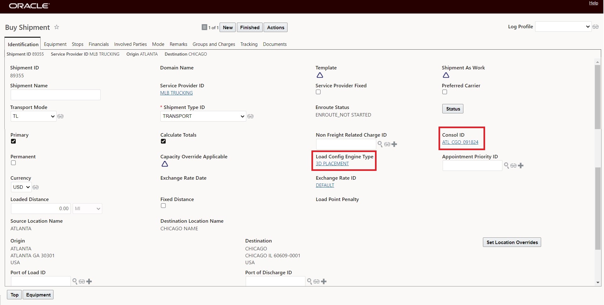

In the example below, the Ground Consol Shipment has been planned with 3D Based Load Configuration setup.
Ground Consol with 3D Configured

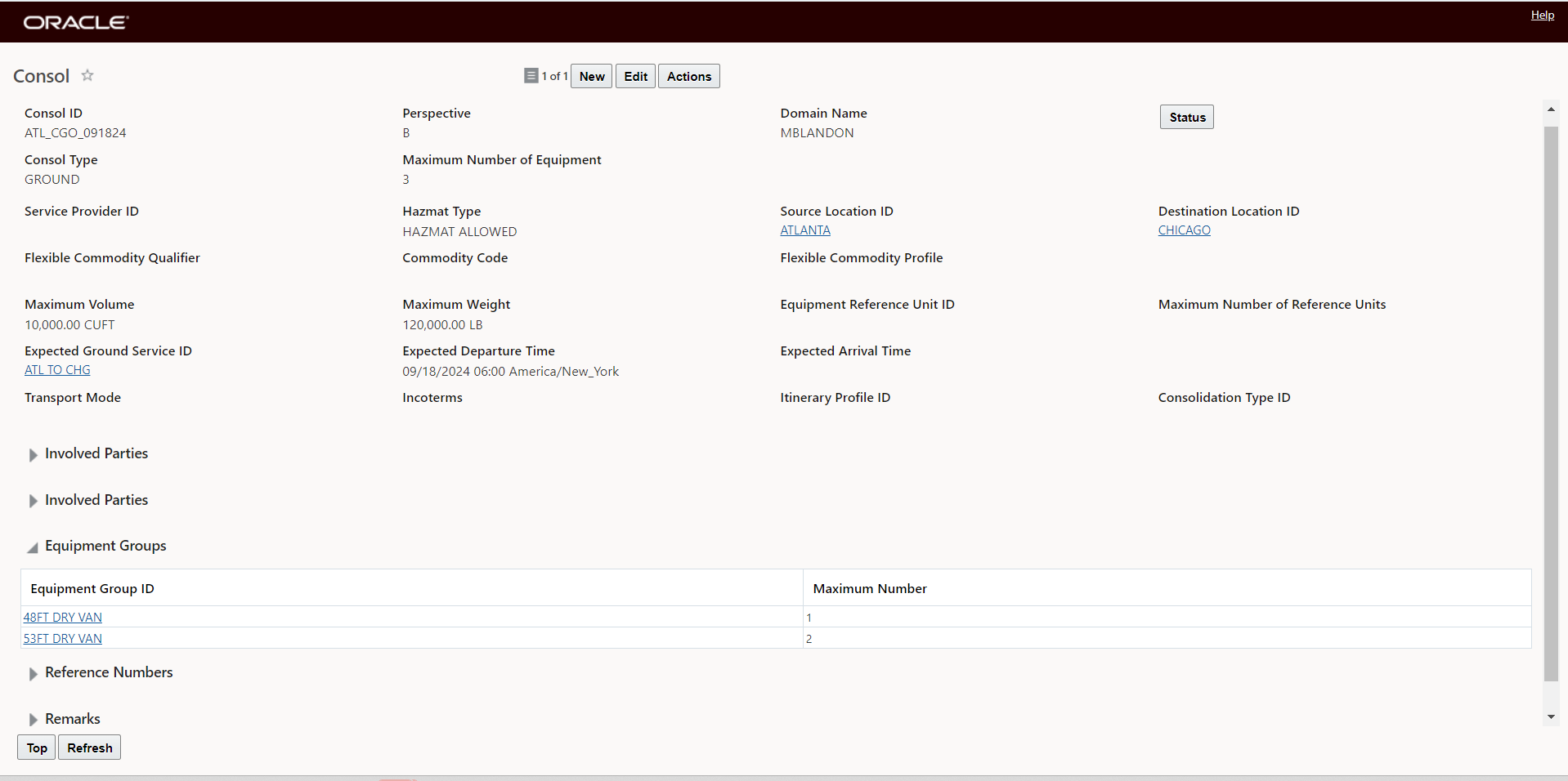

The Ground Consol related to the shipment above is provided below.
Ground Consol Setup
Ground Consol Setup

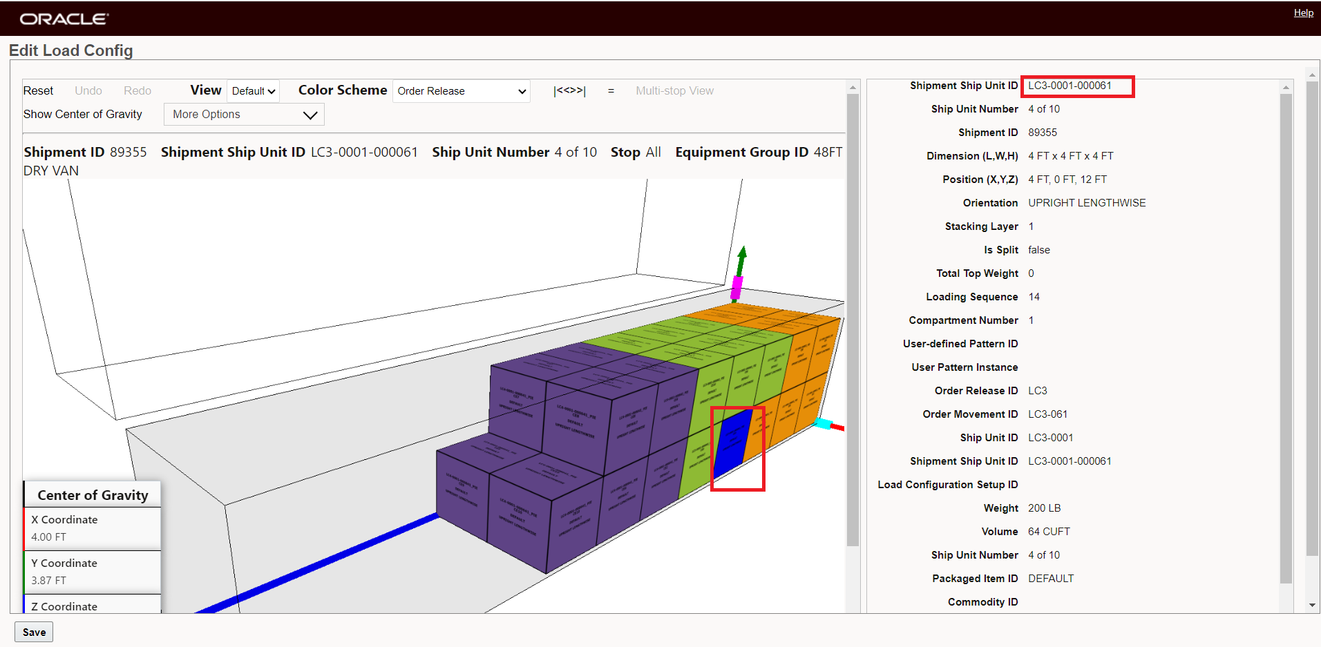

In the example below, there are four orders to be planned.  In the first Bulk Plan run three orders are planned and are loaded into the Ground Consol - as shown below.   In this example, the second order loaded in this plan is LC3 - as shown below.
Three Orders - First Ground Consol Load Config Solution

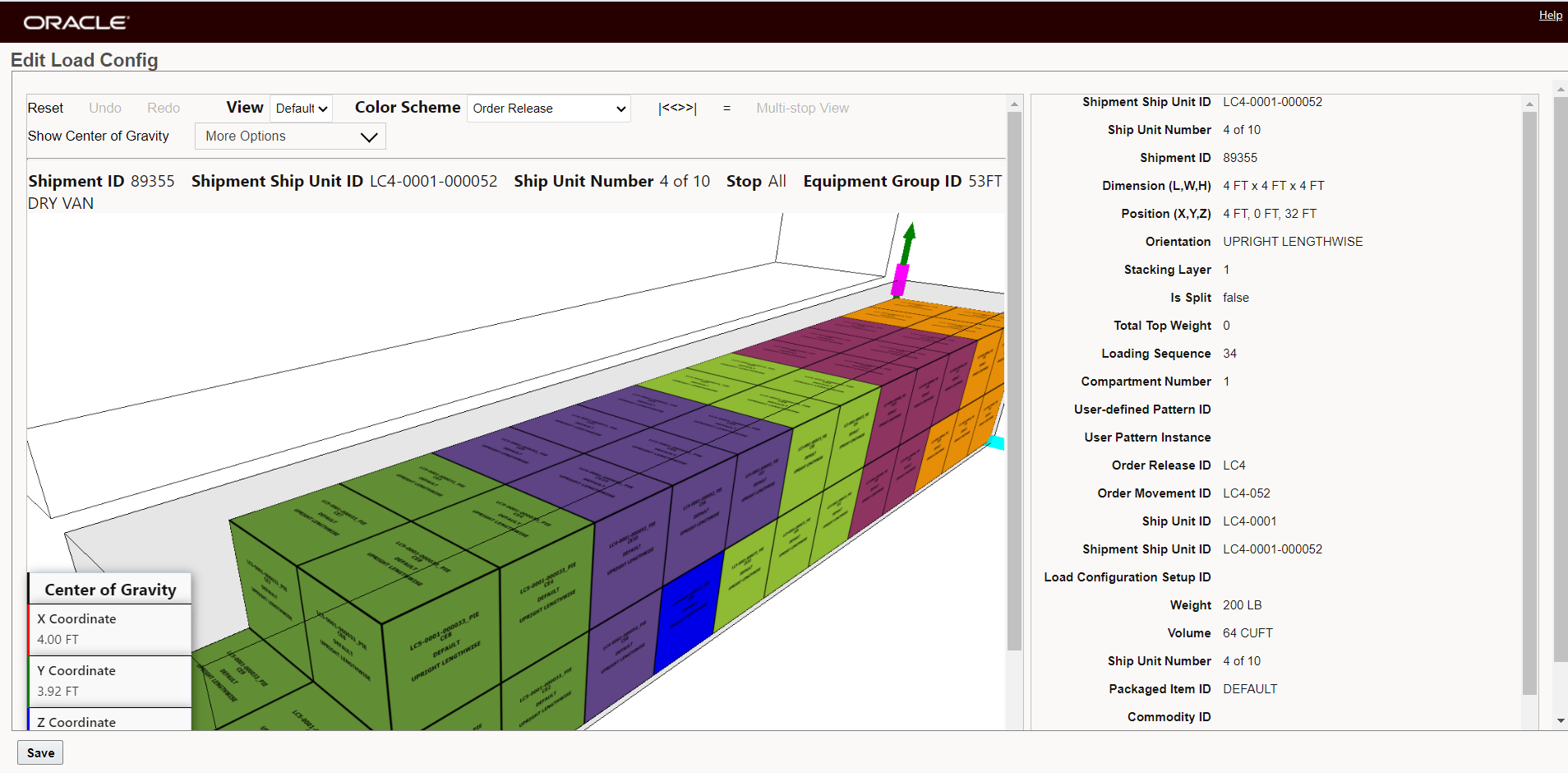

 In the second Bulk Plan run below, the same three orders from above have been included in the plan, plus a forth order - LC2.  Note below that in the second plan, considering the four orders, the fourth/new order included, LC2, is now occupying the position that LC3 occupied in the first solution (above), demonstrating the fact that plan reconsidered the placement of all the orders versus appending to the existing solution.
Four Orders - Second Ground Consol Load Config Solution
