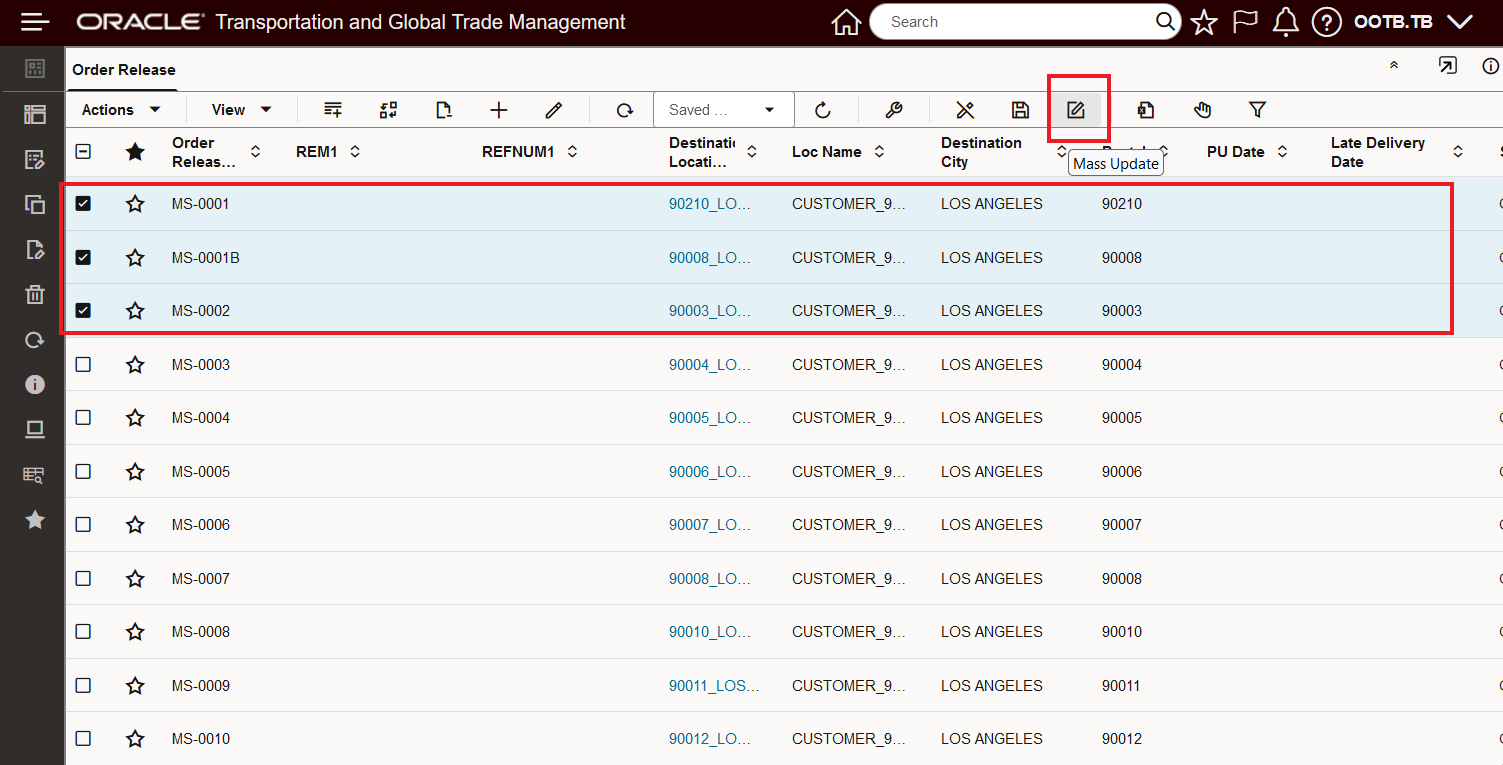

In the first example the configured Remark and Reference Number fields will be updated using Mass Update, three rows are selected and the Mass Update icon is selected to initiate the Mass Update.
Select and Initiate the Mass Update

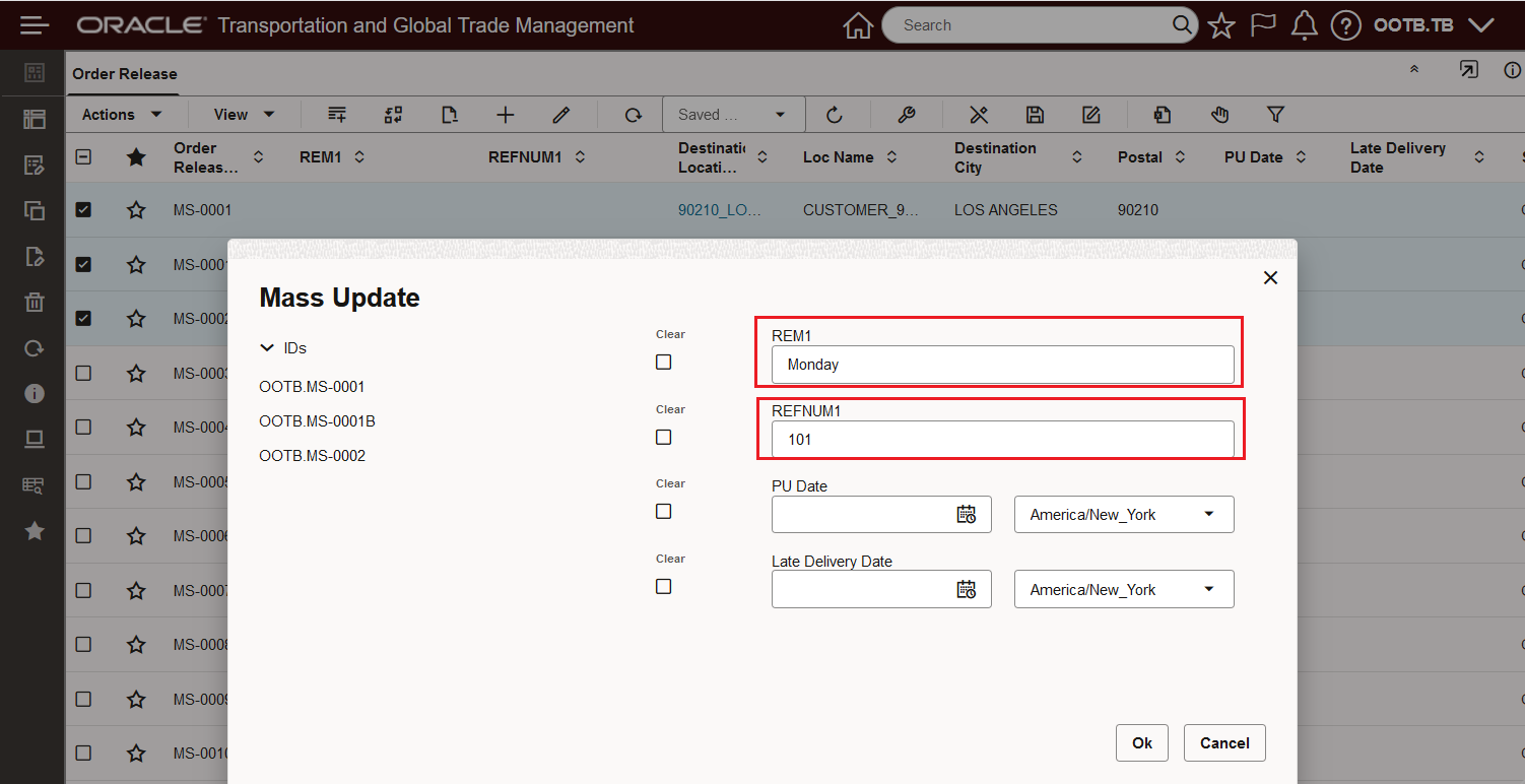

For this example, the REM1 field will be updated with the value Monday and the REFNUM1 field will be updated with 101 - as shown below.
Provide Mass Update Values for Fields to Update

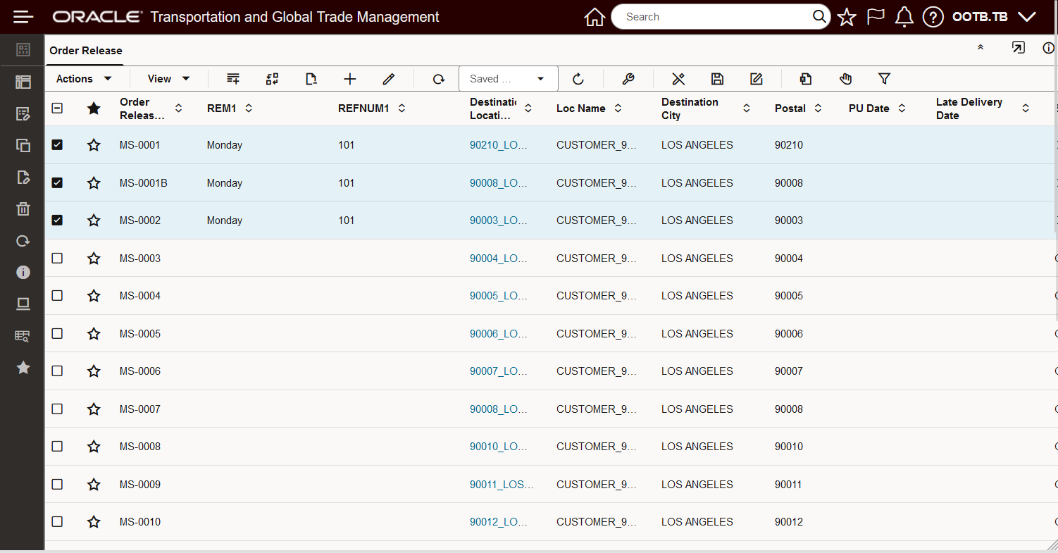

The result of the action is below, the selected rows have been updated with the Mass Update values.
Mass Update Result

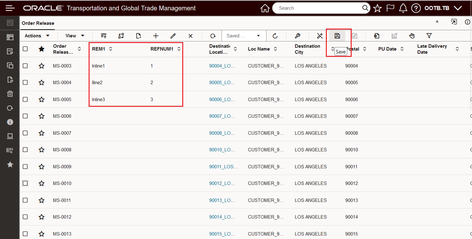

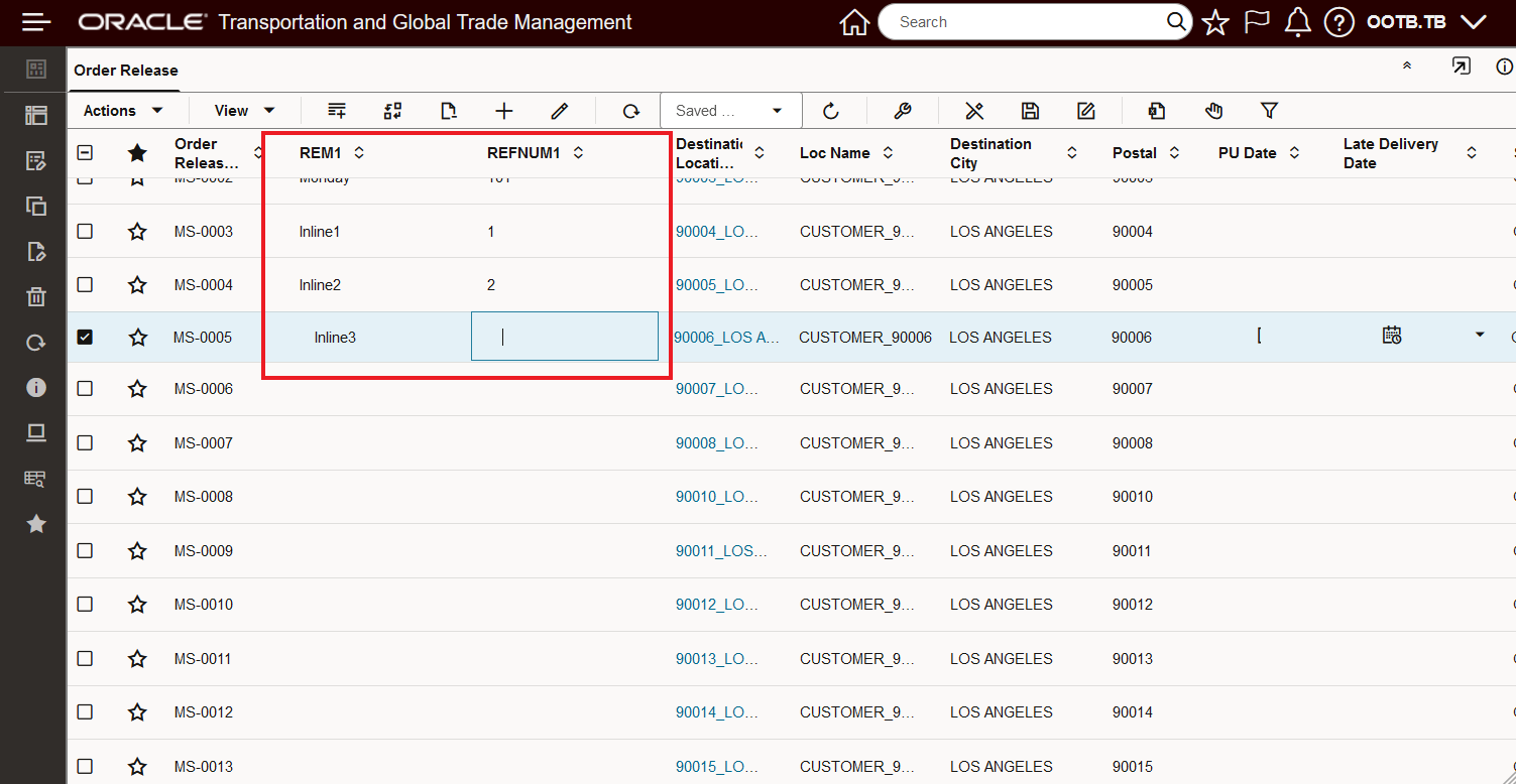

In the example below, the same fields REM1 and REFNUM1 will be updated with different values to demonstrate the Inline Editing capability.
In the first step you click into and enter the desired values - as shown below.
Inline Edit Desired Values for Inline Editable Fields
When you have completed your Inline Edits, select the Save Icon as shown below.
Inline Edit Select Save

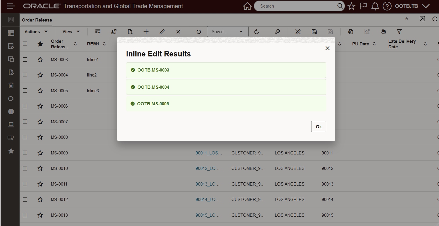

The Inline Edit Save will show the saved records once complete, as shown below.
Inline Edit Save Completed

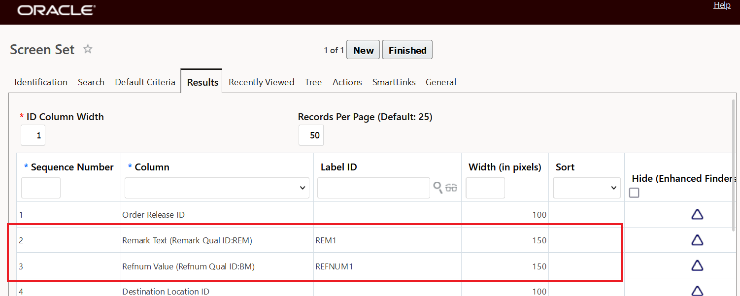

To take advantage of the newly enabled feature, the Screen Set configured in your Enhanced Workbench should be configured with the desired Pseudo Fields (Remark or Reference Number) and the configured fields should then be configured to support Edit.
In the Order Release Screen Set example below, the Remark field with Qualifier REM and the Reference Number (RefNum) field with Qualifier BM have been configured as Pseudo Fields on the Screen Set as shown below.
RefNum and Remark Fields Pseudo Fields Configured

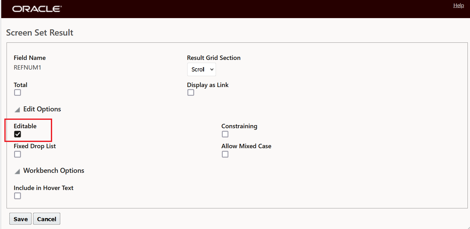

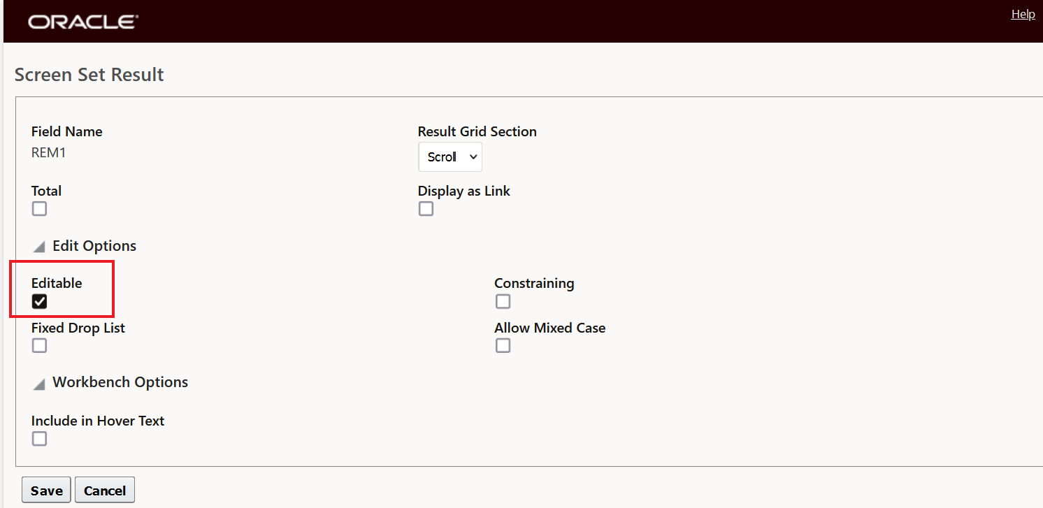

Then, for each of the Pseudo Fields, the Edit option has been selected, this will enable both the option form Mass Update and Inline edit.
Remark Field - REM1 - Marked as Editable
Refnum Field - REFNUM1 - Marked as Editable
