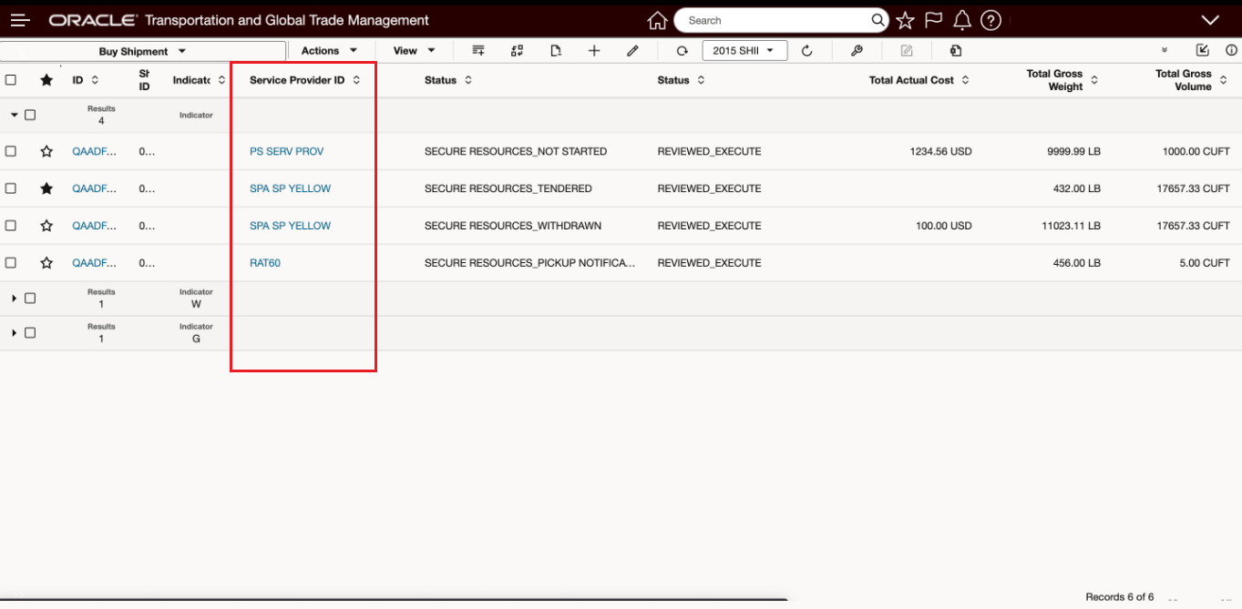

Your Saved Group changes are now supported by the Enhanced Workbench Personalization feature. In the example below, the original Saved Group is changed from Service Provider ID to Service Provider ID, Status - the changed Saved Groups selection used when you open this Enhanced Workbench again.
Originally the Enhanced Workbench is just Grouped By Service Provider ID.

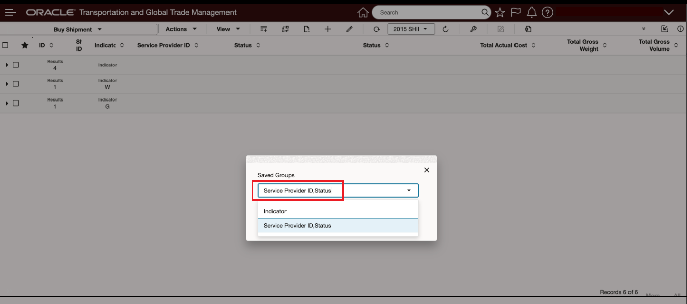

During the session, you change the Saved Groups to Service Provider ID, Status - as shown below.
Change Saved Group

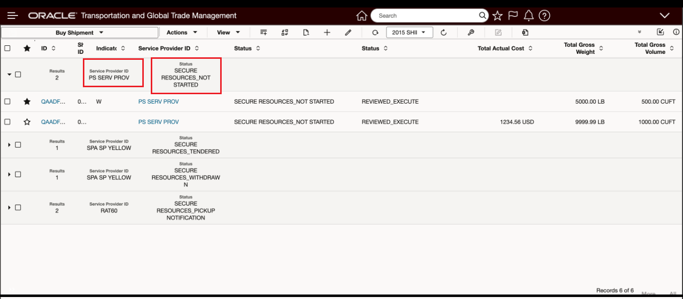

Now, the Saved Groups you selected in a session will be used the next time you open the Enhanced Workbench. In this case the Service Provider ID, Status Saved Group.
Saved Group From Previous Session Used

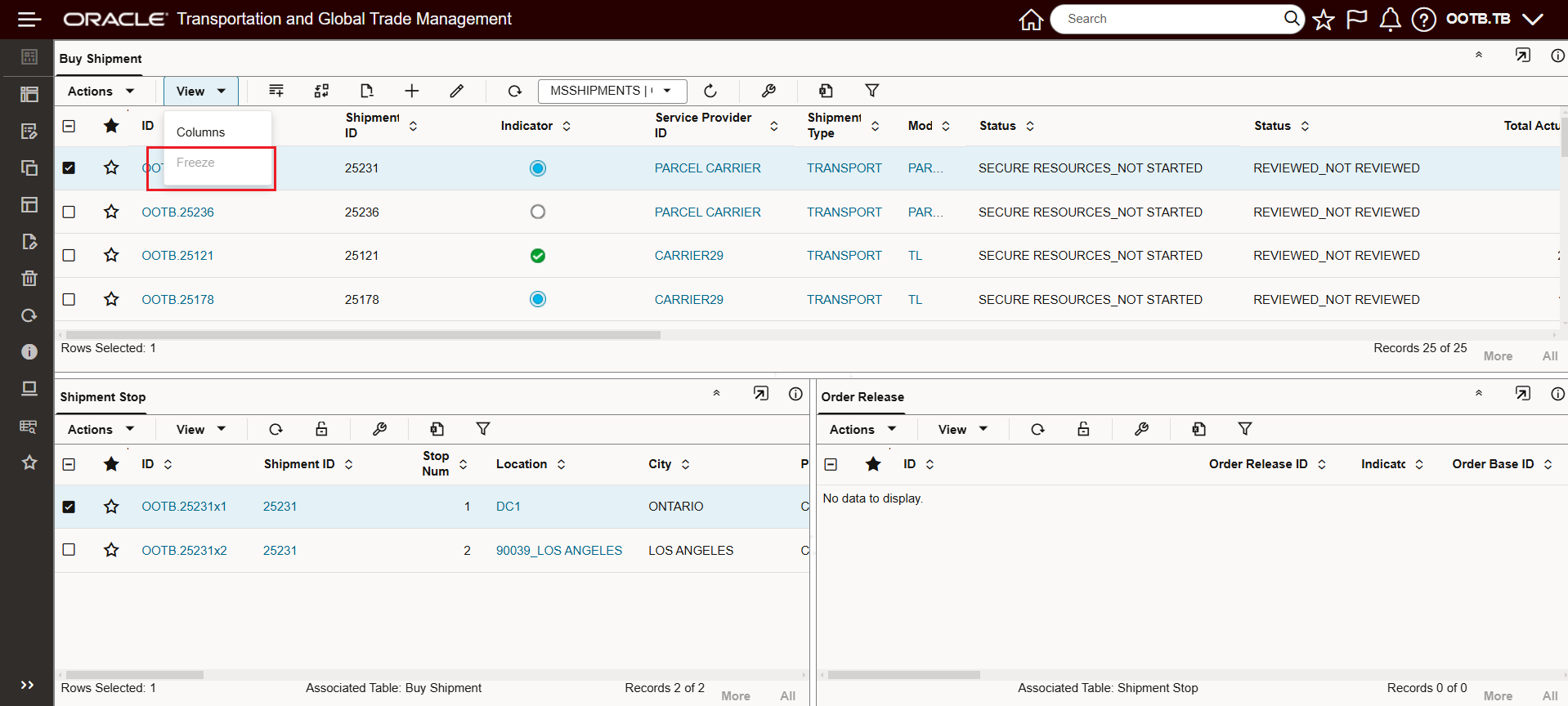

Freeze

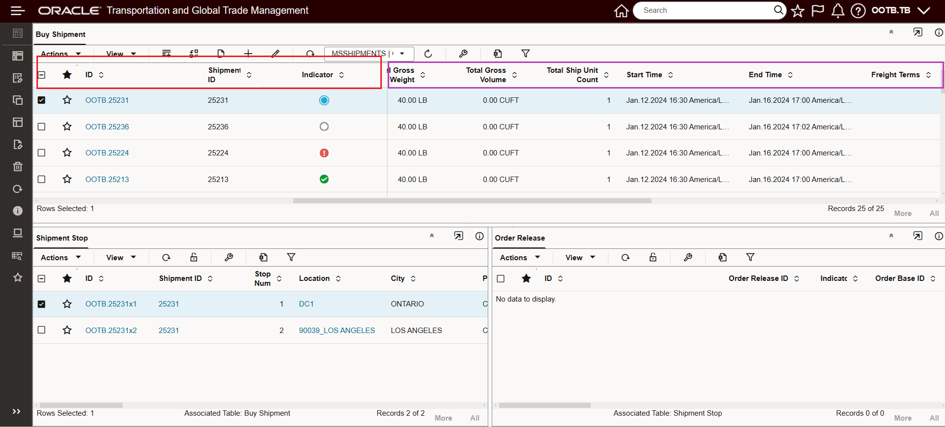

In the example below, the original Enhanced Workbench has no frozen columns.
Original Workbench No Frozen Columns

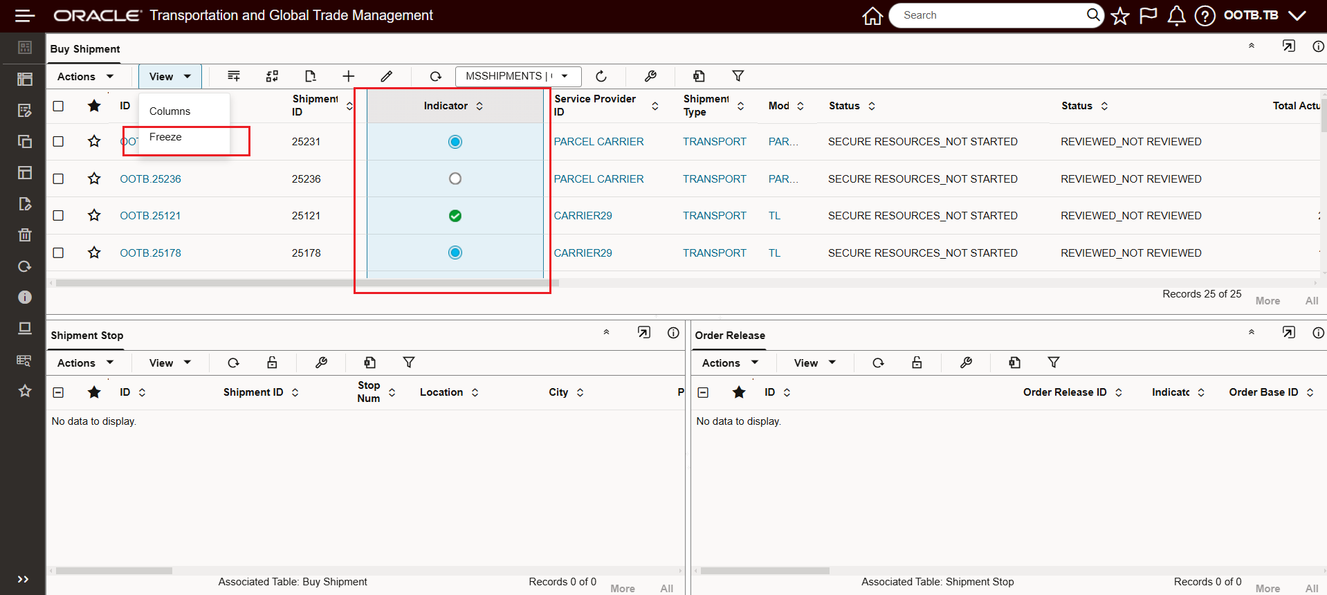

In the session, you Freeze the Buy Shipment table at the Indicator column, as shown below.
Freeze the Buy Shipment Table at the Indicator Column
When you return to this Enhanced Workbench, the Freeze selection of the Indicator column is retained - as shown below.
Frozen Selection - Indicator Column - Retained

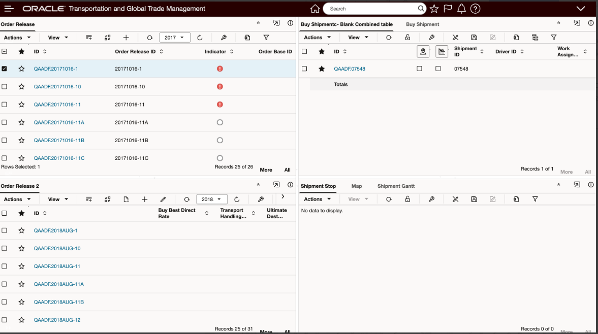

Grouped/Ungrouped

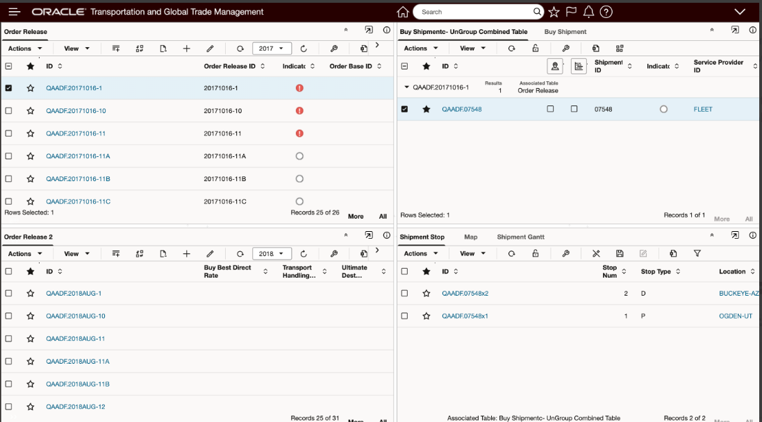

Grouped and Ungrouped Combined Detail Table work in the same way. Click on the master table, the combined detail table loads with the default setting.
Click on Master Table
Click on the group ungroup icon on toolbar. When you come back to the Enhanced Workbench layout and click on the master table you will see the combined table load with changed state.
Group/Ungroup Personalized
