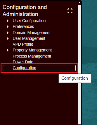

You can navigate to the new UI via Configuration and Administration > Configuration > Configuration and Administration Qualifiers.

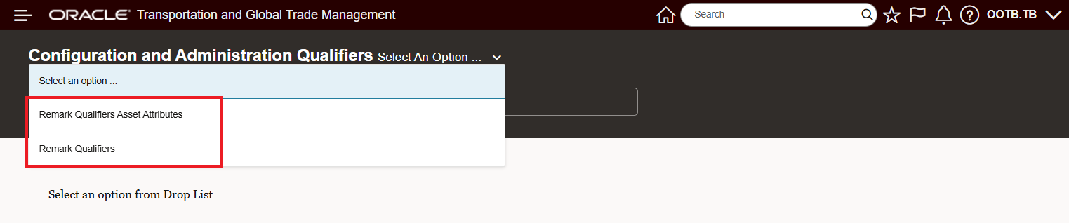

From the Configuration and Administration UI - select which Qualifier option you wish to work with - as shown below.
Configuration and Administration - Select Qualifier

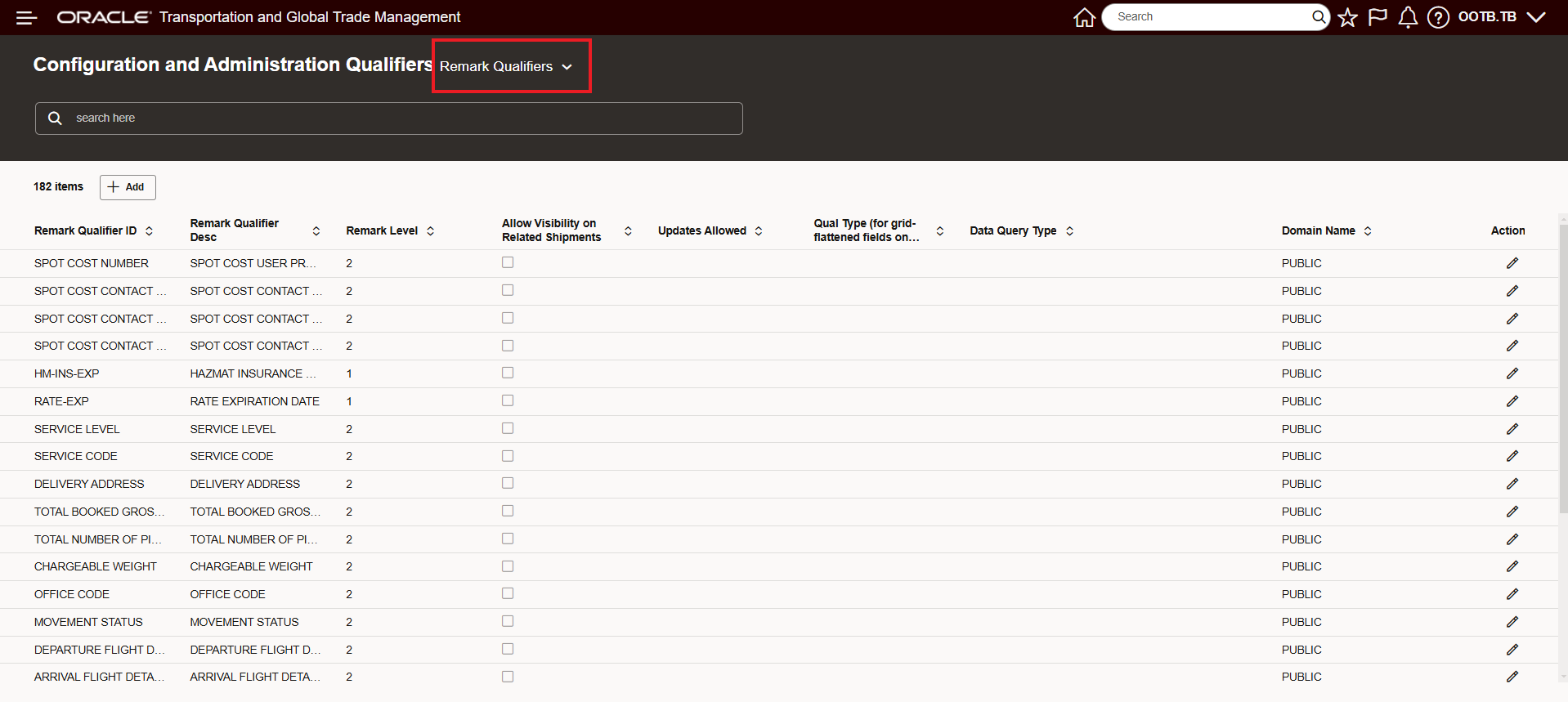

You will notice, that after selecting the Remarks Qualifier option that all of the available results are displayed - which is a change from the Finder and Finder Result pattern used elsewhere in the application.  This improved pattern starts with all of the available results returned and then allows you to simply filter the result set down to the list of results you are interested in.
Remark Qualifier Option Selected - Remark Qualifiers Returned

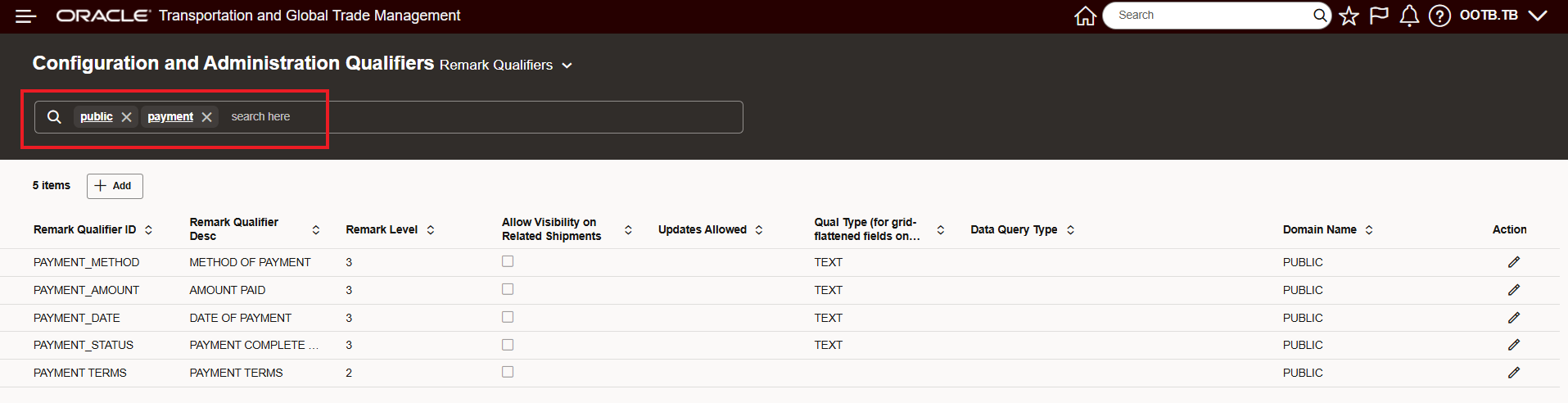

In the example below, only the Remark Qualifiers have been filtered down to the set that contains both public and payment.  This was accomplished by entering the search criteria public and payment in the Search. Note that the values entered for the Search are called Filter Chips and the condition between the filter chips entered is an AND, so the filter interpretation is public AND payment.
Multiple Filter Chips Public And Payment

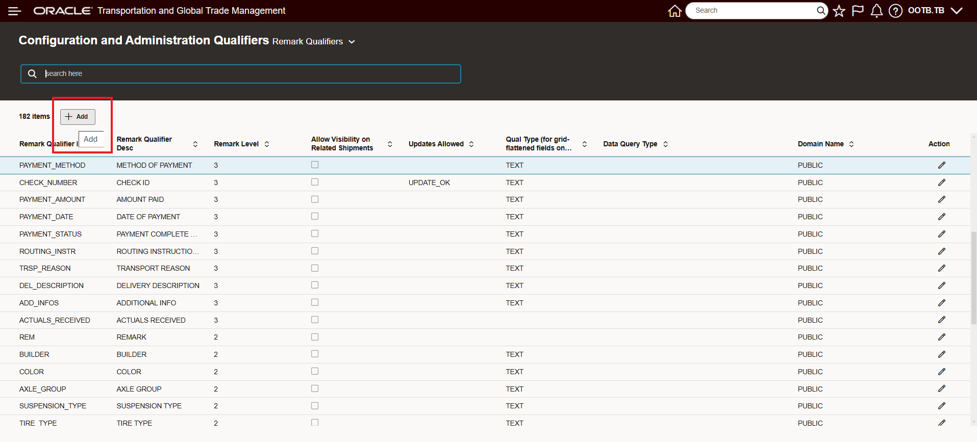

To Add a new record, you select + Add.
Select Add
Select Add

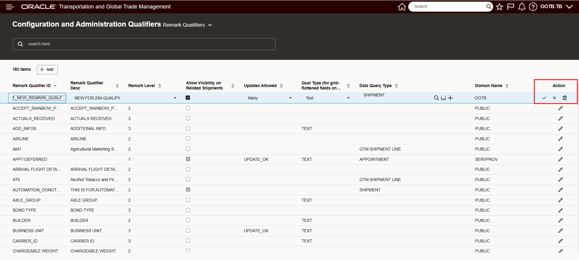

  After selecting + Add, a blank row appears, as shown below, which allows you to enter the information for the new record.
Add - New Record Entry Row Appears
After you enter your data for the new record, you select the Save and Close (check mark) to save the entry, or you can select the close option (x) to cancel the entry.
Add - Save and Close

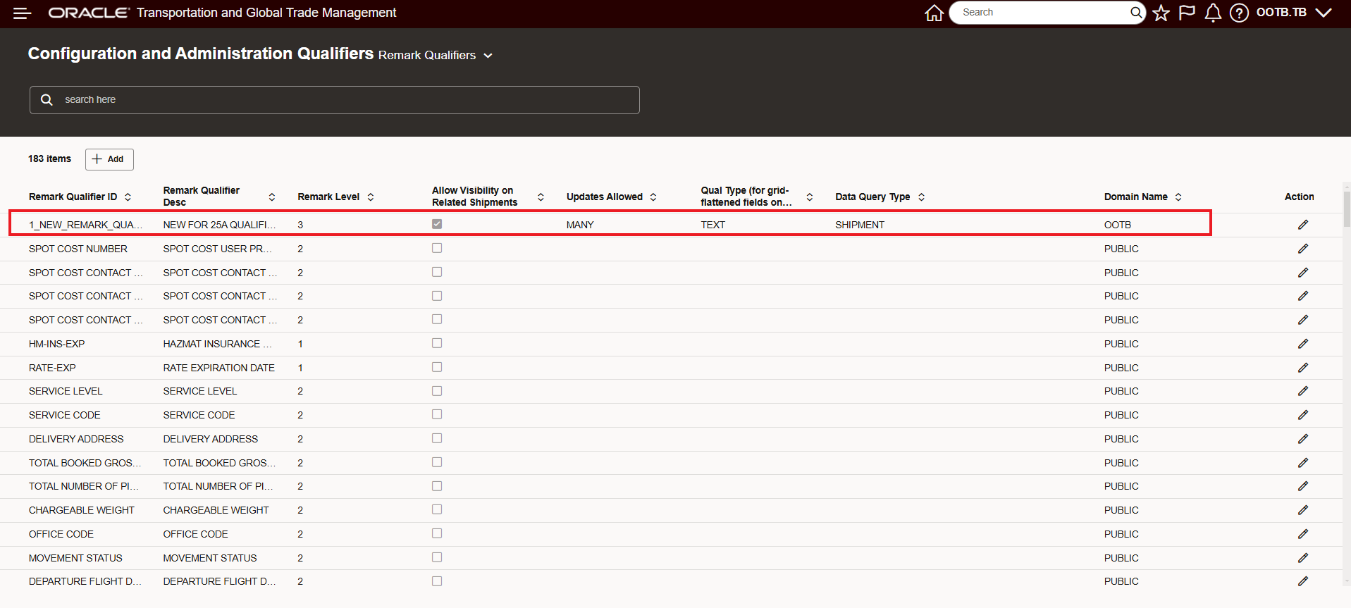

Below is result of the add entry performed above.
Add New Record Complete
The Pencil icon initiates the Edit process - the Actions available for Edit include - Save and Close (check), Cancel (x) and Delete (trash can), as shown below.
Pencil Edit Actions Save and Close, Cancel and Delete

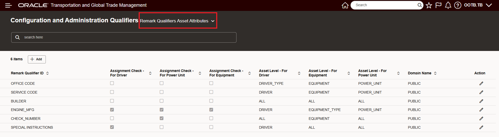

The same navigation described above for the Remark Qualifiers is available for managing your Remark Qualifiers Asset Attributes.  All of the available Remark Qualifiers Asset Attributes values will be shown when you select the Remark Qualifiers Asset Attributes option - as shown below.

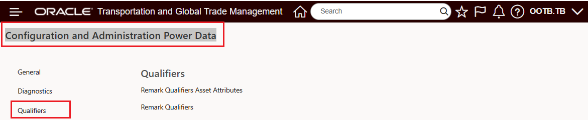

Note that the legacy Power Data screens for both Remark Qualifiers and Remark Qual Asset Attributes are still available via Configuration and Administration > Power Data > Qualifiers.
Classic Power Data
Classic Power Data
