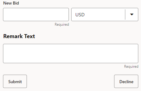

Below the New Bid field is a new Remark Text field where a Remark can be entered to be saved with the Bid.
Remark Text field
Remark Text field
