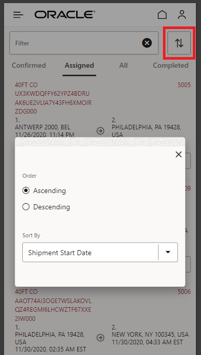

A button (up/down arrow icon) has been added next to the search box. On clicking the button, a dialog box with sort order(ascending/descending) and sort by options to choose from will be shown. The sort by option is a dropdown UI component with a default sort option of Start Date. Completed Shipments will have a default sort option of End Date. When you select a sorting order or sort by option, the shipment list will be sorted based on the selected options. You can change the default option for each Shipment type through the mobile layout.

The below screenshot shows the new sort button and the sort options dialog box for the Assigned Shipments tab that pops up when this button is clicked:
