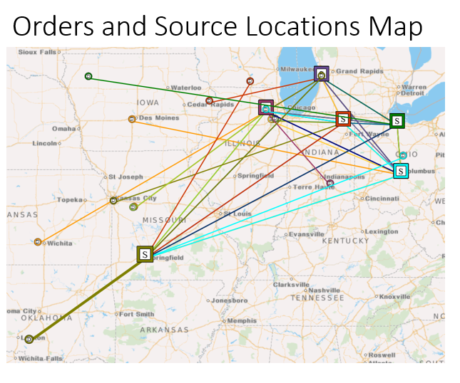

Orders for Example
Orders for Example

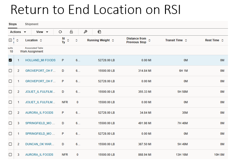

This scenario returns to the End Location, Aurora, because it is not end at a facility in the profile.  Likewise, it started at Holland because that facility was in the profile.  This option represents "current behavior".
Scenario 1
Scenario 1

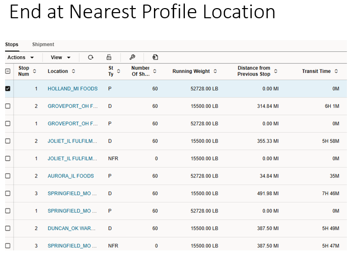

Scenario 2
Scenario 2

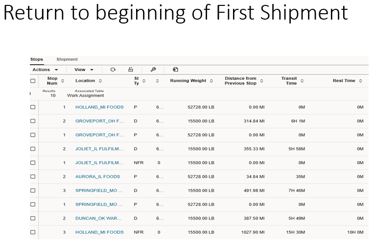

Scenario 3
Scenario 3

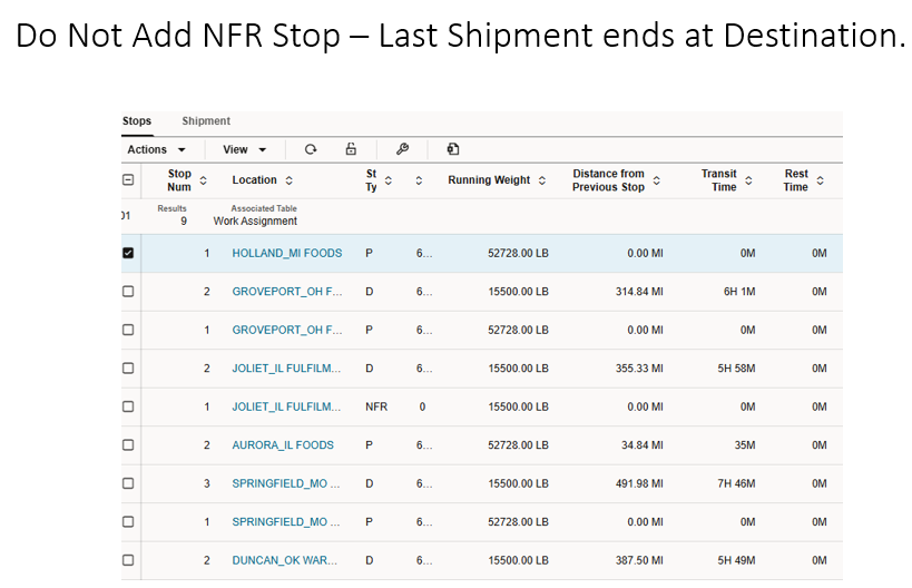

Scenario 4
Scenario 4
